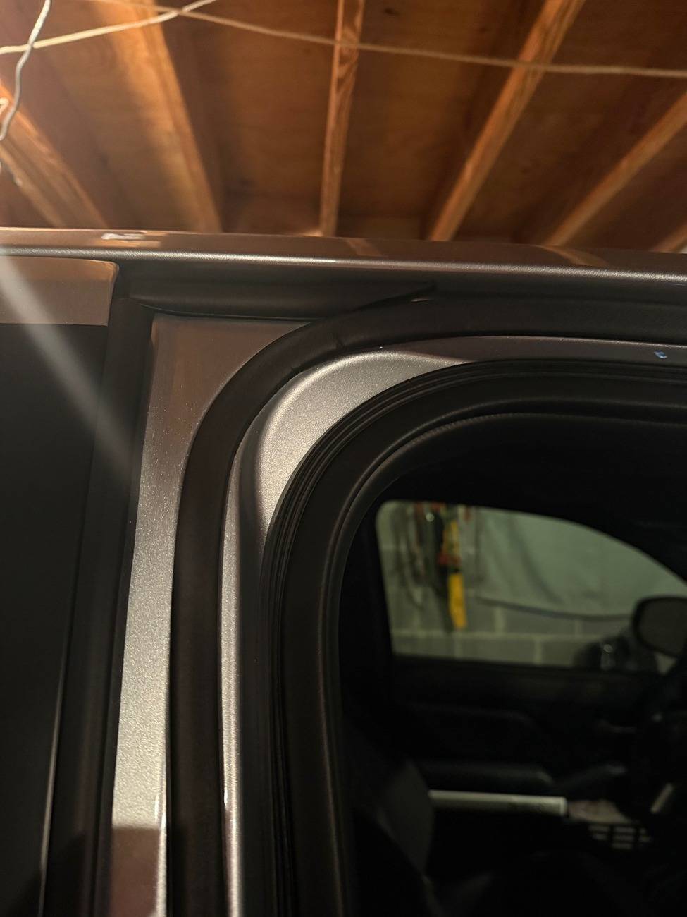

here's a picture of my rear window - TRD Offroad non premium, top back corner. Gaps at top on both sides. Seals fine as you move down the window. can others check for gaps? anyone with a Premium trim can check? Front doors are good.
asking as i've been chasing wind noise for a bit - the more it breaks in (3500 miles now) it gets worse. I've thrown all my old tricks at it and under 50mph its so much better, but HWY over 65 is annoying. many differences in trims - acoustic vs base glass, inner door seals, etc. just trying to see how much i can do with what i have.

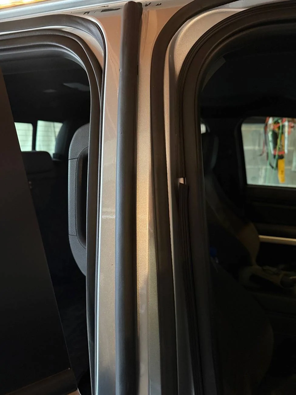

here's the inner doorseals i added - i used the Taco Marine D shaped. this is the same you'll see in other posts as it is very good. this inner seal follows the channel all the way around.
helps with road noise and also i've noticed a its keeping more dust out.

That's a great idea. Where did you get the Taco Marine seals? I'm also thinking about pulling up my carpet and putting dynomat underneath. At the very least along the Firewall to help keep down engine noise.

link the d shape seals plz
