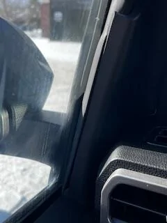

This is the issue. To confirm, when your window is open and making the noise, grab the top of the window with your hand and gently wiggle it back and forth (inside to outside/lateral). The interior rubber gasket by the A-pillar does not make full contact with the glass. The rattling sound is the truck hitting any slight bump and the window momentarily coming into contact with that gasket.
I've been toying with somehow expanding that gasket so it always makes contact - will likely do it in the spring since I don't anticipate having my windows open much during the winter.
Yup, this is exactly the issue.
There's just too much space on both the inside and outside between the window and the gasket all around. If you crack the window and then watch it when you drive, you can clearly see the window rattling around because there's no pressure on the glass and the glass doesn't contact the gasket on either side to keep it from rattling when you drive on anything but a completely smooth road.

Dealership just called me - car is ready for pick up but has parts on order to fix the window. Didn't tell me what yet but once I know you'll know.
DesertFast
Nov 16, 2024
75
DFW Texas
2024 Tacoma TRD OFF Road
They're replacing the window run. It's on backorder so they'll keep checking and call me once it is in, but that matches what I've read/people have said online.

It didn't fix it entirely, but it's a lot better. It will clearly get worse over time, and I have no idea why it's happening still, but there we go.
The window run did not fix the issue.

I have a window run on order as well after I took my truck in for a service yesterday. They'll replace the run next tuesday, but assuming that doesnt fix it, have you come up with a solution? Perhaps the added felt trick works?

That writeup KJC posted is the fix. My dealership just replaced the runner, but I assume it didnt correct it because they just added padding behind the rubber like in that post. Its all puffy now, but its not rattling.

same issue and i chalked it up to the temperlite glass vs the thinker acoustic - same channel and HW for both i'd guess so it leaves room to rattle.
