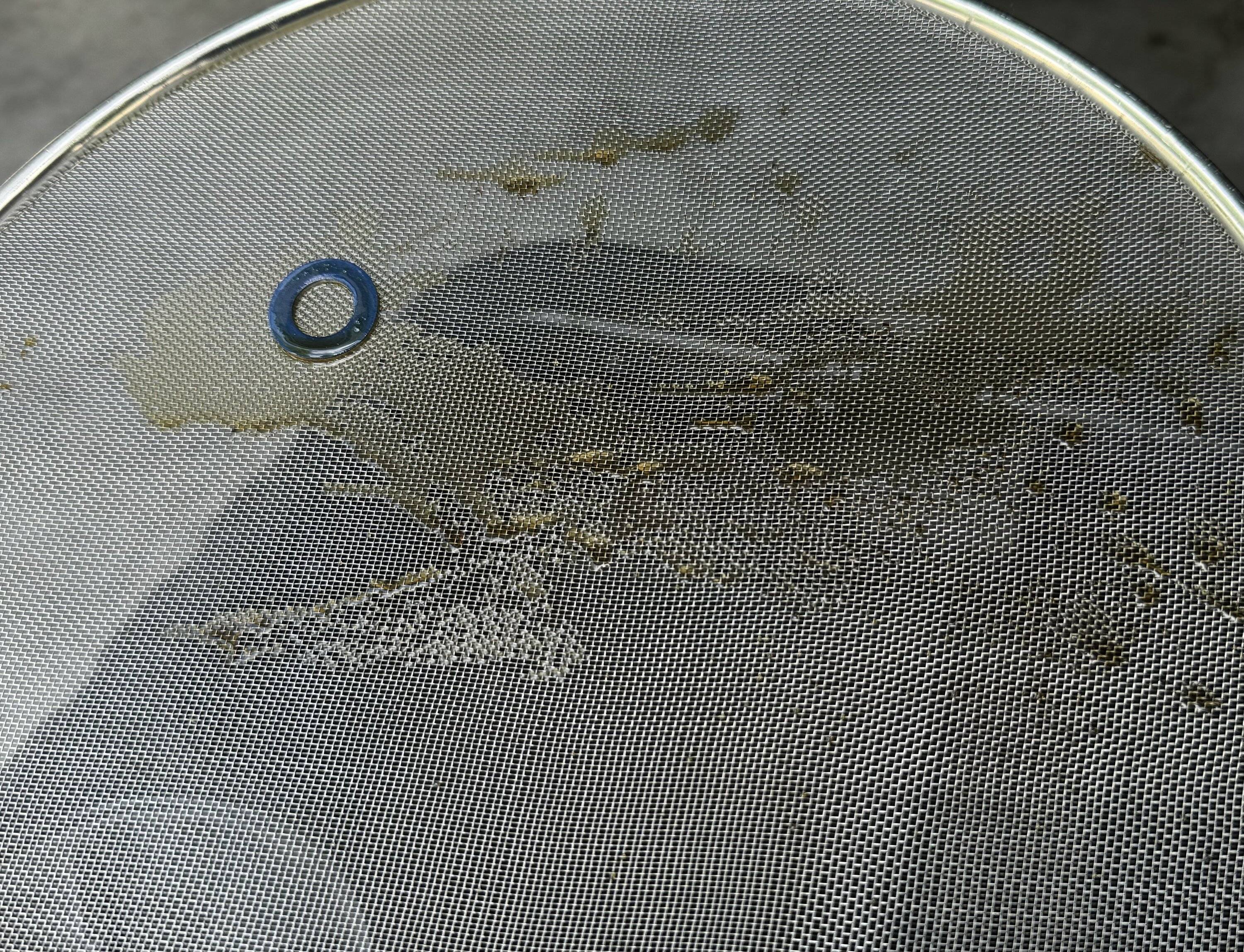

So did my first oil change on my ‘24 TRD Sport Premium. 1309km. (813 miles). Had it since April 10th and have done only short trips. Filter and drain plug very easy to remove. Little bit of cardboard helped keep the oil off the frame when filter was removed. Decided to drain oil through a frying pan splatter screen ( basically a sieve) No metal bits or shavings found. I was concerned after reading all the “oil change” posts and also because my Taco has an very early VIN. ( in the 3000’s) So far so good. No issues yet. Will probably do another oil change before truck visits dealer for first complimentary service in about October.

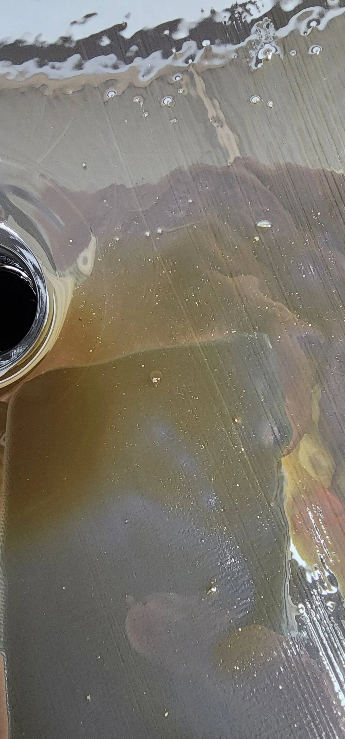

Just did my first oil change at 1068m. Looks like glitter. I guess it's totalled

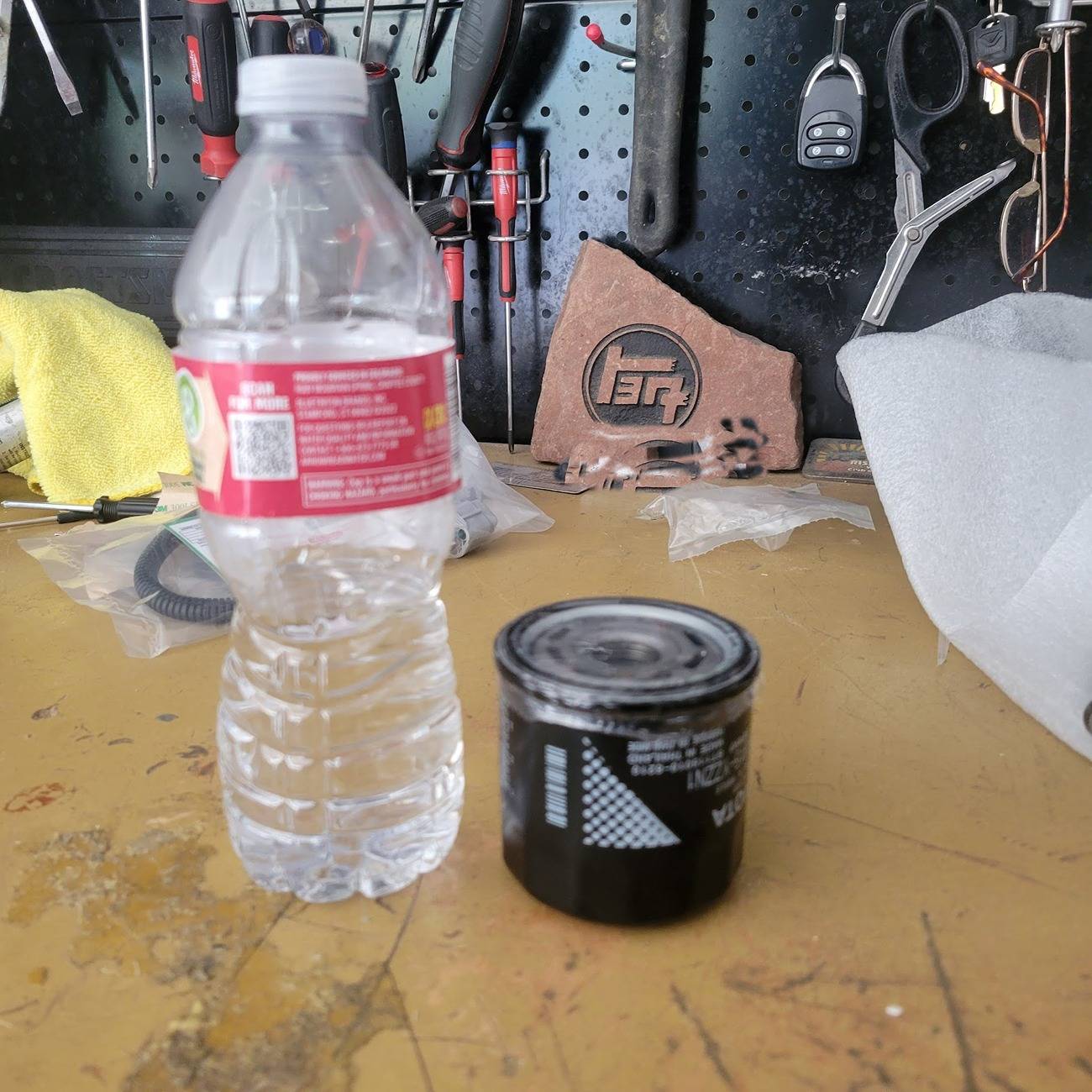

Did mine at just under 1000 miles. I didn't strain it, but didn't see any debris in the clear container I poured it in.
Seemed like the holes on the front OEM skid plate were not exactly lined up and it was a bitch getting back on. I had to push hard to move it a bit to get the last bolt.
These are very small oil filters. Same size as on my lawn tractor.
I also had to double check via Youtube I had the right drain bolt, very small oil pan. Likely normal for a 4 cyl. I have had V6 and V8s all my life :)
