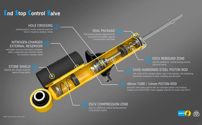

On the TRD OR models, the Bilstein shocks have what they call End Stop Control Valves (ESCV). The clunk you're hearing is probably the shock piston hitting the ESCV. I can hear it on speed bumps and different large hits.
thought this as well but it’s only on the one side. If that’s normal function I may have to replace the suspension with something else. I’ll let the dealer take a look whenever I get around to taking it in
