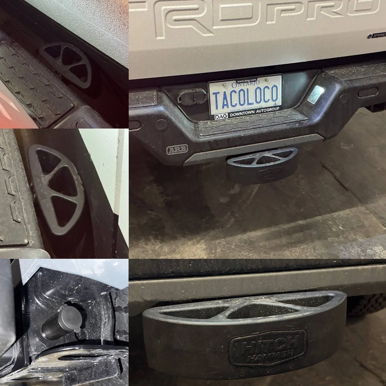

Hey folks,
Installed the HitchHammer Standard (vs XL).. the taco auto-brakes too far from the wall for my small parking spot and this engages on 2nd pass, stopping the truck at ~5" unless I gas it where it compresses a few more inches, typically decompressing in park.
EDIT: installed in its deepest of 3 positions (closest to hitch receiver). It can be brought outwards 1" or 2"
Also notable a 5/8x4" hitch receiver pin lock which has a tad under 1/4" of gap after install (eg: 3.5" will not work)
