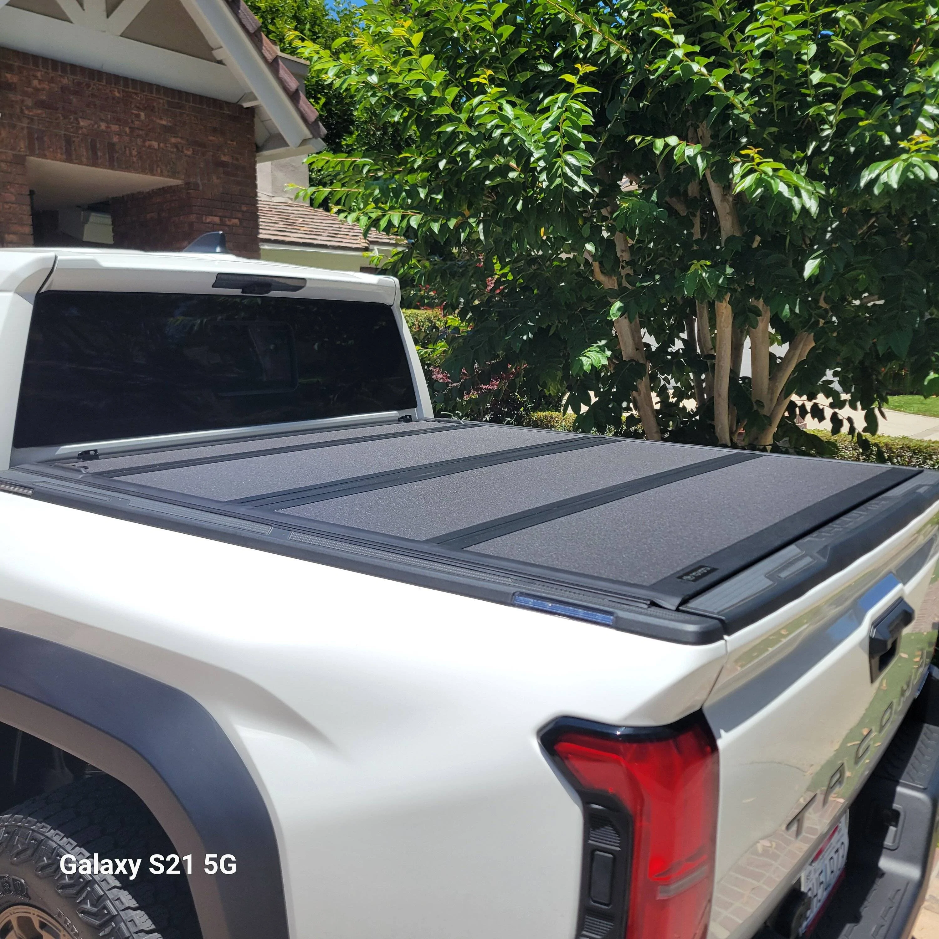

Happy my arb is gone. OEM tonneau cover is in. I go pick it up tomorrow and hope to get real installation instructions from the service department!?

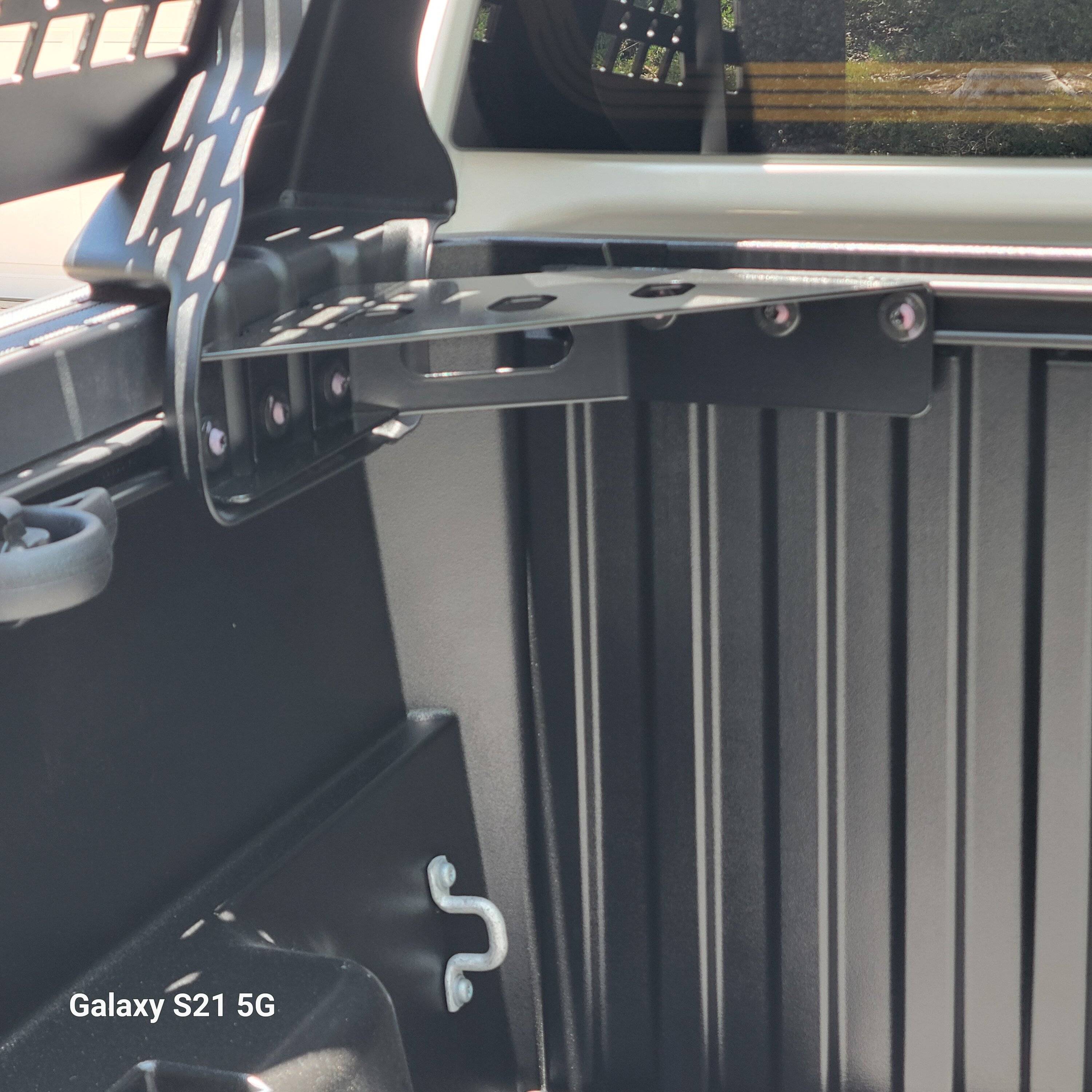

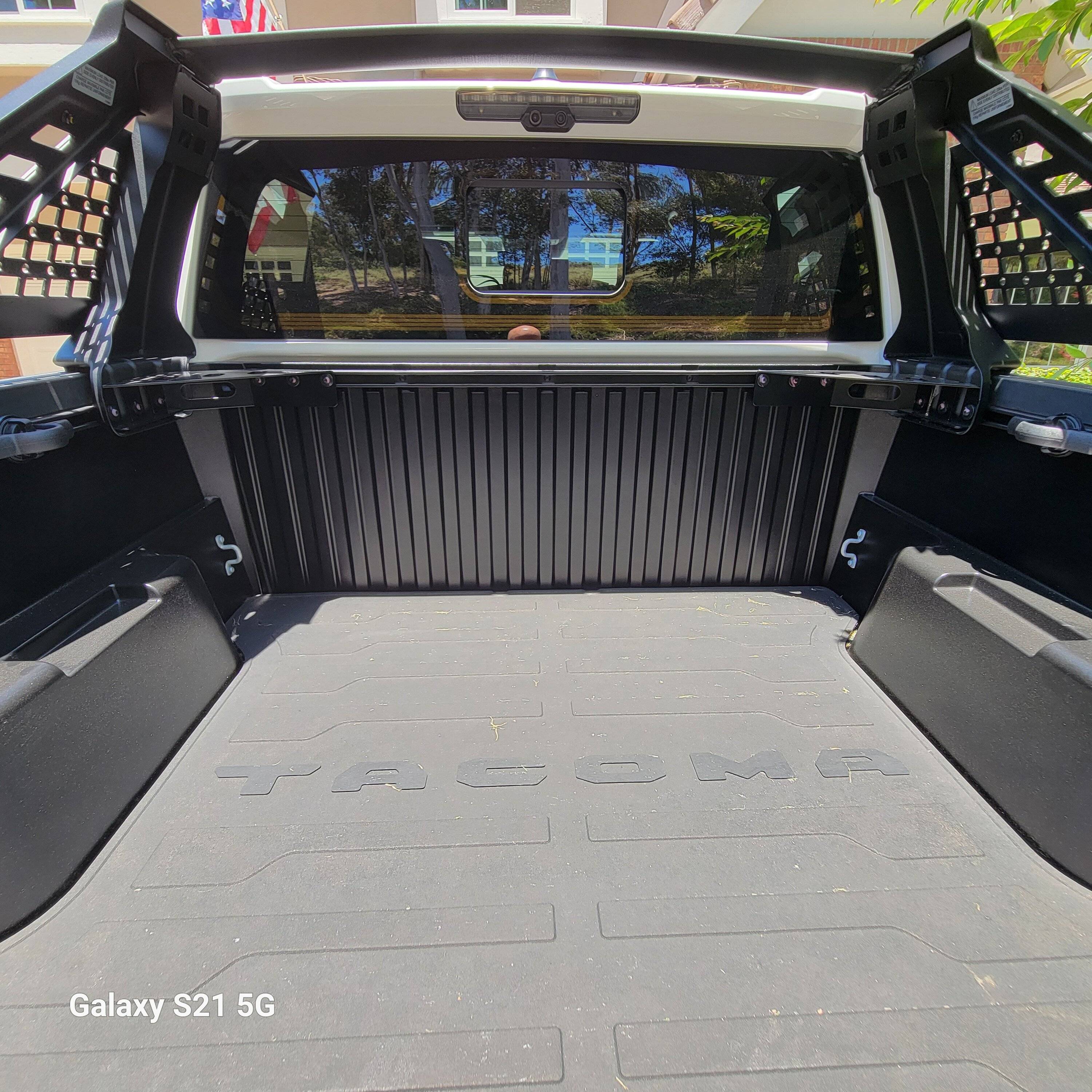

ARB bar was as easy as removing 18 bolts. Each set of 3 had a metal bar in the bed rail the bolts threaded into. Had to remove some of the torx bolts in the rails for the piece in the rail to slide out. T40 torx forcthe ARB bar and T30 torx forcthe bolts inside the rails.
I only have close ups right now. Pics of how the bar mounts.
2024 Tacoma Ice Cap White 2024 TRAILHUNTER Tacoma delivery! Proud new owner 🤩 20240621_124527
2024 Tacoma Ice Cap White 2024 TRAILHUNTER Tacoma delivery! Proud new owner 🤩 20240621_124542

Awesome, thanks. Yeah that looks super easy.

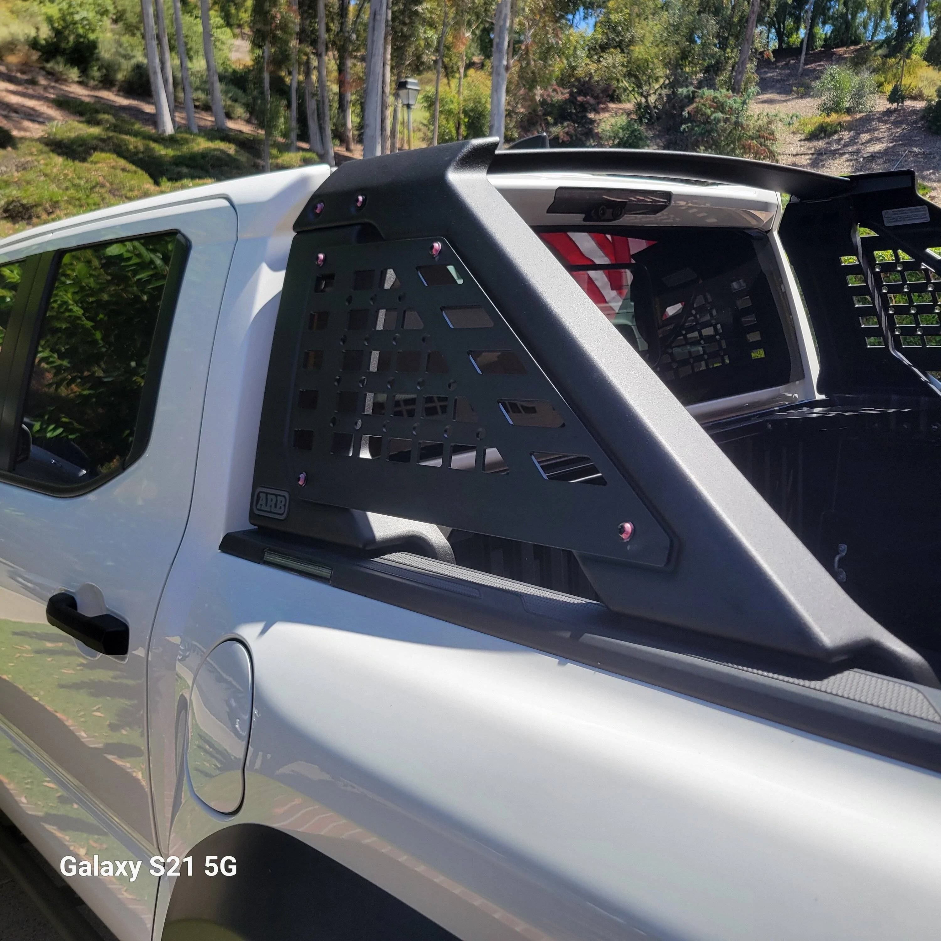

Proud new owner of the Trailhunter. One of the first as far as I gather from feedback. I want the OEM trifold to secure my camping gear. The Trailhunter comes standard with the ARB sport bar. It secures to the factory side and front rails with 12 bolts. Everything I see and read tells me that the bar will need to come off to install this tonneau cover. Can you confirm my thoughts? While I like the looks of the ARB bar (wife hates it), I don't mind losing it for the cover.
Gratuitous picture when I picked it up.
