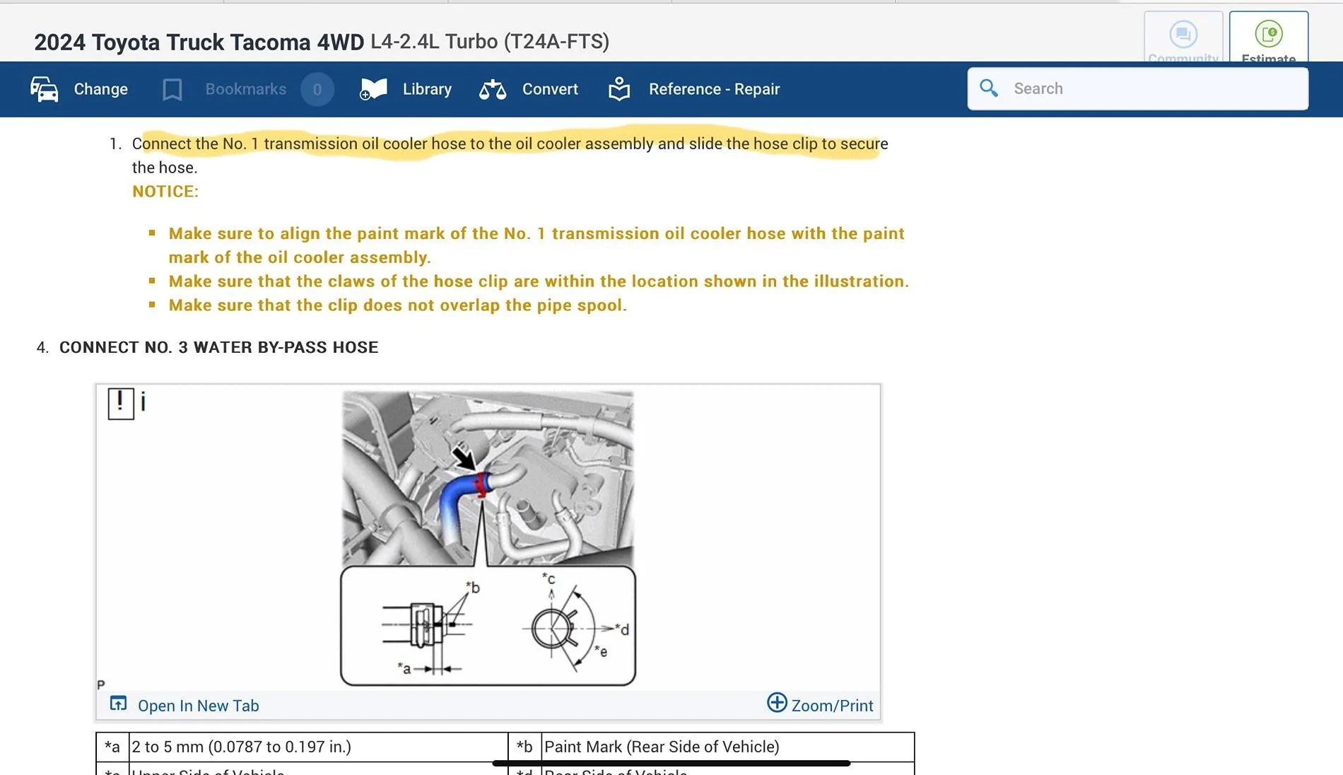

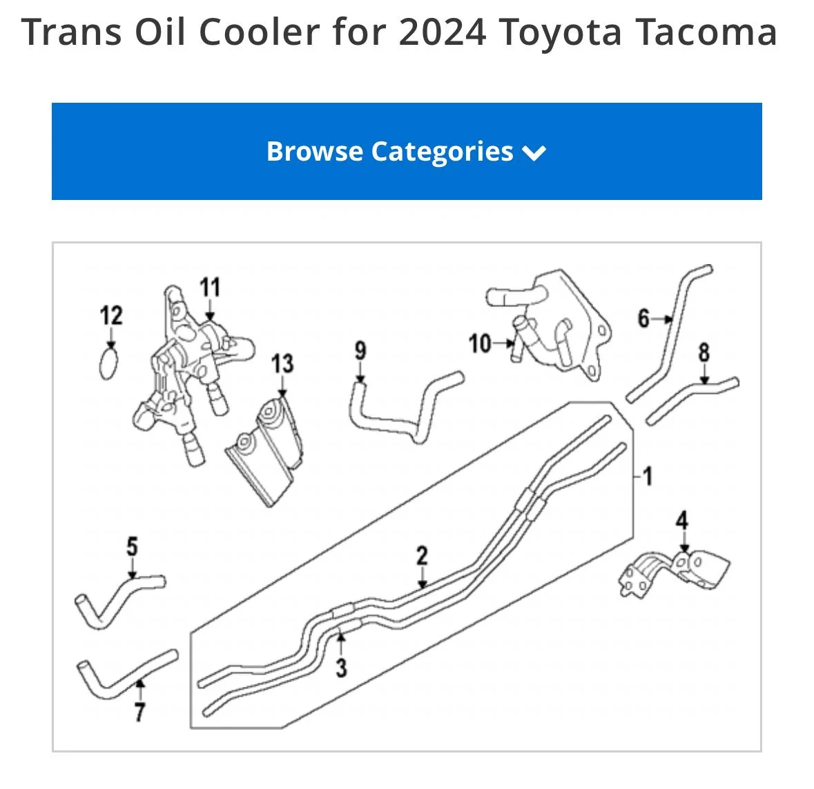

Is there a transmission line to plug that into? I don't recall seeing anything coming off the tranny.
Sner
348
371
Looks like it just hooked up to a cooler line.

Pretty sure it does. It’s in the radiator I believe?
I've been Googling and am still not sure. It may have a transmission heater to get it up to temp faster.
