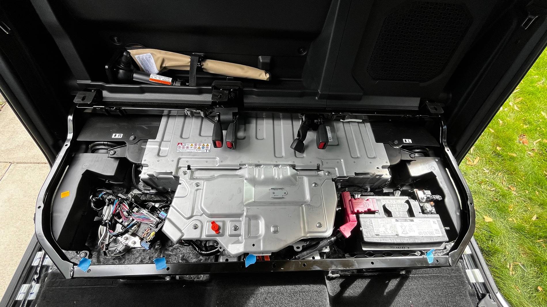

bcuz if your NiMH shits the bed you can still drive it like a regular iForce taco.
Clutch for dudes like Independence Overland who intend to submerge their THs in deep crossings. Nothing's hermetically sealed, there's no water jacket on any of the hybrid system. Redundancy is OK, I sure as hell paid for it.
2024 Tacoma My i-Force Max has an.... Alternator??? IMG_6503
