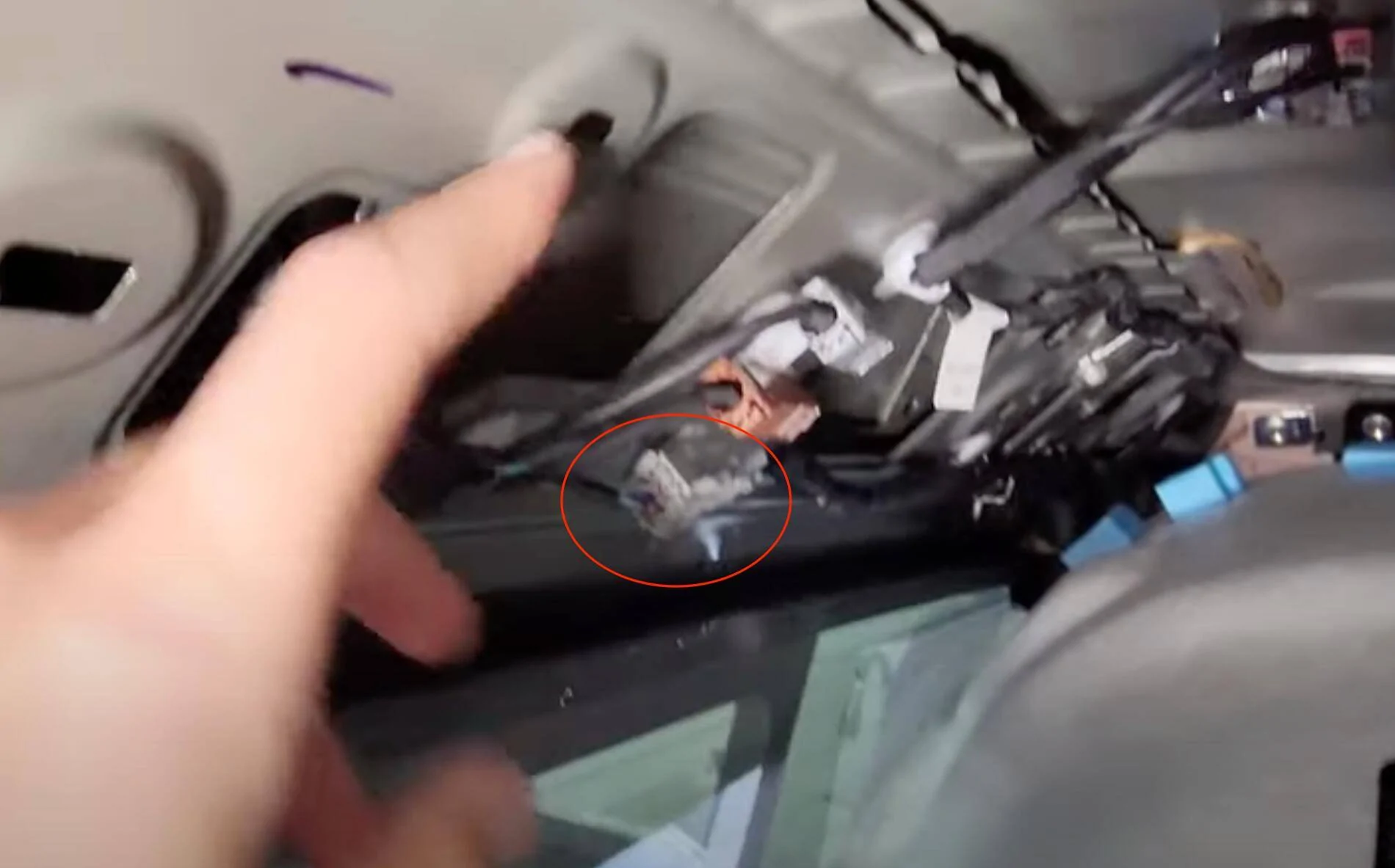

question for you about your 3rd brake light on your Lone Peak: how did they tie-in on your TH's brake light on the rear?
I did GG Offroad’s camera relocation kit and know exactly where the OE brake light connection is located but just curious if the guys at lone peak tapped in an easier location?
