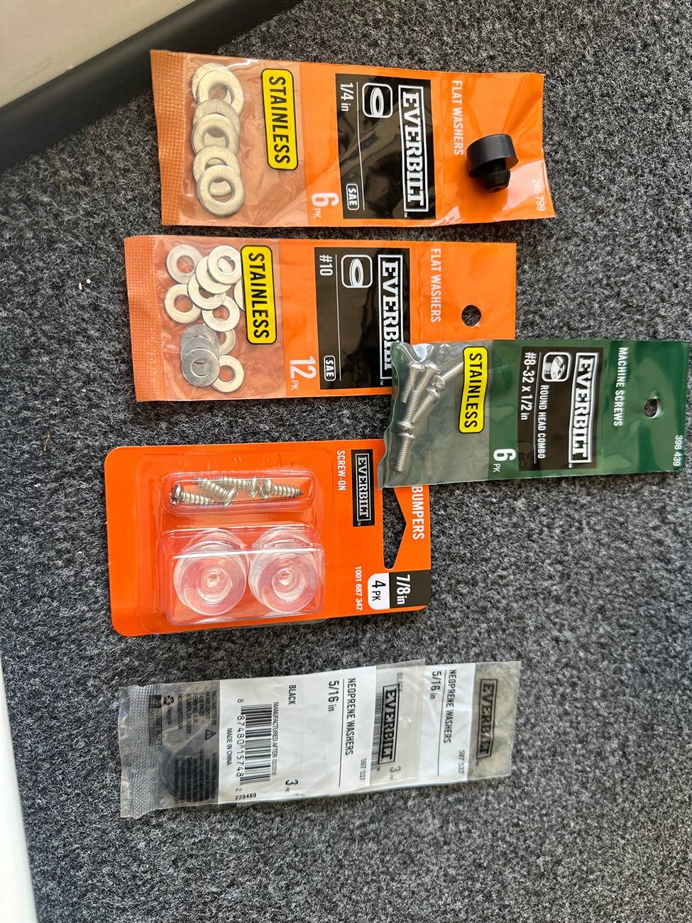

I’m not sure about the insulation fix, but I’ve tried multiple things. Bushings, washers, foam, furniture stoppers etc. They all worked but had a flaw or downside. Foam gets wet, bumpers stop vibrating completely but create a wider gap which makes the rack crazy loud. Only “fix” I have found is wrapping paracord around the faring and brace between each “Toyota” letter. It is quiet and doesn’t shake even a little. But still isn’t a fix. Just a bandaid until I can get the dealer to help me figure out a permanent solution.

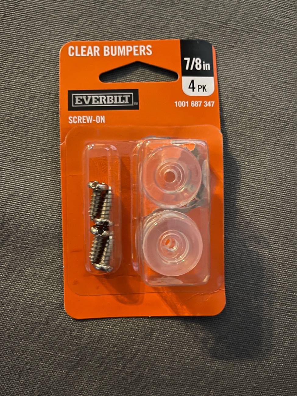

My dealership would not work with me and refused to do anything without seeing the truck. And at the time the rack was not on the truck. I wasn’t about to put the rack back on the truck, drive it to the dealership, drop it off, let them keep it to diagnose that indeed it does have the issue, call me and tell me they didn’t have the parts, have me pick the truck back up, wait for the parts, then drop it off again, them finally fix it, then have to pick it up again. That would have taken weeks and hours of my time. And I did confirm that all that would have had to have been done at the dealership closest to me. They will not be seeing the truck ever unless there is some large warranty issue, not even for covered oil changes.
It was a far better option to just spend about 5 min finding some bumpers on Amazon that worked and take 20 min to install them myself and put the rack back on.

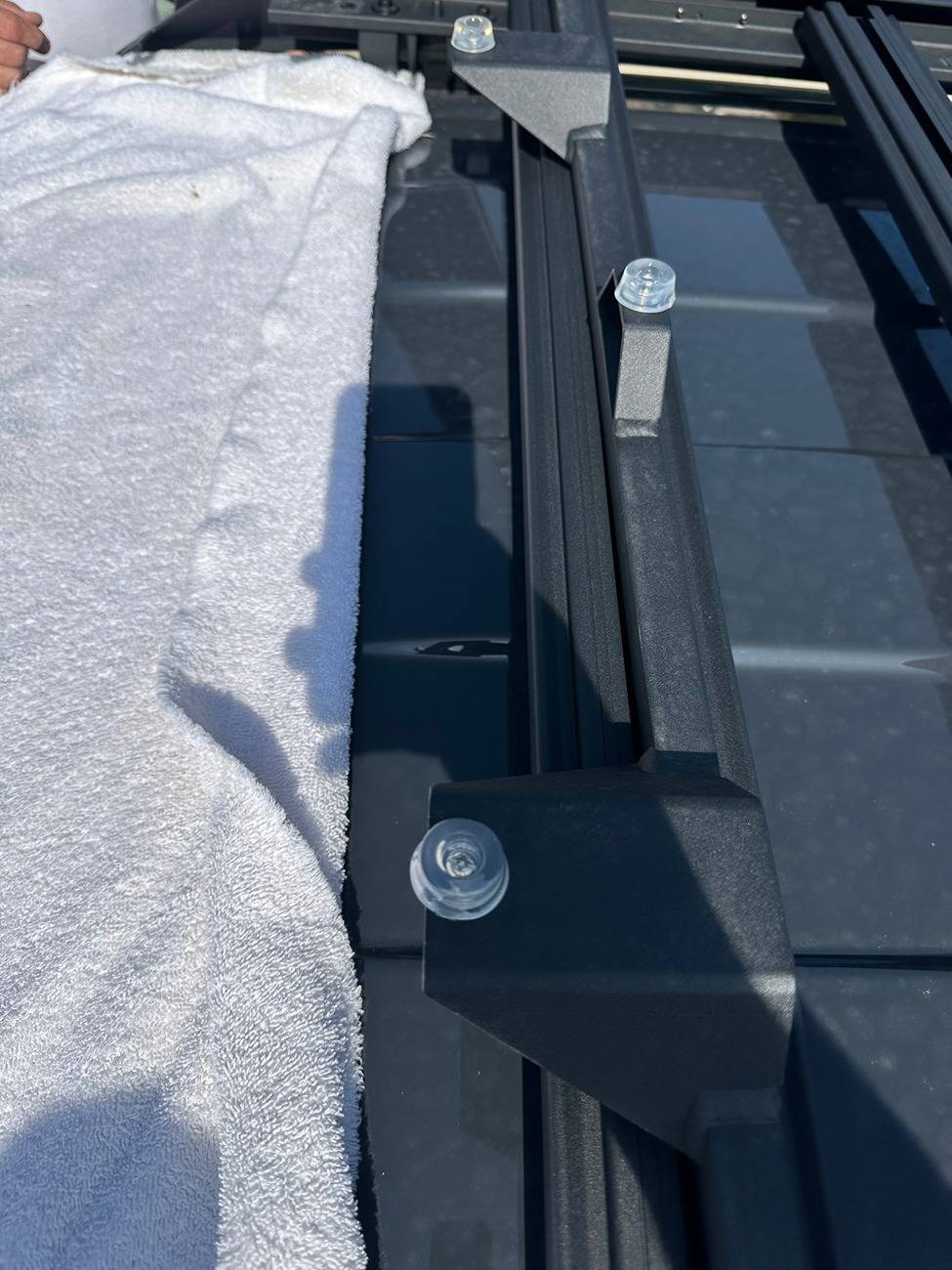

Take your truck to the dealer, they have a solution: they add 3 rubber bumpers, attached is what the bumpers look like and the service bulletin (TSB). It is #T-SB-0016-25. They take the roof rack somewhat apart to add the bumpers. They will have to drive the truck before and after. My dealer did mine last Friday during my 5K service. I was in and out in 92 minutes.
2024 Tacoma OEM Roof Rack Vibration Issue Screenshot 2025-03-19 at 6.37.30 PM
2024 Tacoma OEM Roof Rack Vibration Issue Screenshot 2025-03-19 at 6.30.30 PM
