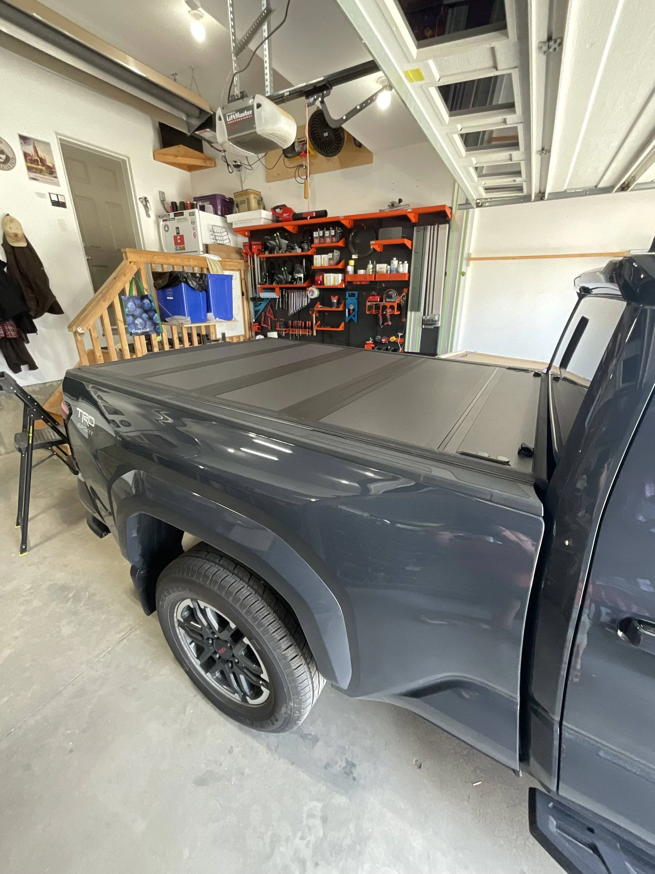

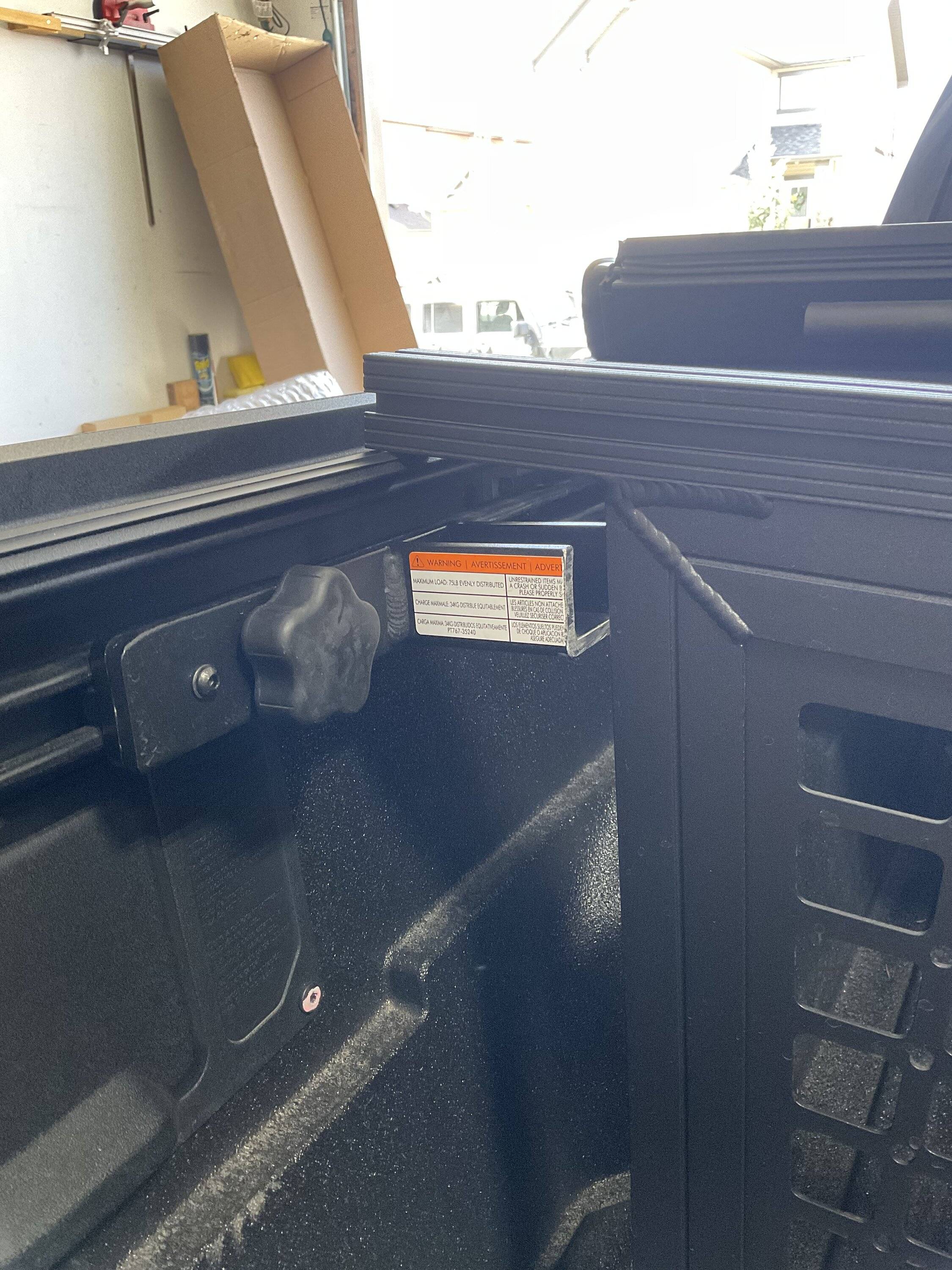

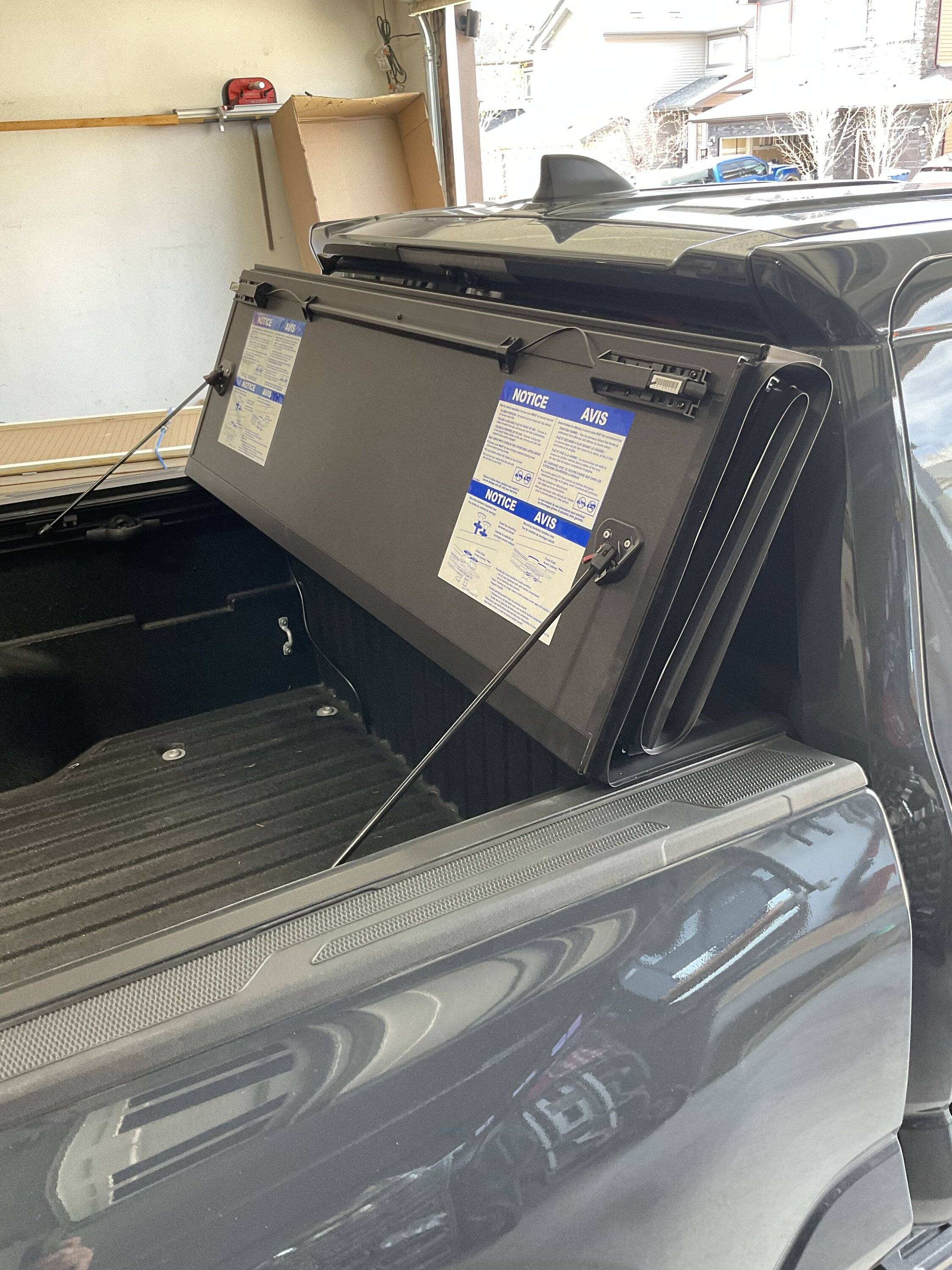

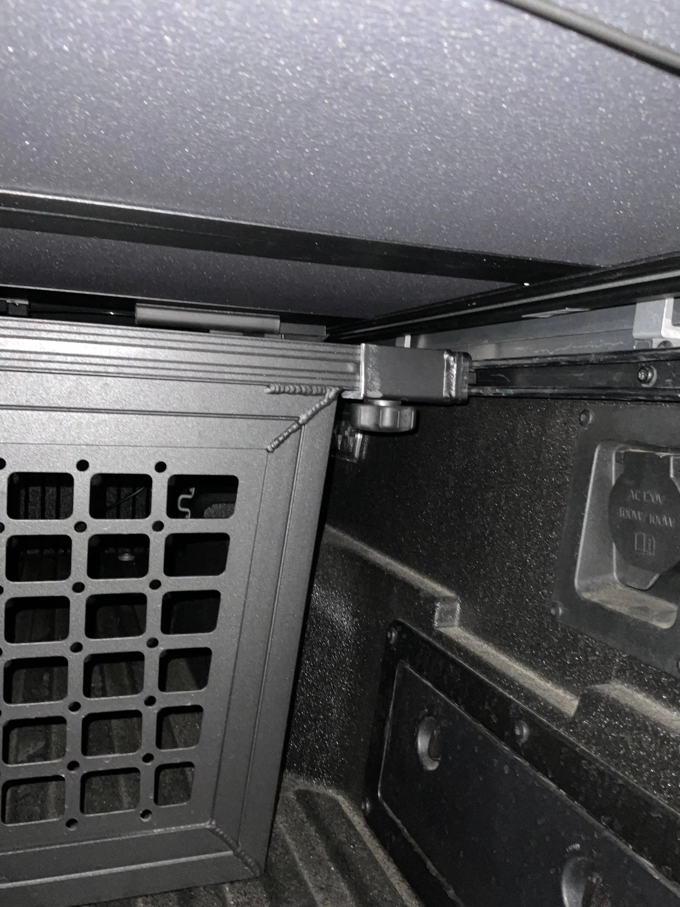

Tonneau fit great. Easy to install. Bed divider was too wide and needed modifications. Cut 3/4” off both ends of the divider and both rail brackets. Fits perfect. Put the attachment screw on the bottom side of the divider to give more room between the divider and tonneau. Very happy with them both.
