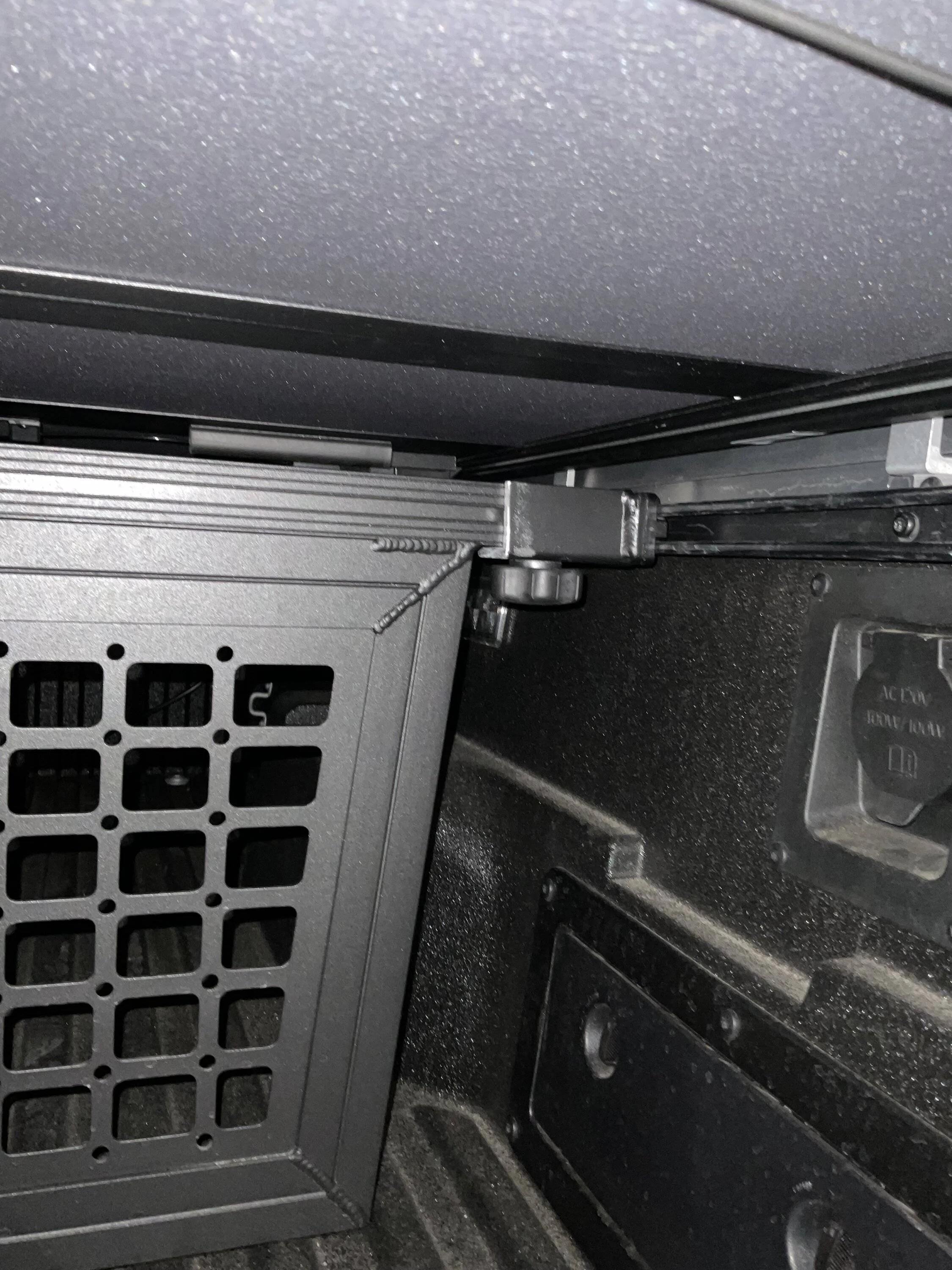

Tonneau fit great. Easy to install. Bed divider was too wide and needed modifications. Cut 3/4” off both ends of the divider and both rail brackets. Fits perfect. Put the attachment screw on the bottom side of the divider to give more room between the divider and tonneau. Very happy with them both.

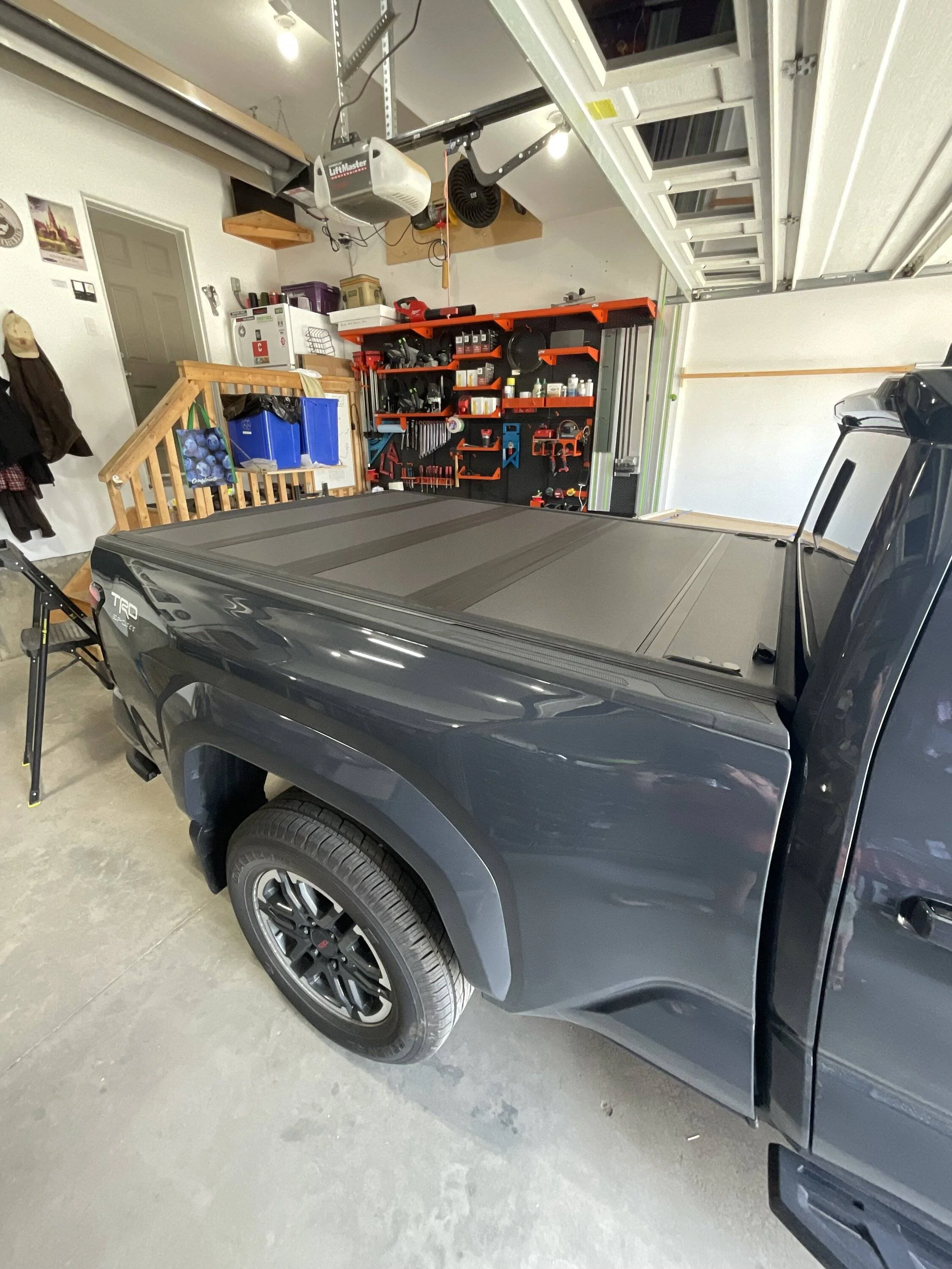

Just installed the OEM Tonneau cover and am super happy with it. Install was pretty straight forward and didn't take too long. When I originally called the dealership and asked if they had any lead time on the 2024 Tacoma Tonneau cover, they said they didn't know when they'd get them. I called back and just asked if I could order part #PT954-35240, they said they had them in stock and it'd be ready the next day. Price was $1195.00.
Also, in case anyone was wondering... the Tonneau cover while fully open does still block the rear view camera even though it looks like it doesn't from the pictures.
I was wondering if it would have to be modified since the bed rails moved in and down with the OEM Tonneau. Looks like you verified it. Thanks for doing that.
Also looks like there’s no way a bed mat would fit under it when you’re done. I have the 6’ bed coming and was thinking of getting a 5’ bed mat and using the cargo divider as a “tool box”. Thinking that still might work. Or just cutting the 6’ mat.

took a measure and have about 3/4” space between the bed and the divider. You could shim up the divider if you needed and extra 1/4” or so as there is room on top between the divider and tonneau cover
