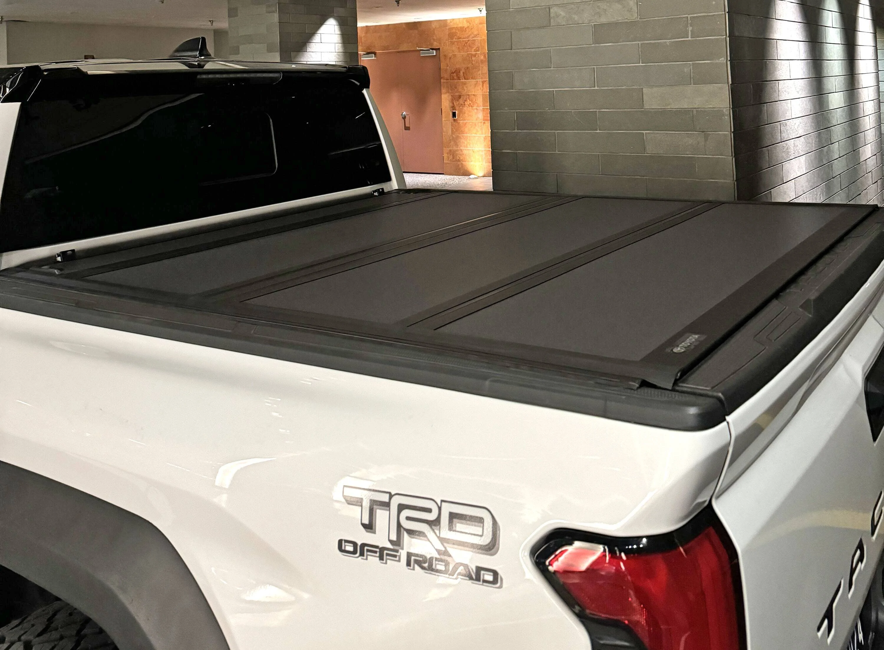

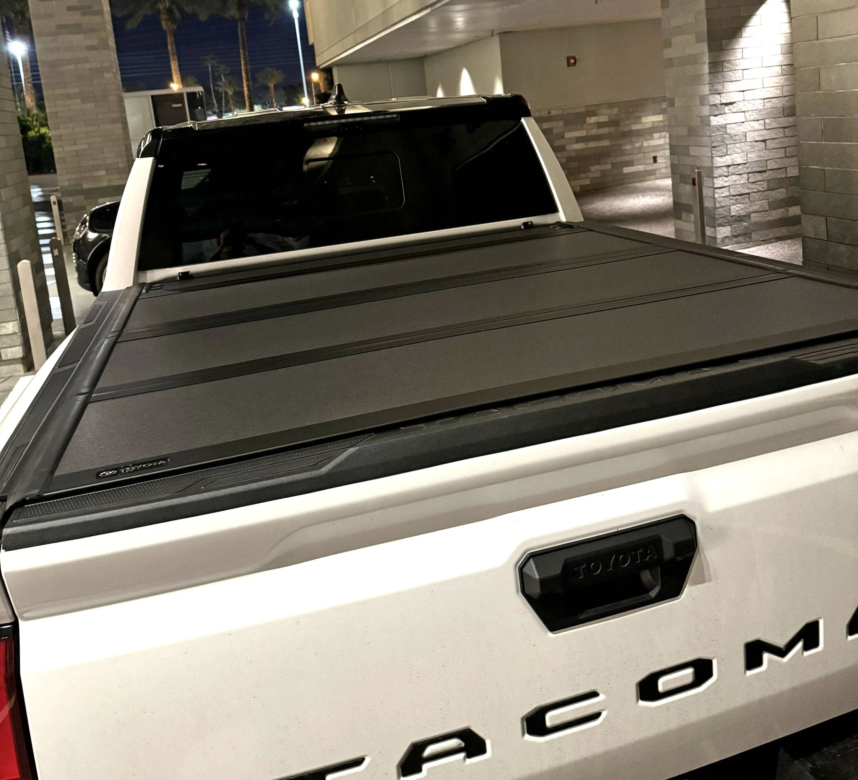

Hey guys just wanted to let everyone know that the OEM Trifold Hard Tonneau Cover PT954-35240 fits nicely on the 2024 Tacoma.
If your dealer says it’s not on the catalog and they’re not sure if it will fit on the 2024, I’m here to let you guys know it does. Same thing happened to me and the parts guy didn’t want to order it for me at first but I assured him that I would take full responsibility if it didn’t fit which I knew it would because of the post that was made here with the Hawaii region getting them in and installing them.
After I placed the order, I got it the next day as they had it in stock in the next state over. As of now they don’t have the instruction manual but it’s pretty straight forward and I used the 2022+ Tundra installation instructions for reference. It’s very similar to the Bakflip MX4 and wouldn’t be surprised if it’s the same cover with Toyota branding. Hope this helps anyone!

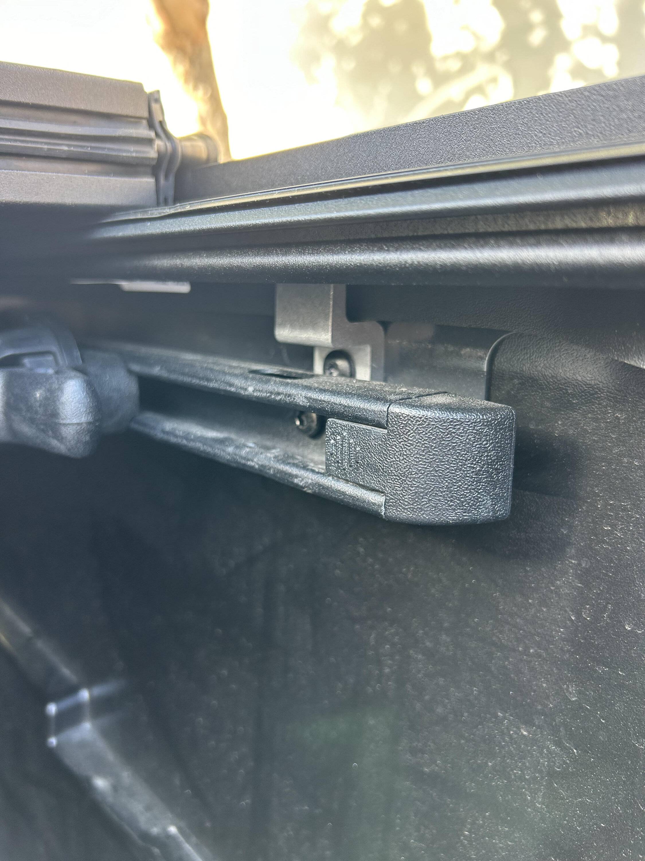

Some pics would be helpful. I saw your other post (Congrats!) but I am unfamiliar with the sport bar. I have the long bed factory folding bed cover. The side bed rails need to be moved down about 1" and are secured by brackets, which mount to the original rail holes. The front rail has to be repositioned too but just for clearance. Not knowing how the sport bar mounts, I am assuming this is a deal breaker.

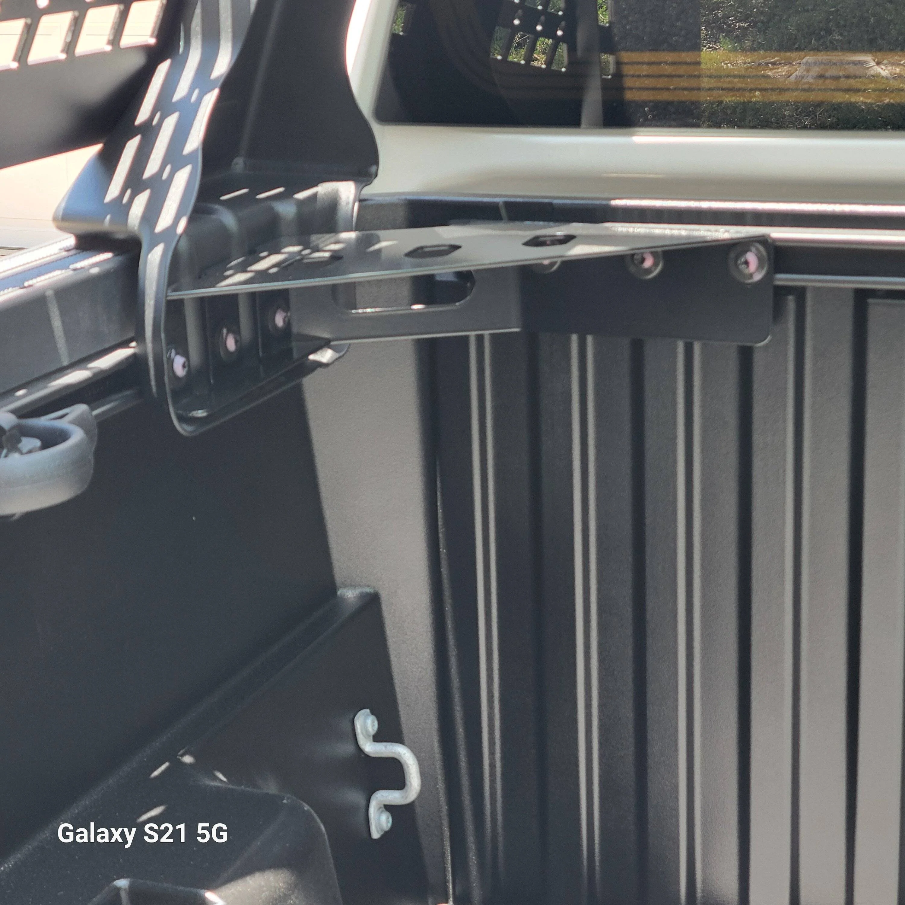

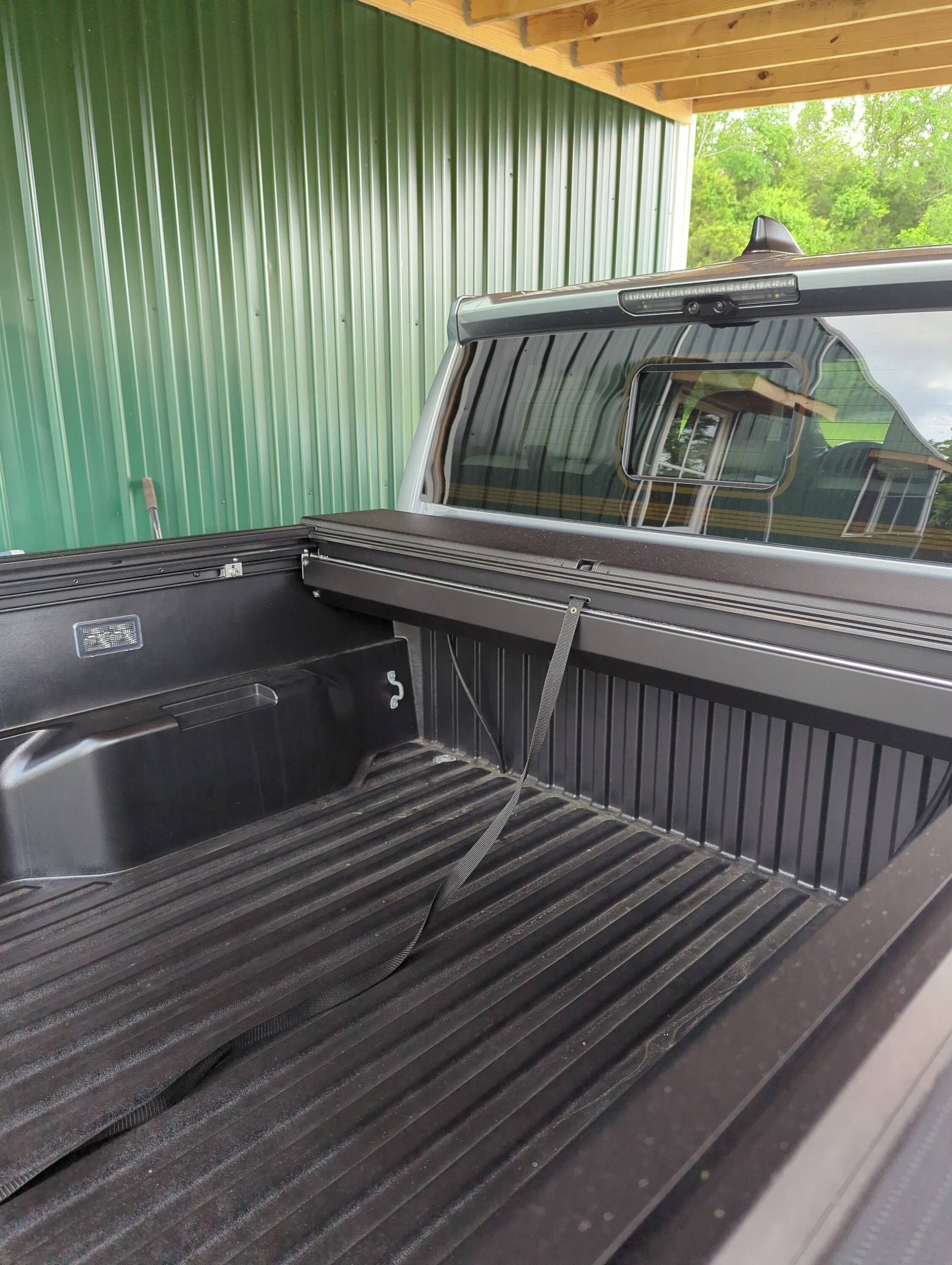

Ok, pics of how the Trailhunter ARB bar bolts into the factory rails. I'm inclined to just remove the bar in favor of the oem tonneau cover. The one thing, and only thing I think Toyota overlooked for offroaders was secure storage for camping gear. Anything now available means removal of the ARB bar.
