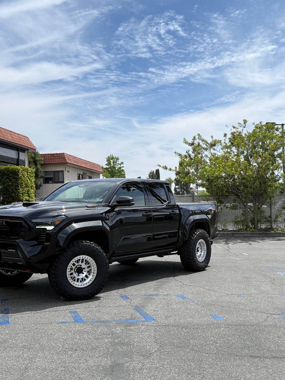

You will have to trim right at the bottom of your fender where the mud flap clips are. If you don’t it will cause you’re fenders to push up and you’re body lines will move. The more weight the more trimming. I didn’t have to trim more than a tiny strip since I’m always driving alone and hardly do any woop jumping at the dunes, I do have m/t tires but they are not that wide 35s 20x9.

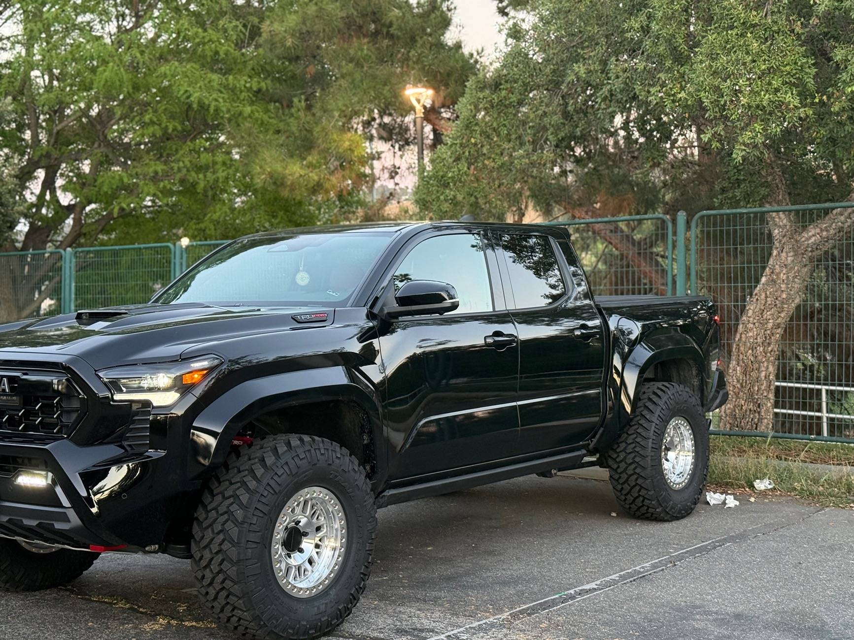

My truck had 35x11.50 Nitto M/Ts on the same Westcott lift and +25mm offset wheels when I bought it. The mudflaps were removed and the front crash plates, otherwise it was stock. Nothing had been trimmed or cut and it didn’t rub at all.
