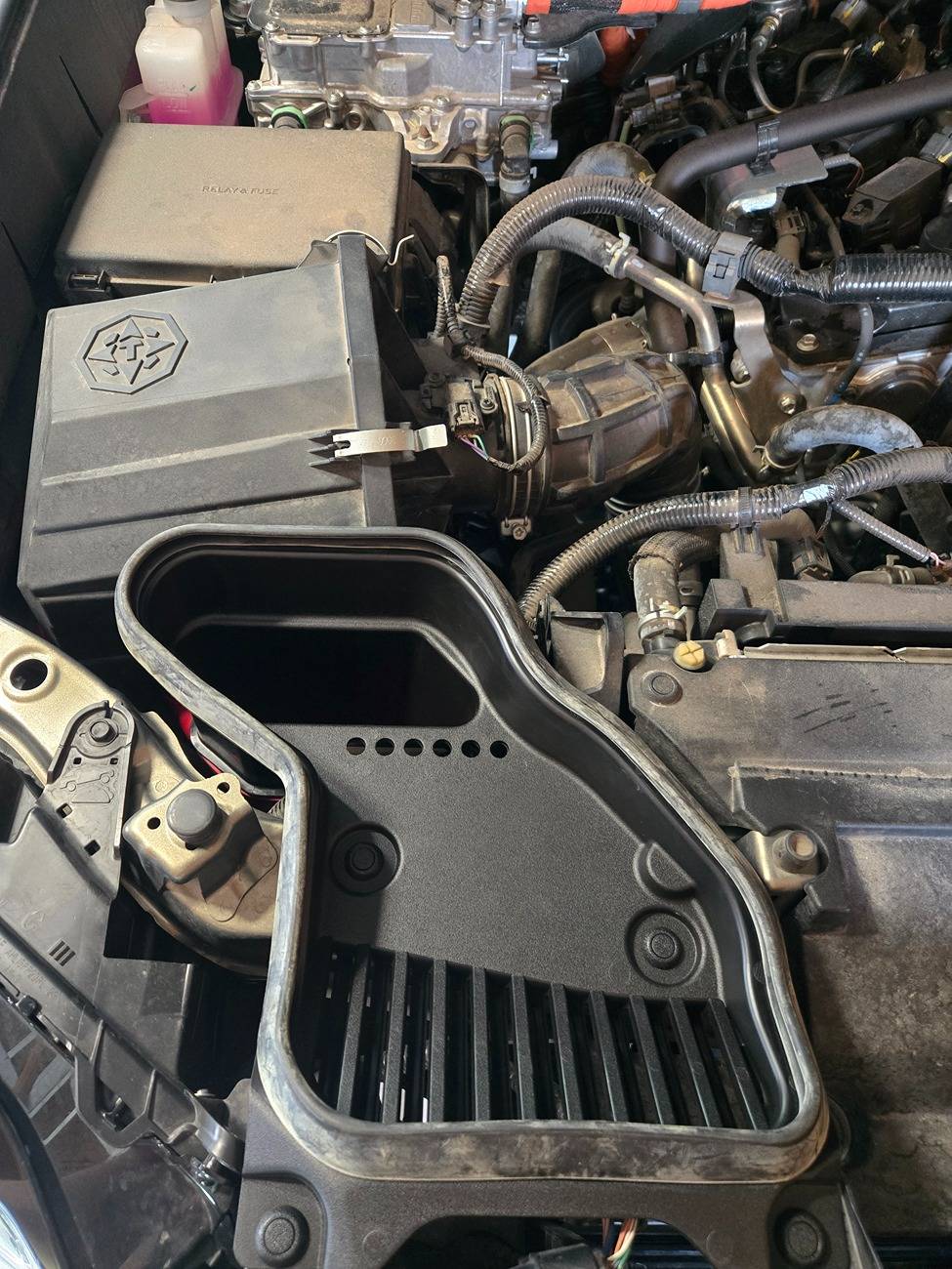

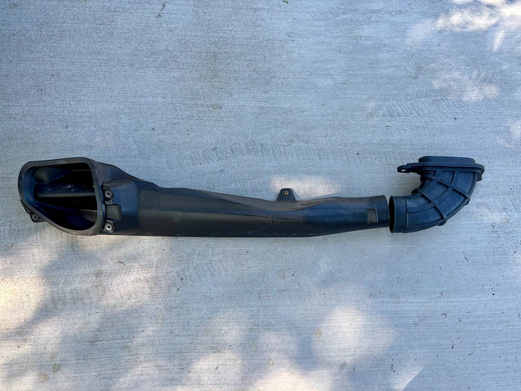

If you are like me and looking to get rid of the high desert air-intake (snorkel) because of how annoyingly loud it is with windows down, I figured it out. I spend too much time in the mountains or out on desert roads with the windows down and the intake noise made my wife and I roll the windows up. Not anymore!
You need 2 parts and 4 clips to convert the Trailhunter airbox to route like the TRD Pro airbox:
PTR03-35241-AE - Taco Coupling Kit (This is the red elbow for the front intake basket and the red cap that will cap the port being used by the high-desert intake)
17752-AK010 - Inlet, Air Cleaner (this is the inlet basket that hooks up to the red elbow and clip in above the front radiator support)
90467-07217 - clips (4 needed to clip in the inlet)
The work is pretty straightforward/intuitive and should not need any instructions. I think their are some YouTube videos out there from other aftermarket intakes that would show you removal. The only 2 bolts are the 10mm bolts holding the rubber elbow that connect to the high-desert intake in the fender.
I cannot say enough about how happy I am with this mod and being able to keep everything factory. Windows down is enjoyable again! I also did not realize how much of the intake noise you actually do hear with the windows up. Just got used to that over the 20K miles, but now it is weird for it to be gone.

Thanks Dr Tron, I just pulled the middle RAI piece between the rubber elbow and upper RAI (that attaches to the A-pillar). I was hoping that it would quite the airbox noise but not so much (way better than stock though). I was just thinking that I wish I had a TRD pro sitting next to my TH so I could see if the parts would swap.
Do you have a before/after pic of the airbox mod?
Thanks agin Dr Tron for chasing this mod down. Now we just need someone to 3D print a cover for the fender and I'll take off the snorkel piece.

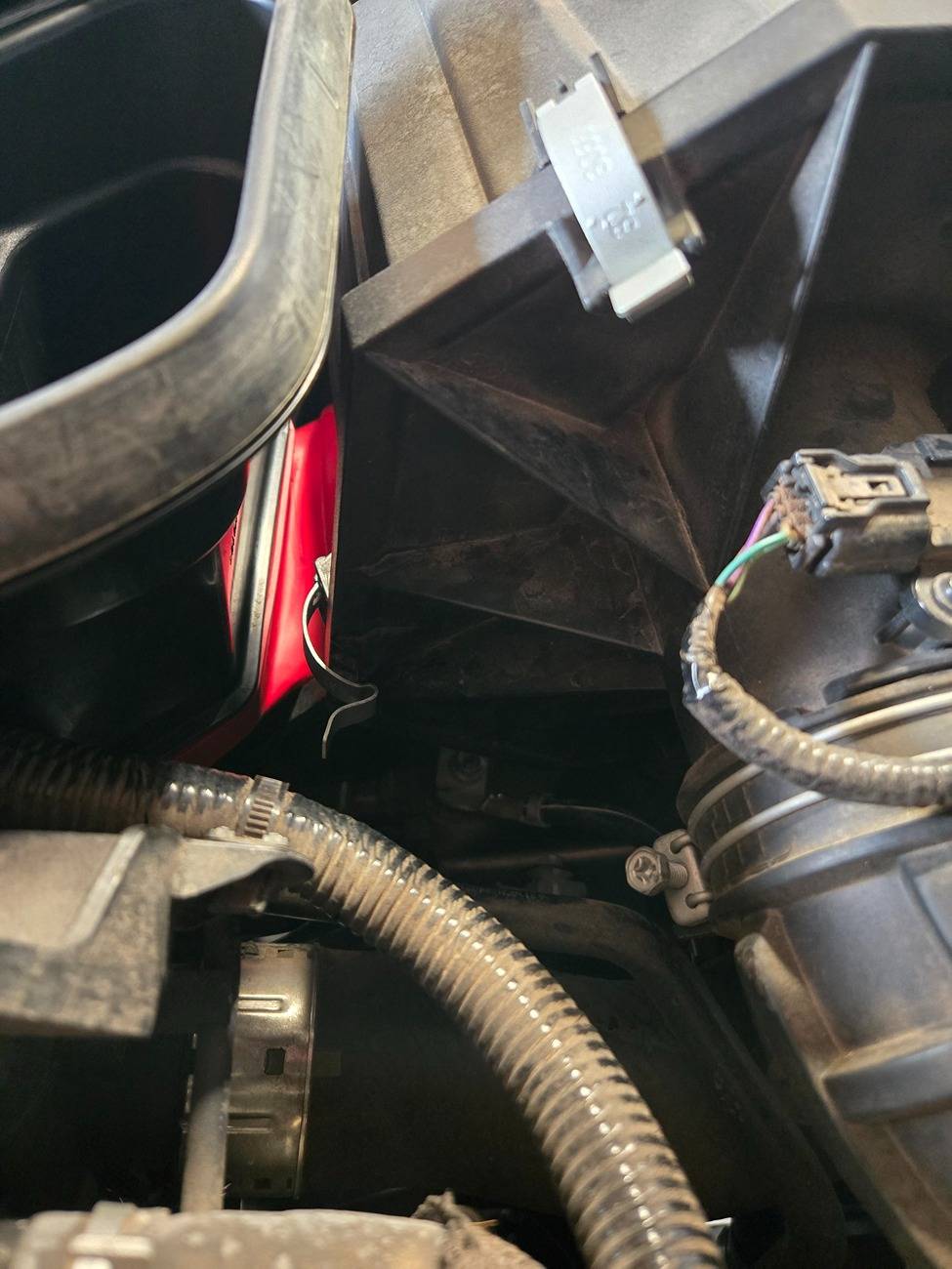

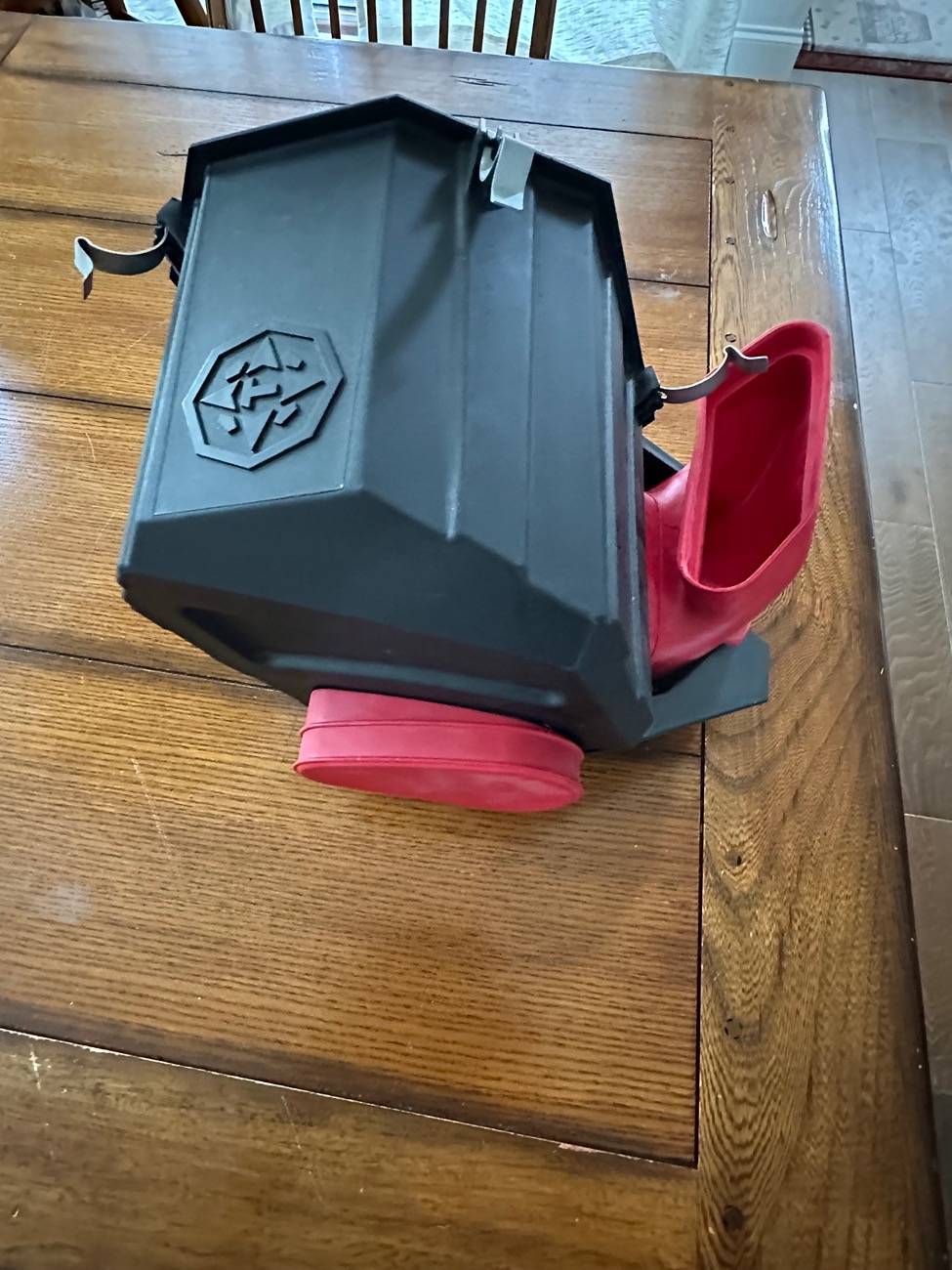

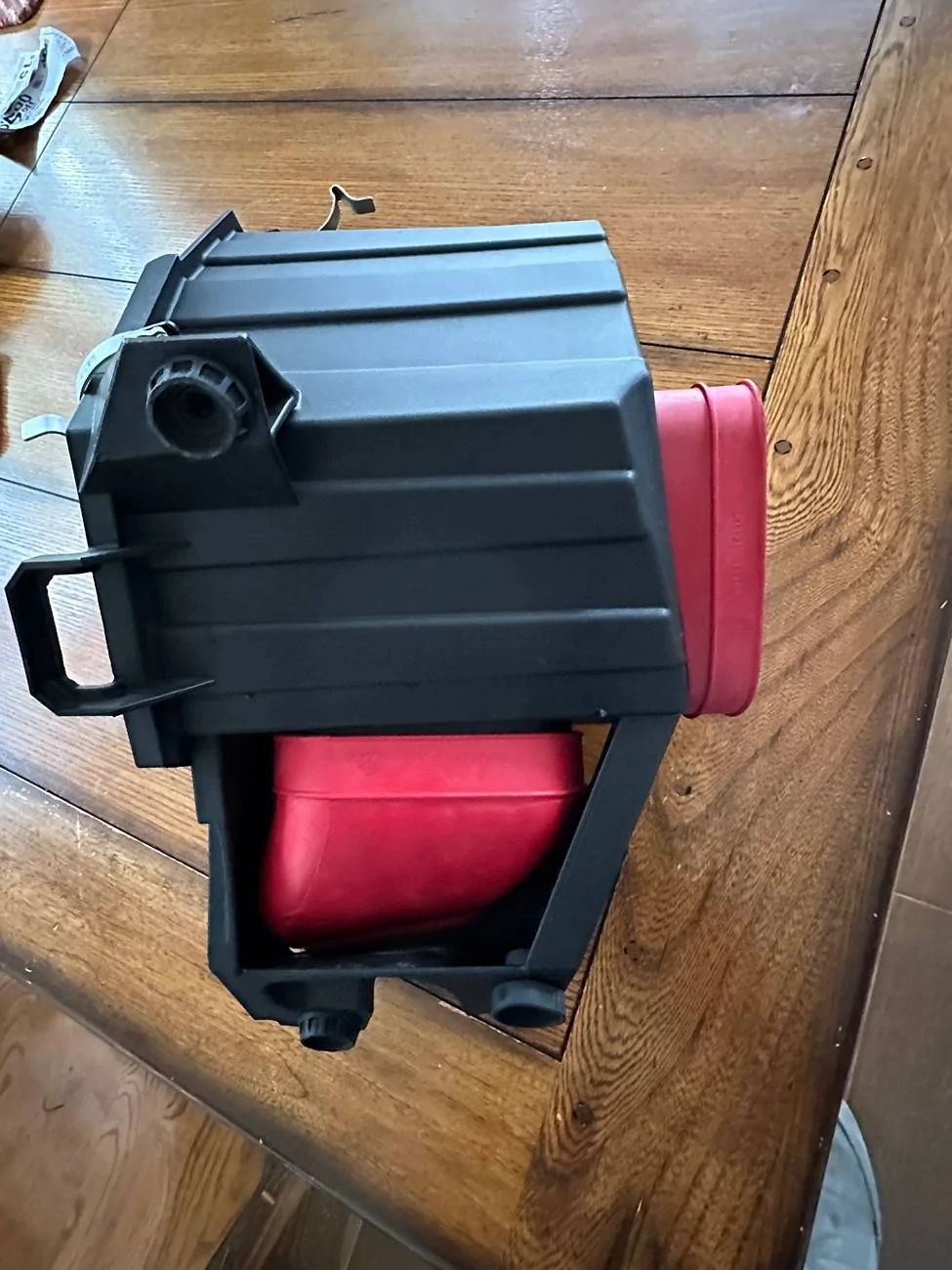

I did not take any broad before pictures. I asked another member, @SnowmanJPS, on another thread if they could send pictures of their TRD Pro airbox so i could figure it out. Those pictures can be seen in the thread below along with a picture of the inside of the Trailhunter air box:
https://www.tacoma4g.com/forum/threads/trd-pro-trailhunter-engine-airfilter.8848/post-164177

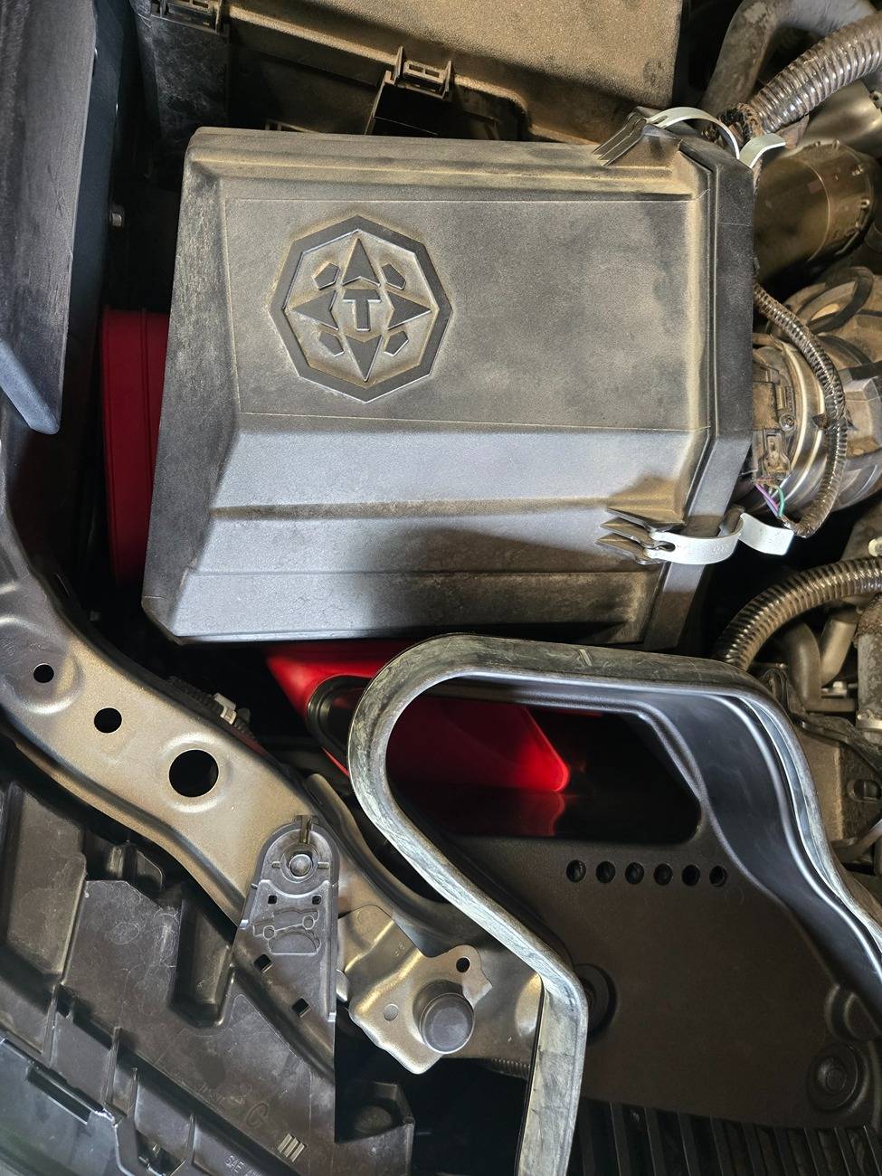

I took some after pictures just now as well. I only took out the rubber elbow and left the rest of the high intake in the fender and on the A pillar. There's a red cap that is part of the coupling kit that caps the port for the snorkel on the air box. You then remove the bigger black cap at the lower front of the airbox and use the other angled coupling piece to join up to the new intake basket and clip it in place.
2024 Tacoma Quieting the RAI (Snorkel) Sound 20250623_155232
2024 Tacoma Quieting the RAI (Snorkel) Sound 20250623_155217
2024 Tacoma Quieting the RAI (Snorkel) Sound 20250623_155207
2024 Tacoma Quieting the RAI (Snorkel) Sound 20250623_155154

Would be nice to keep it factory, and good to know this exists. I am getting a Stillen intake installed this nexxt week to cut out the high air intake. This could be a good back up for me.

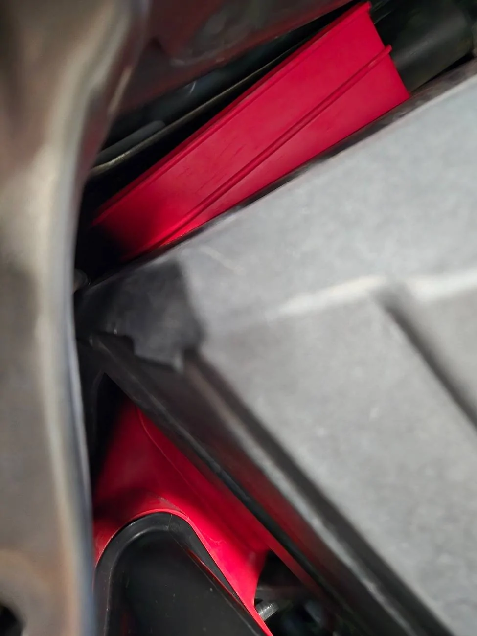

The Trailhunter is now fully wife approved.
Some more pics for the curious.
2024 Tacoma Quieting the RAI (Snorkel) Sound IMG_6197
2024 Tacoma Quieting the RAI (Snorkel) Sound IMG_6198
2024 Tacoma Quieting the RAI (Snorkel) Sound IMG_6196
