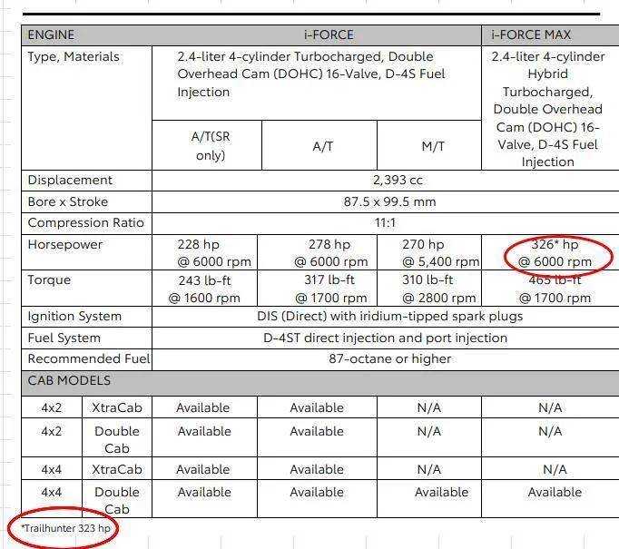

If there were any performance gains from the TRD exhaust or intake, it would show up in the engine specs. The TH "snorkel" reduces power and that is reflected in the engine specs.
