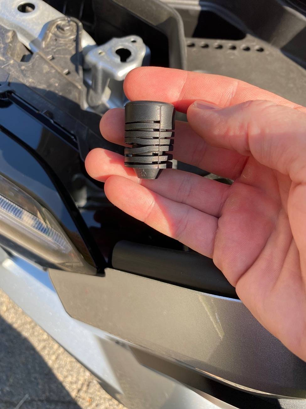

Figured it out! It’s the hood. I was stumped as to why the noise stopped yesterday after washing it. So I recreated what I did, poured water onto each shock/bushing i could find, one at a time. Noise stayed. Then remember I popped the hood to dry it. So I pulled the latch and drove a few feet, noise gone. Closed the hood, noise came right back. Did this a few times and I’m confident that’s the culprit.
DuckBlind
Oct 12, 2024
Spokane
24 Tacoma TRD OR
There are two bumpers, one on each side of the hood to add pressure to the hood when it’s latched and adjust the height between the hood and fenders. My driver side bumper was threaded far down and was barely applying any pressure, if any. I unscrewed it to match the size of the passenger bumper and voila.
