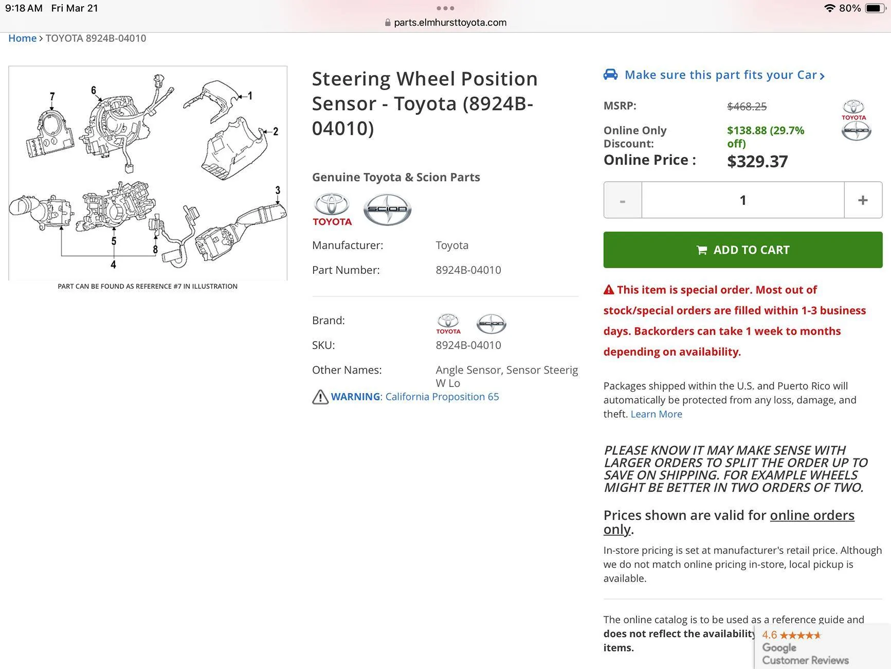

Thanks for sharing. This is great info for when our trucks are past the warranty period.
A genuine Toyota SWPS is around $325. Itā€™s part 7 in the illustration.
