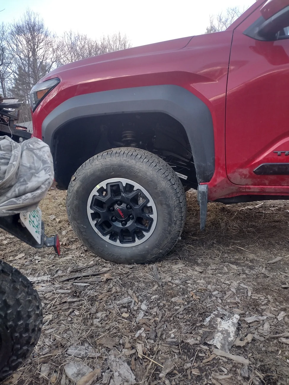

I am extremely impressed with the stock OR suspension. Absorbs big bumps very well and is very compliant on rough trails. The only reason I could see you would want to upgrade to Fox or King is if you wanted a 2.5”+ lift or were racing.
The shocks are the same diameter as the old 5100s but with a remote resi. I think you’d have to step up to 6100/5160 in order to have an upgrade over stock. Integral bump stops mean an above coil spacer is no longer a detriment, and with the extra travel a small preload spacer isn’t going to be bad either. To top it off, 33” tires bolt right on. It’s a seriously capable truck, even in stock form.
