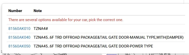

I broke my left tail light and was looking up the part for an TRD Off Road and there are 3 variants. Anyone know hiw to tell them apart?
81560-AK010
81560-AK040
81560-AK050
Parts diagram shows them all the sameā€¦

I also have left taillight smashed. These are from my body shop estimates. Lamp assy w/TRD PKG. AK040 $486.09 Lamp assy w/o TRD pkg. AK010 $452.39. I have no info on AK050.

Thanks, that helps for AK010. I'm wondering then if AK0450 is with power tailgate or if it's for Pro?
