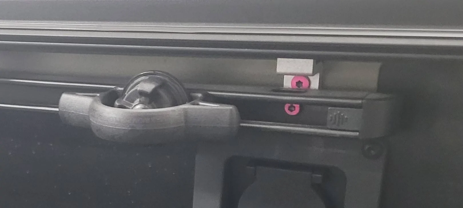

Factory Toyota cover retains full use of rails by using mounting brackets behind the rails leaving the rails in front for full access. Most other covers I have seen have brackets that use the rails to anchor the top down. The space used is minimal by the mounting brackets.
Does this move the whole rail assembly down as well? I have seen a couple that move the whole bracket down slightly and hinder movement of the access door for the plugs on the left.
Here is a pic. Yes the mounting of the rail moves down slightly and away from the bed wall. The upper screw (Pink head) is the original rail mounting location. The space between the pink screws is basically the distance the rail moved.
