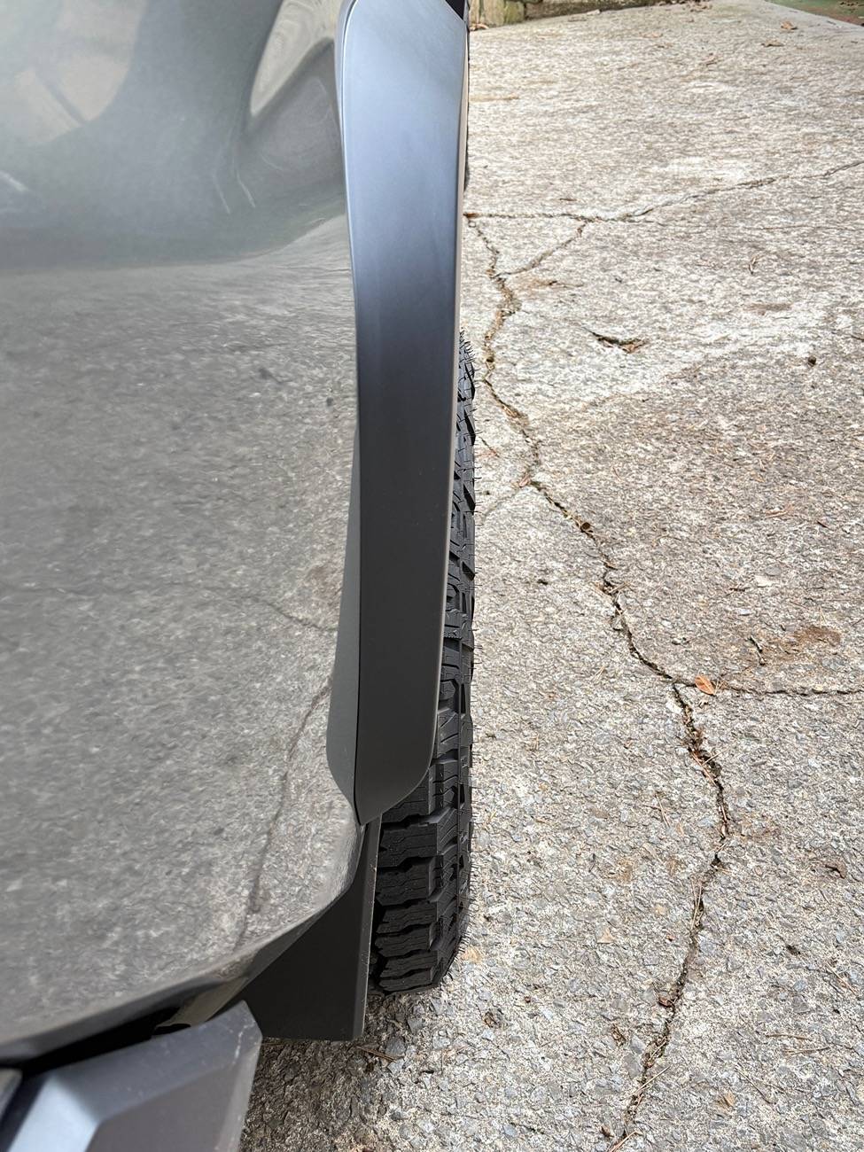

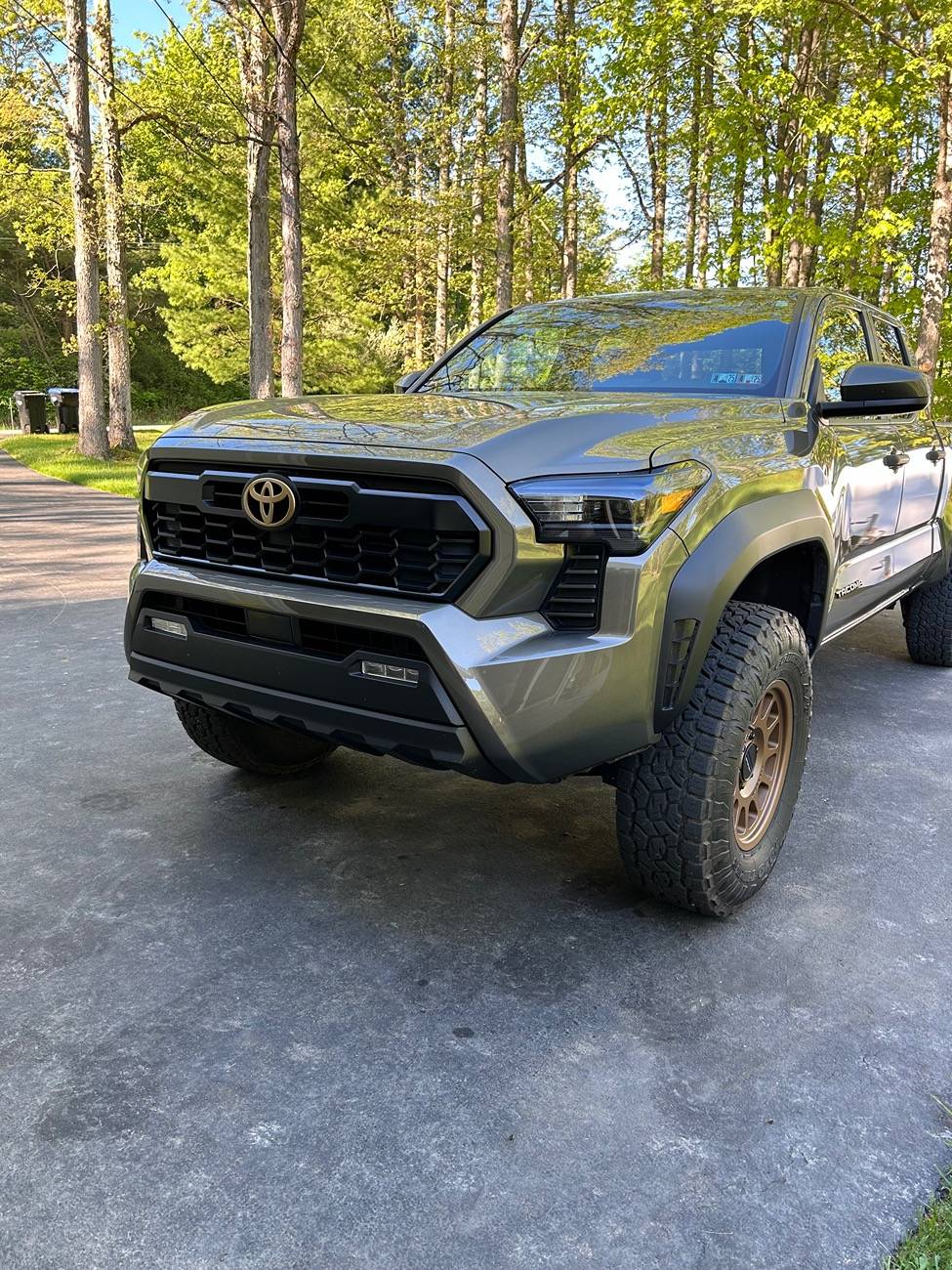

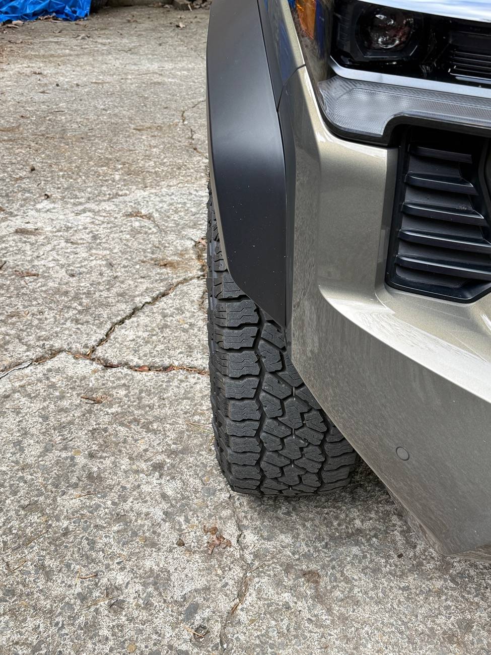

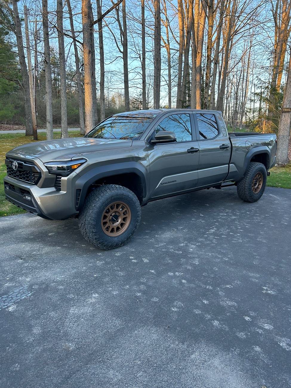

I weighed my stock TH wheels and tires and got ~74 pounds. I have switched to the Method 703 rims and Falken AT4W 285/70/17 which now weigh in 90 pounds. Will be doing a good bit of overlanding so wanted a heavier tire. Havent seen a big difference in ride between stock and new setup.. Maybe took 1 mpg hit. Trying to sell OEM setup but thinking maybe keep to run for driving around when not traveling.. Not sure how the OEM will do in rain and snow ( we get a lot of rain in east TN). And I think the overall height is almost identical wnd with the +35 offset the poke is also similar.
the closest tire is OEM TH tire, the one in back is Falken. Poke is the Falken

The SL or Load C duraspec? Could you do a side profile view for a wide angle so we can see how tall they sit? They look great.
Yours are for sure taller than the OEM because under compression tires come down about 0.75 to 1 inch.

C load.

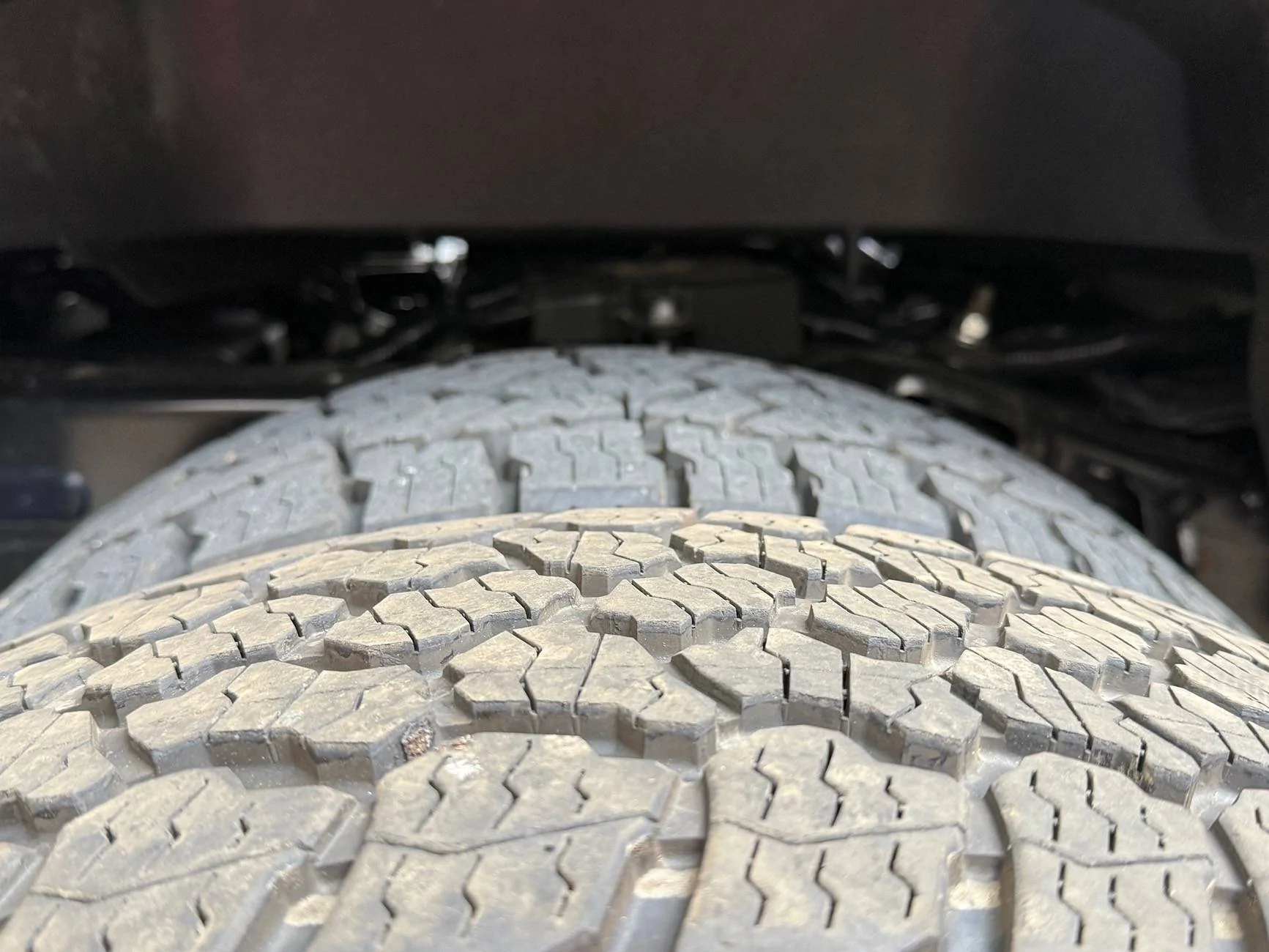

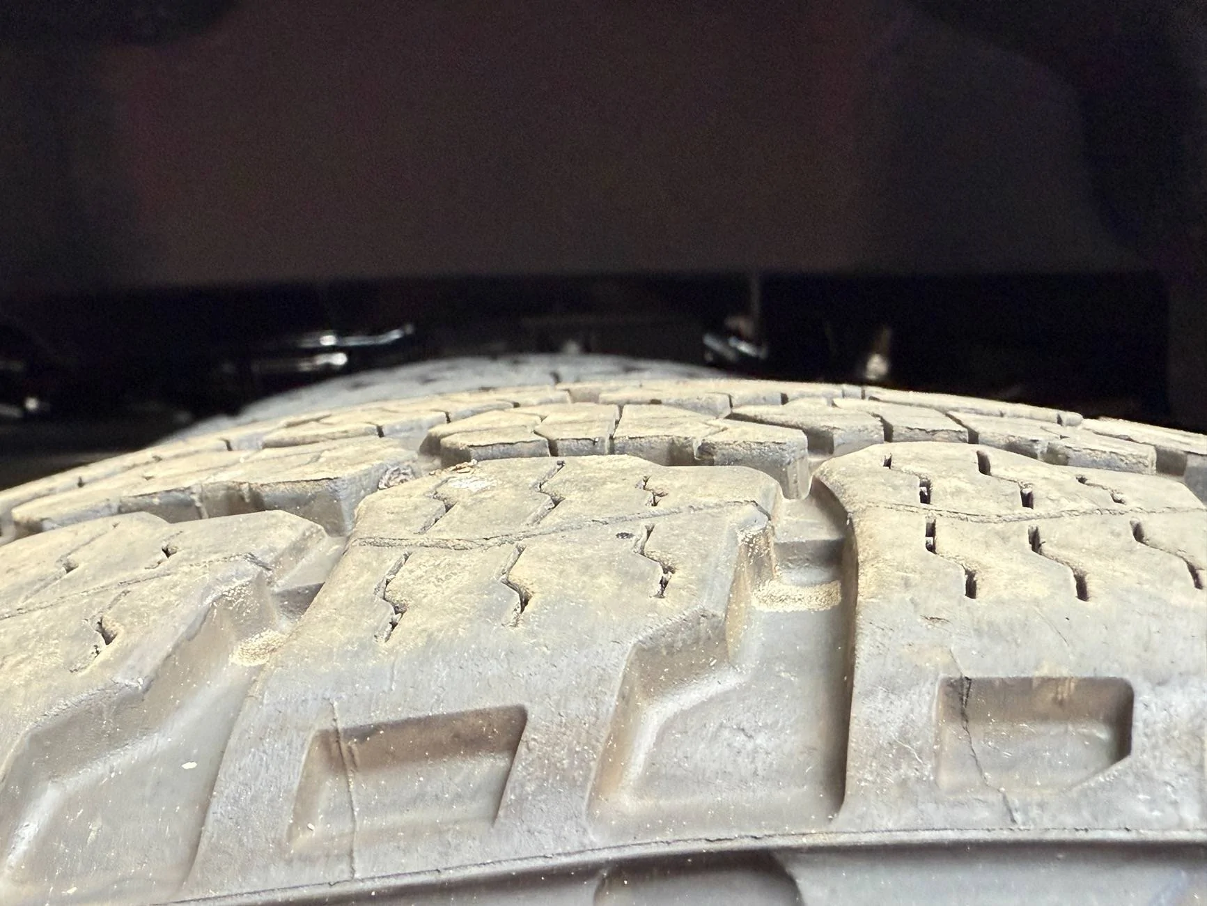

After some research I opted to go with the Toyo Open Country AT III 285/75/R17 C load rating on my OR. The truck has a 2 1/2” spacer lift. Tire pressure 37 front 34 rear. Tires are 20 lbs heavier than OEM sacrificing about 2 mpg. Ride quality and noise is comparable to the OEM. Time will tell on longevity.

I’m thinking about this exact setup bc of the C load. These are 33.9” tall and seem perfect. Did you need to remove the crash pad? Not sure I could fit them on. My 33.43” is pretty damn close to rubbing.
Also are those the +35 offset methods? How’s the “poke” looking ?
Looking sharp.
