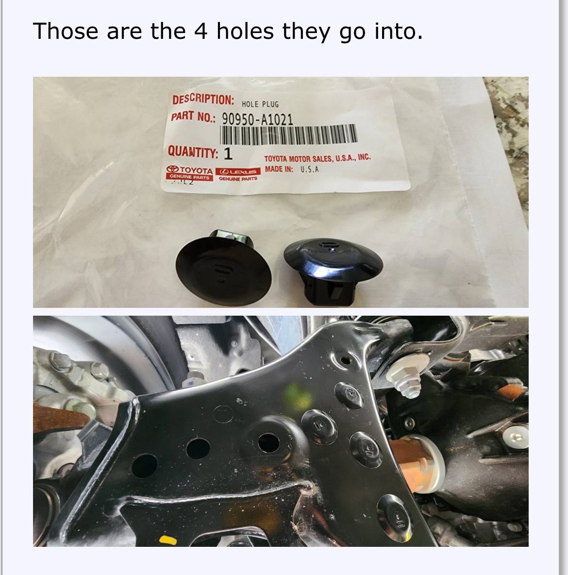

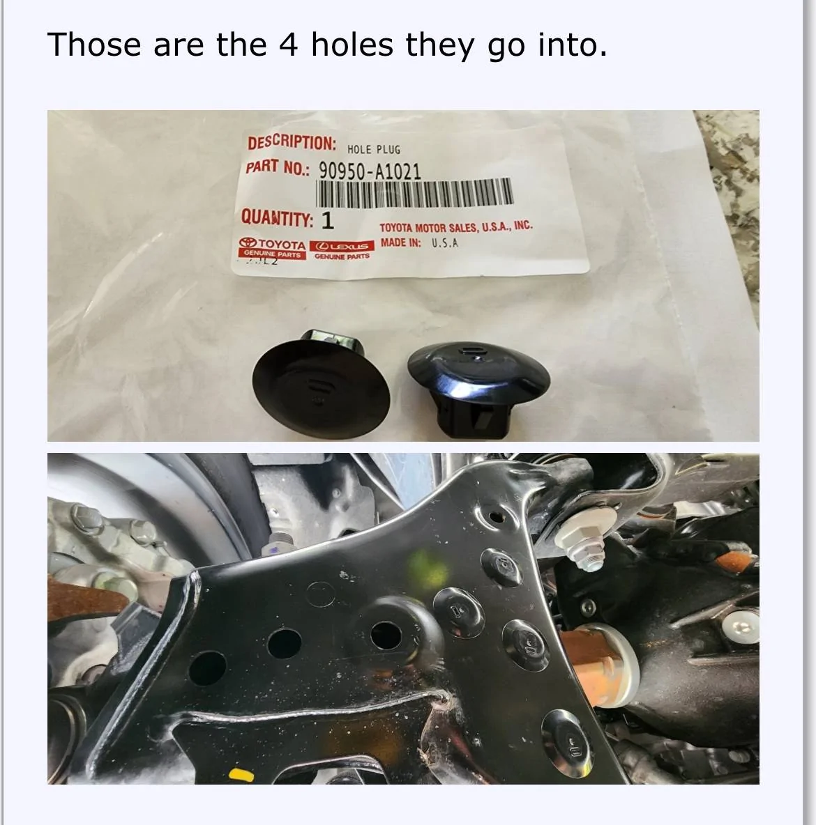

Huh, interesting. Yeah it definitely doesn’t have them in. I am waiting for them to arrive still.

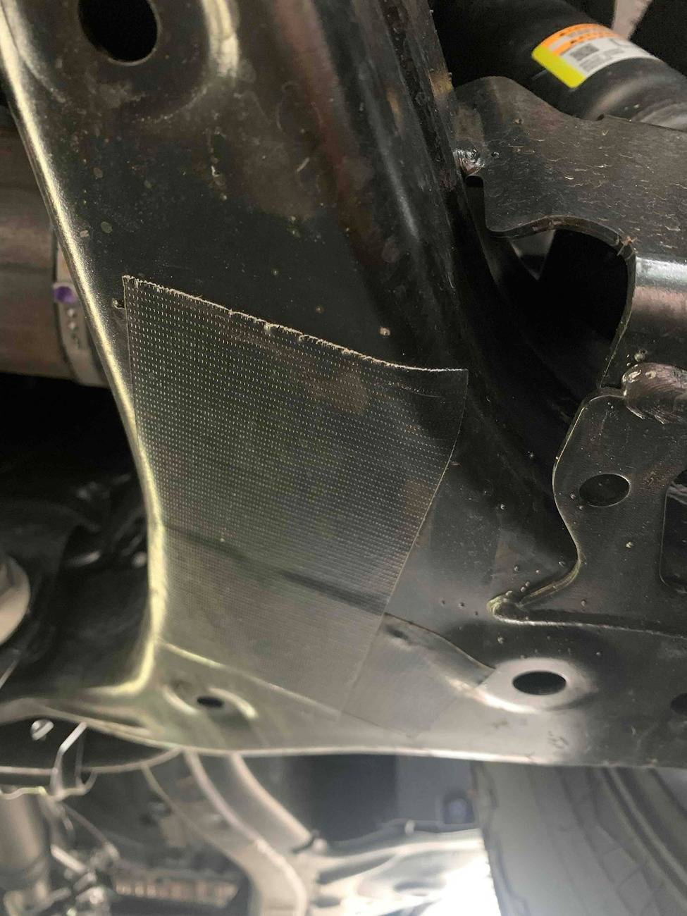

Mine has a build date of June and it came with no plugs. I tried to buy them but they are on b/o so I used duct tape for now 😬

I just took delivery of my Limited and would like to know what "plugs" you're talking about.
1,414
1,603
@rkohlerbend they are plastic plugs which fill holes in the front lower control arms. Toyota plugs the trucks that come without a front spoiler, and not the ones which come with one. When you remove the front air dam those holes make a whistling sound that bothers some people. You can fix that with these overpriced plugs if you want to remove that front air dam.

Is there a Toyota part number for these that you're aware of?

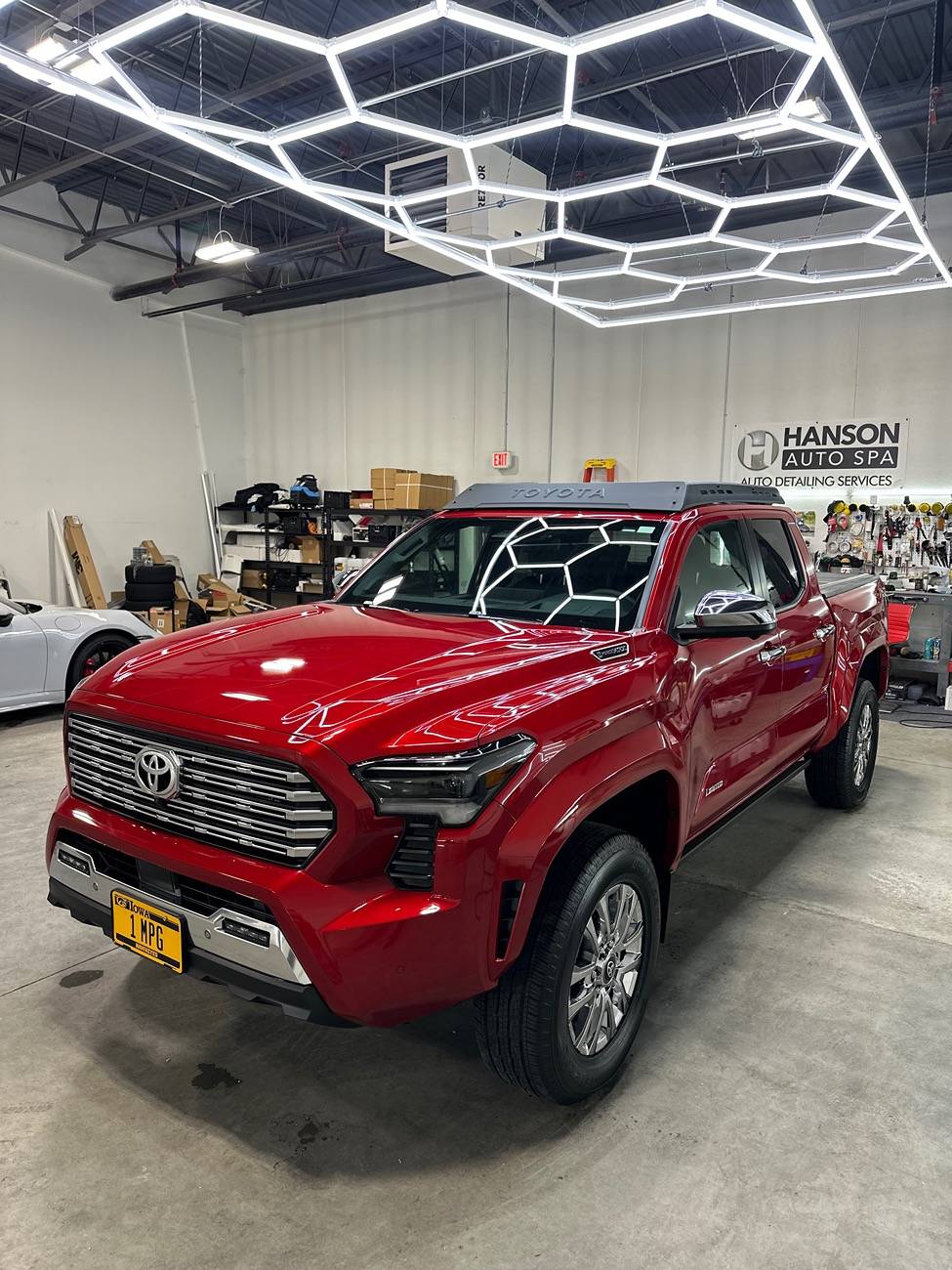

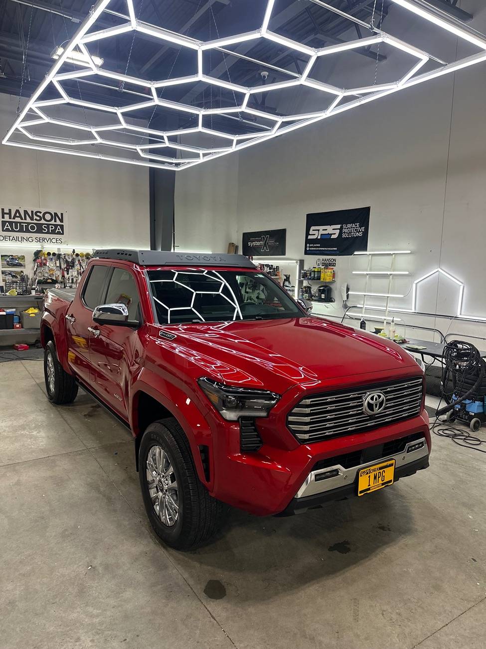

Got the system x max g+ ceramic coating this week. Hanson auto spa in Des Moines does a great job for any locals. He found two small areas that needed correction, one was like a hair or something in the clear.
Probably the last mod I make except for various car seats! And a new custom plate.
