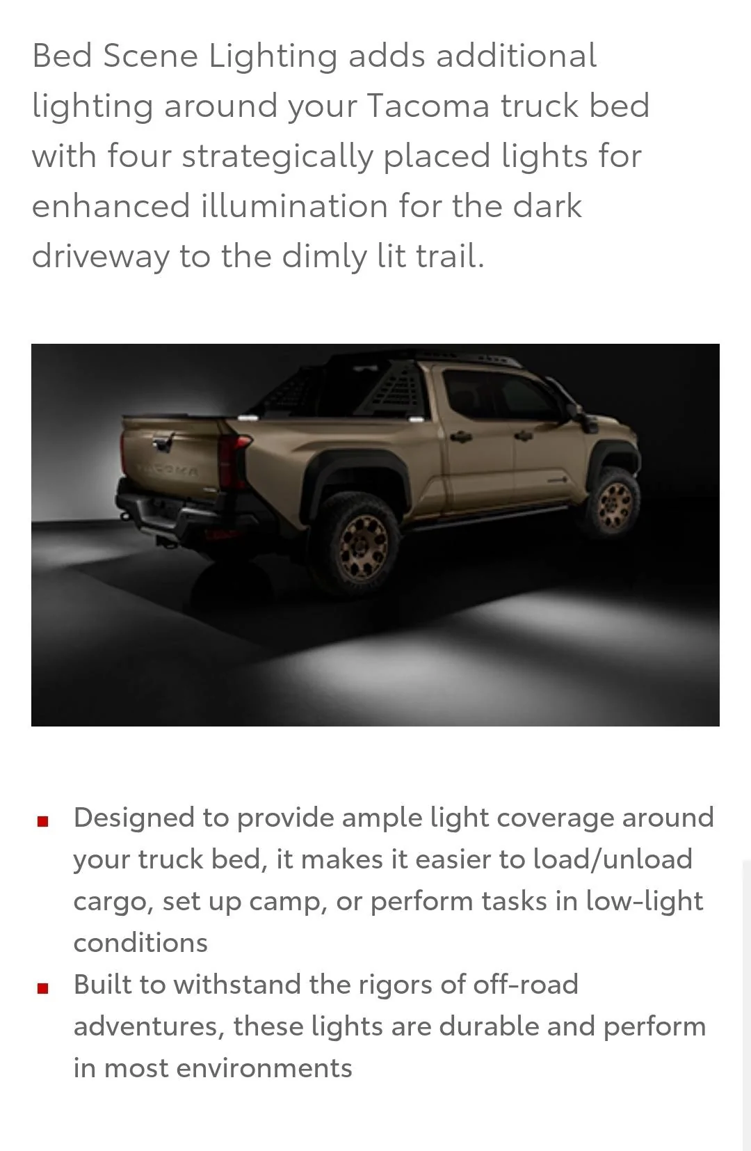

Were you able to order the parts based on these numbers? I have the rail caps. I just need the lights and the wiring harness
Haven't tried, didn't have a need. I originally wanted to do these, but I'm not sure I'm missing not having them.

Yep, that's the official name. That's not the part we've been after since July, 2024! It's the bigger 1 above that has the lights and wiring as the diagnosis was an electrical short in the DS harness. 'Supposedly' that part should arrive at the dealer late February. I'm not holding my breath. Toyota has really blown it on parts support on these trucks.
Right. That light string is supposedly part# 82214A for short bed and #82214B for long bed.
Question is... what is the rest of the part number string...
(random related aside... if anyone breaks or needs to replace the two bed lights on the interior, they are part number 8151A "Bed Light (Inner Bed Light)".
