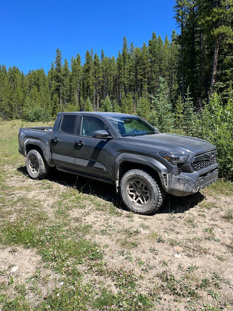

If you’re going through the effort of getting new wheels I don’t know why you wouldn’t go 285/70r17. It fits no problem on stock suspension even with that offset wheel. Here’s mine.
2024 Tacoma 265 vs 285’s on stock suspension IMG_9242
