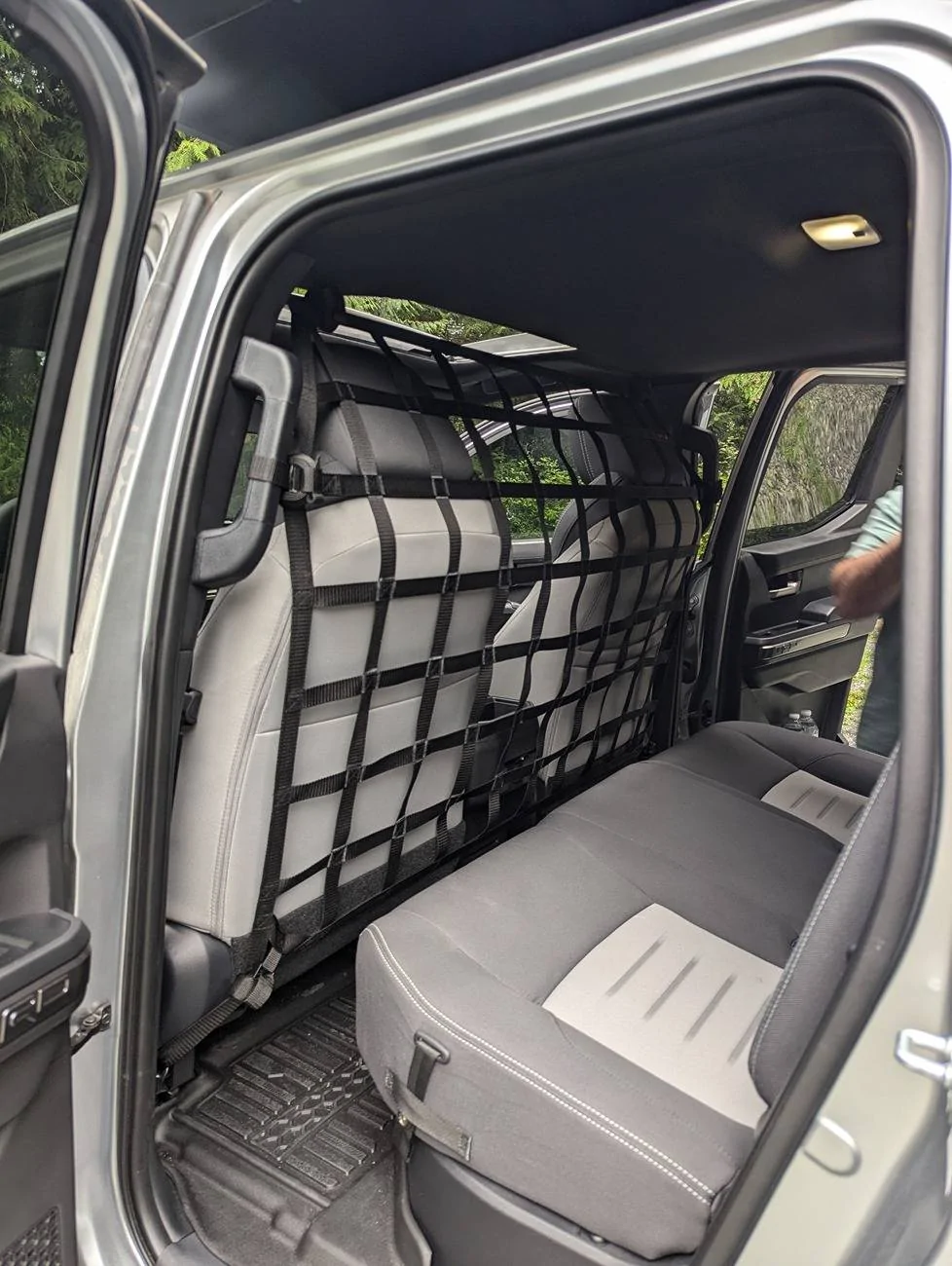

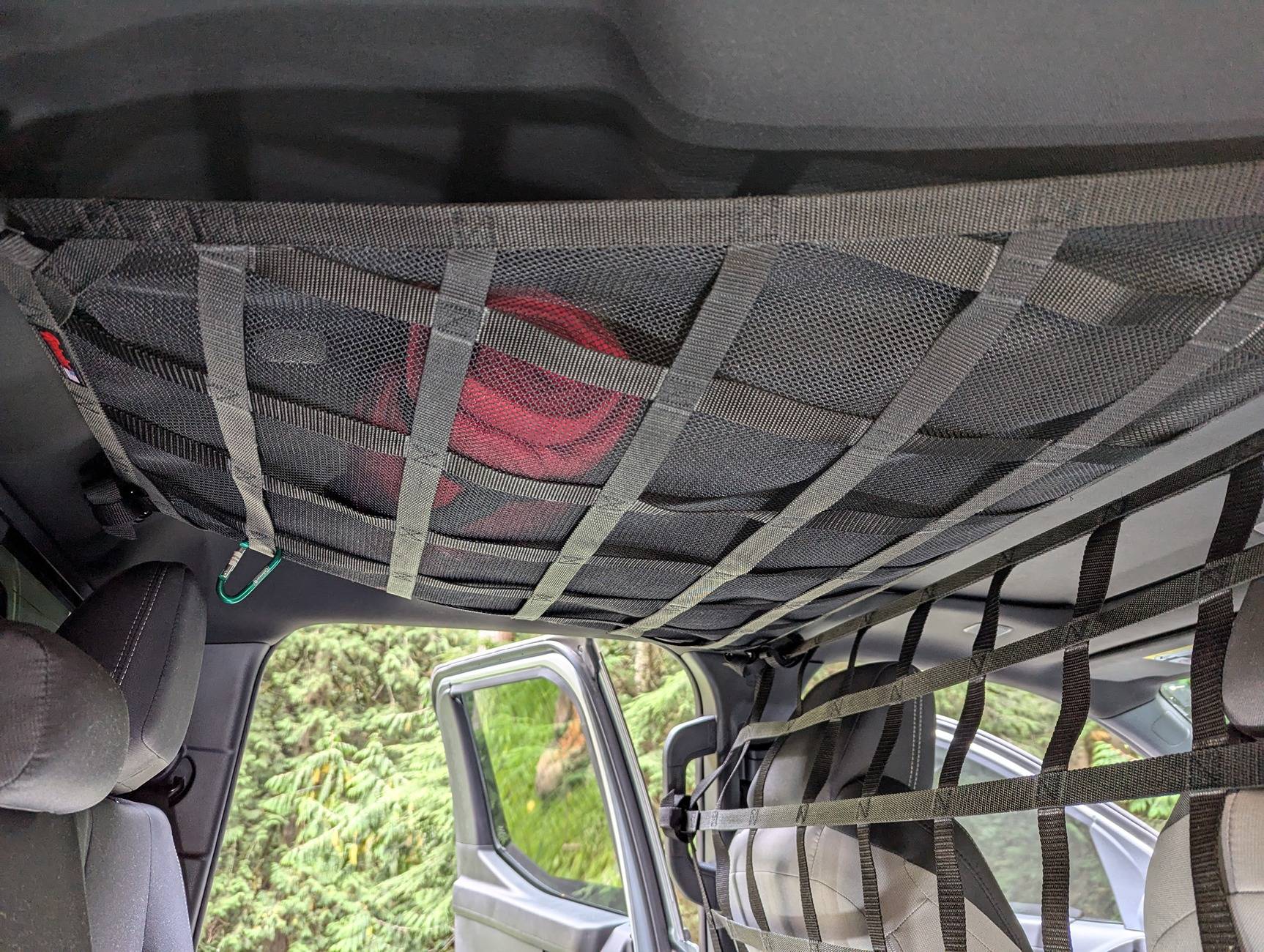

I took a trip this week across the water to Orcas Island in the Washington state San Juan's to Raingler Nets. The owner, Eddie, needed to test fit a Tacoma so I volunteered my truck. Raingler has two main products for the Tacoma, a barrier between the front and back seats, and a storage "loft" over the back seat.

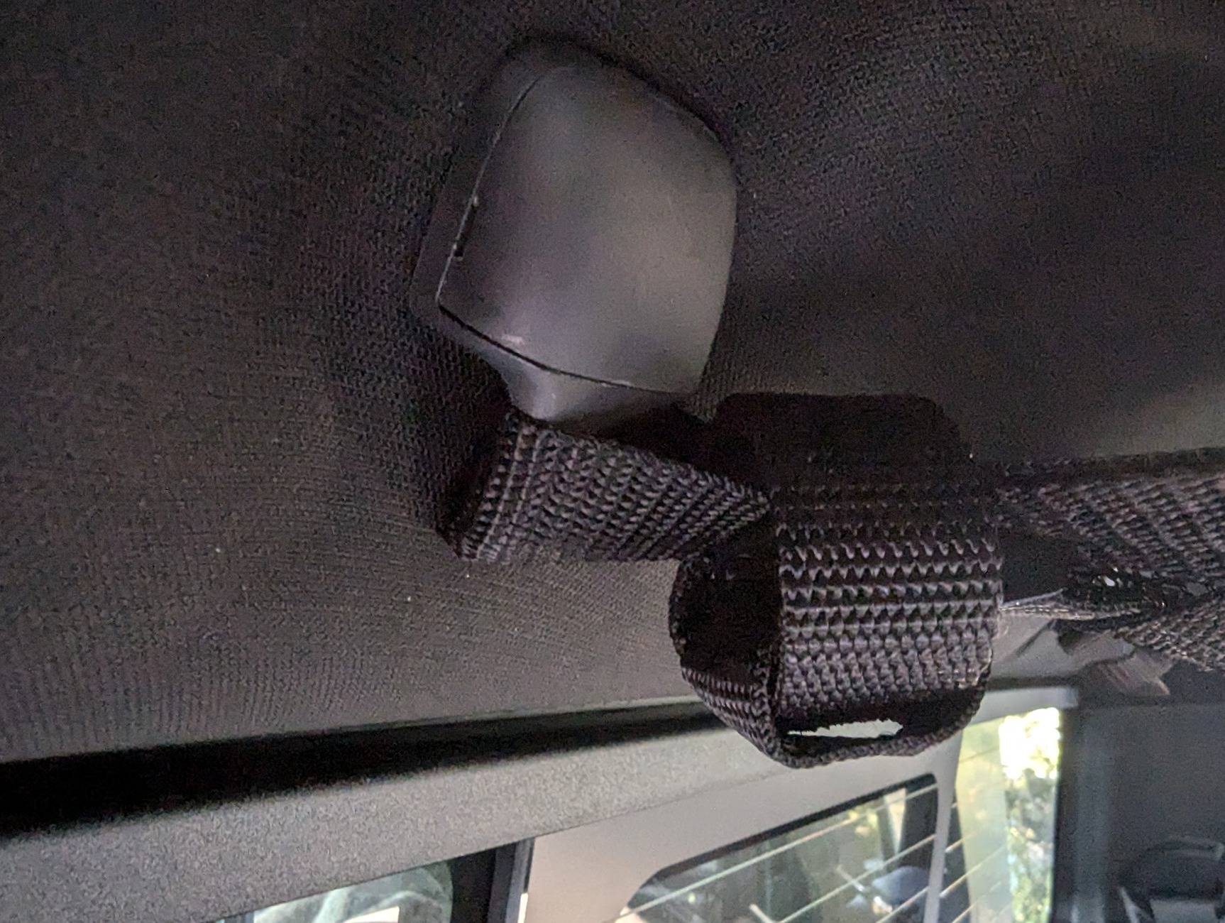

Eddie was quite pleased at how easy the new Tacoma was to fit their products. Apparently some of the previous generations needed drilling and whatnot to install mounting points for the barrier. That wasn't the case here. He was able to use the seat belt mounting points for the barrier D rings and those same points for the loft, along with the existing back coat hooks which just needed to be flipped upside down.
The result is pretty sweet. TBH these aren't items I would probably have considered but that's mainly because I've banished the dogs from my truck. If you're carrying the dogs around then IMHO these mods are almost mandatory and now that I've got them I may reconsider my no-dog policy. Of course now I'm thinking about deleting the drivers side rear seat and building a platform in it's place.
My sunroof does intrude on the loft space but there's still quite a bit of space up there for items. It also intrudes a bit on back passenger headroom but I rarely have anyone sitting back there and if you're short (5' 7") like me then it's not an issue anyway.

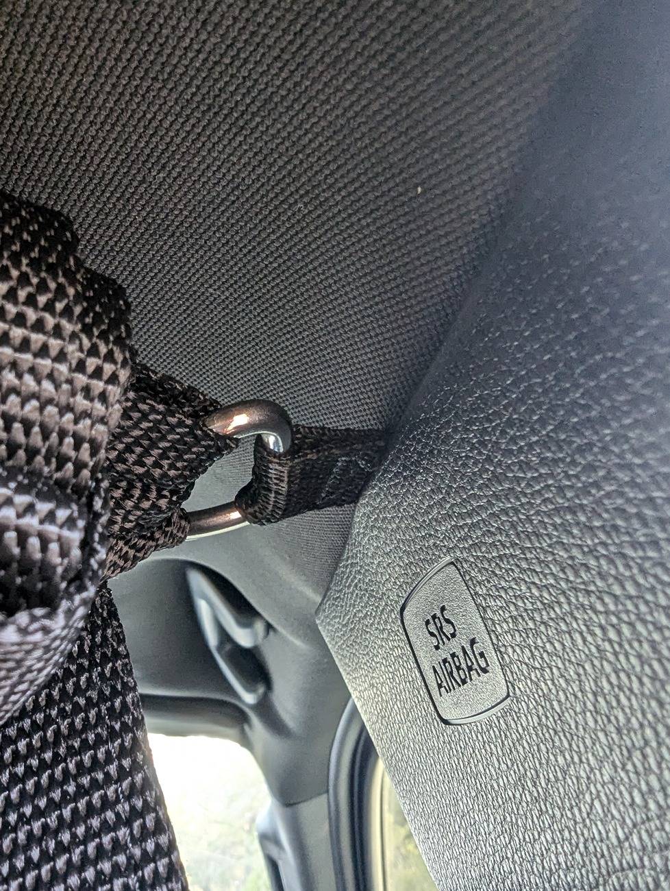

The net comes with D rings and webbing loops that you install. I'd take a picture but I'm currently out in the middle of nowhere... It's a pretty easy install though. Basically you pull the plastic off the b pillar and then remove the bolt holding the upper seatbelt, install the webbing that has the D ring in the same bolt the seatbelt is attached to. You use the same D ring for both the loft net and the barrier...

Thanks for that description, it sounds like a solid tie down point in the front. I will likely get one of these, but one more question came to mind, with the netting connected to the bolt under the B pillar does it roll up?

Here are pictures I took off the front and back mounting points this morning. The loft net doesn't come with anything to roll it up but I certainly don't see why you couldn't easily get some Velcro and do so. The loft is shaped like a trapezoid so I'd probably roll it towards the front since that's the widest part.
Keep in mind that my net is a prototype so the way the ends are finished in the shipped version might look a little different but it will work the same way.
