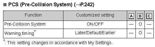

https://assets.sia.toyota.com/publi...Z*MTcwMjQxNzcwMS4xLjEuMTcwMjQxNzc0NC4xNy4wLjA.
Page 278 talks about it
Page 635 talks about how to disable it
Let us know if that works because I'd be interested in doing it too
