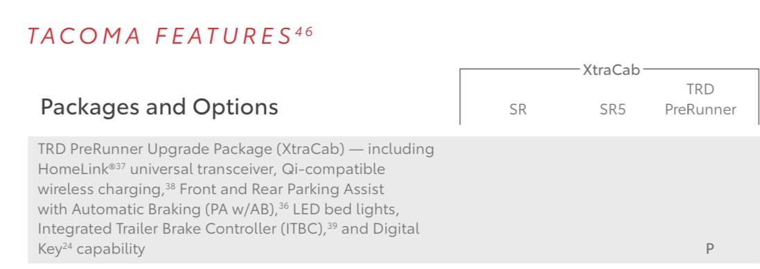

maybe this function is not availabe on the prerunner..i have searched all over for it
Does your Prerunner have the upgrade package? Sounds like it does. Did you watch the video earlier in this thread?
