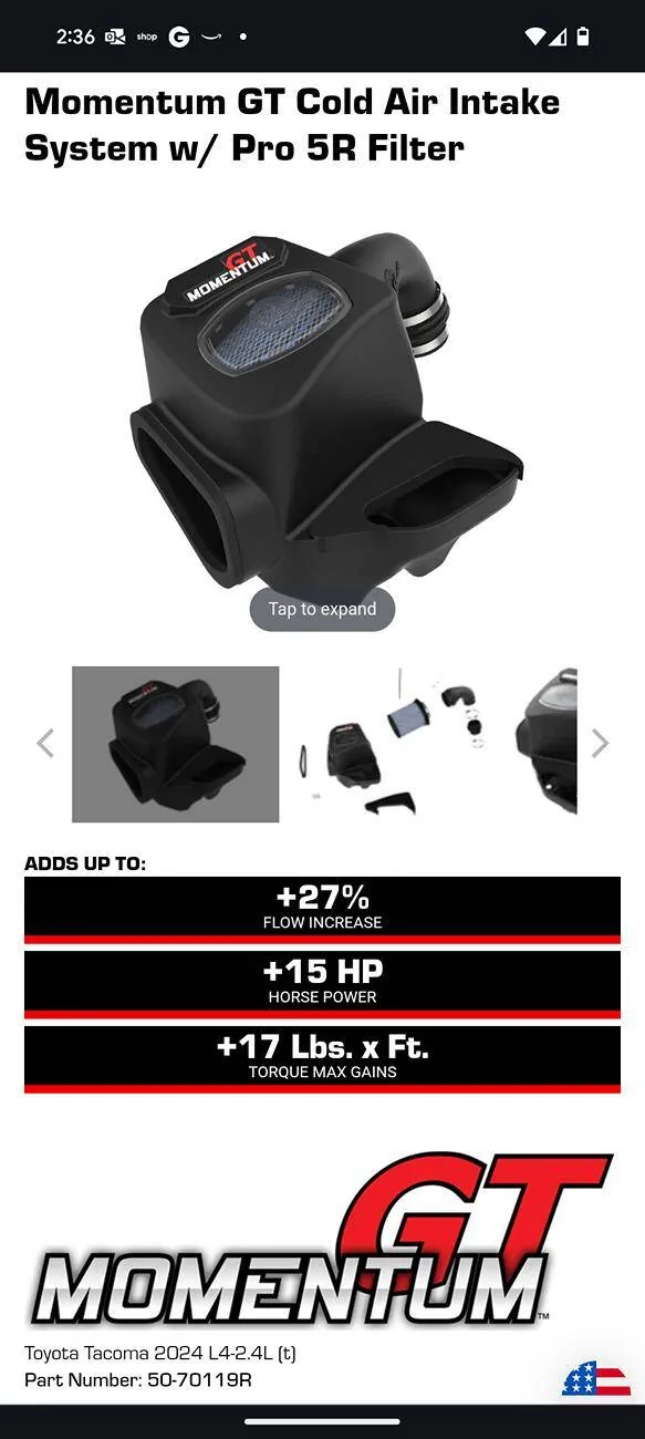

I was considering installing an aftermarket cold air intake system. I don't have any experience with them. So, I was wondering if anyone out there does or is considering an installation. There are claims in adds 15 HP and 17 Lbs x Ft. TQ. Also wondering if an installation will require retuning to accommodate.
I would greatly appreciate some thoughts on plus and minus.

If that's the one with the K&N filter, watch this video, and you'll understand why it boosts performance. Run your truck without a filter, and it, too, will boost power. For a while.
I'm pretty sure OP is talking about this one
2024 Tacoma Cold Air Intake CAI System? 1000011955

Can’t have your cake and eat it too. You have to let more dirt in to let more air in. For 0.1 second though? Btw, the truck already comes with a CAI standard just without the high flow filter.
