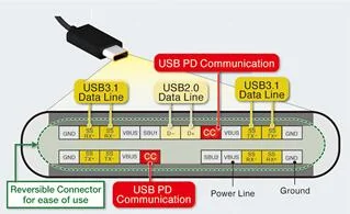

Unfortunately this is incorrect. Viofo's parking mode needs their hardwire kit or kits using the same pinout, meaning that not all kits with ACC + constant + gnd will trigger their parking mode. Viofo uses a non-standard implementation (aka proprietary pinout) USB-C, which is how it feeds the ACC signal into the USB-C cable. So if you wired up a different brand (or generic) hardwire kit to that 5-pin connector, you still might not be unable to trigger Viofo's parking mode. The 3-wire hardwire kit must use the same pinout as Viofo.
For people curious in the technical details... Viofo hijacks the USB PD signal pin in a normal USB-C port. This pin is what allows you to fast charge your iPhone or other USB-C native device. We wanted to keep this pin because Dongar PRO is future proofed and allows 5V 9V 12V fast charging, whereas something like the Viofo hk kit is 5V only. We have a microcontroller in the Dongar PRO which we considered trying to find a way of allowing the USB PD pin to pass through the ACC signal, but then you'd have to add another switch to toggle this mode because there's no way of telling what brand of camera is on the other side of a USB cable.

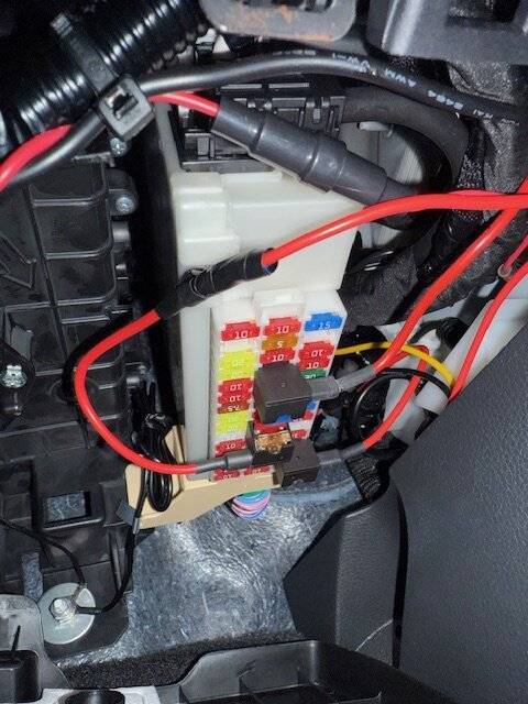

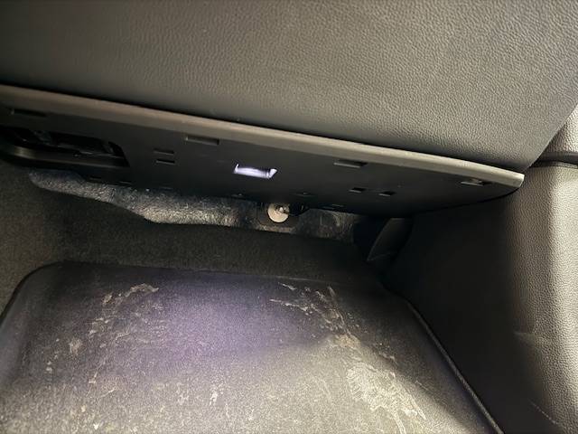

Thanks for the post. Are you saying the Dongar Pro doesn't support parking mode for Viofo dashcams? This is contrary to what their website advertises. I don't see anywhere where it says pro not compatible with Viofo?
One person that I know of got the Dongar to work with a Viofo camera. I returned mine. The Viofo adapter just works for the "parking mode" while Dongar does not as the parking mode should be intended.
You will need mini low profile fuses. There are fuses in the interior fuse panel under the glovebox that will work. The problem is that there is not enough space between the fuse box and the plastic kick cover to fit an add a fuse so you will need to leave the cover off.
See the detailed post by Dongar in this thread to see what I mean.
https://www.tacoma4g.com/forum/threads/dash-cam-solutions-for-2024-tacoma.1869/page-2
This is simply not true. I did the add a fuse for both the camera and my radar detector. The small fuse cover cannot be used. The actual kick panel can no problem fit as intended and covers the fuse box no problem.
Having said all of that I will be ordering the aliexpress plug and cleaning this up. Thanks for the info.
