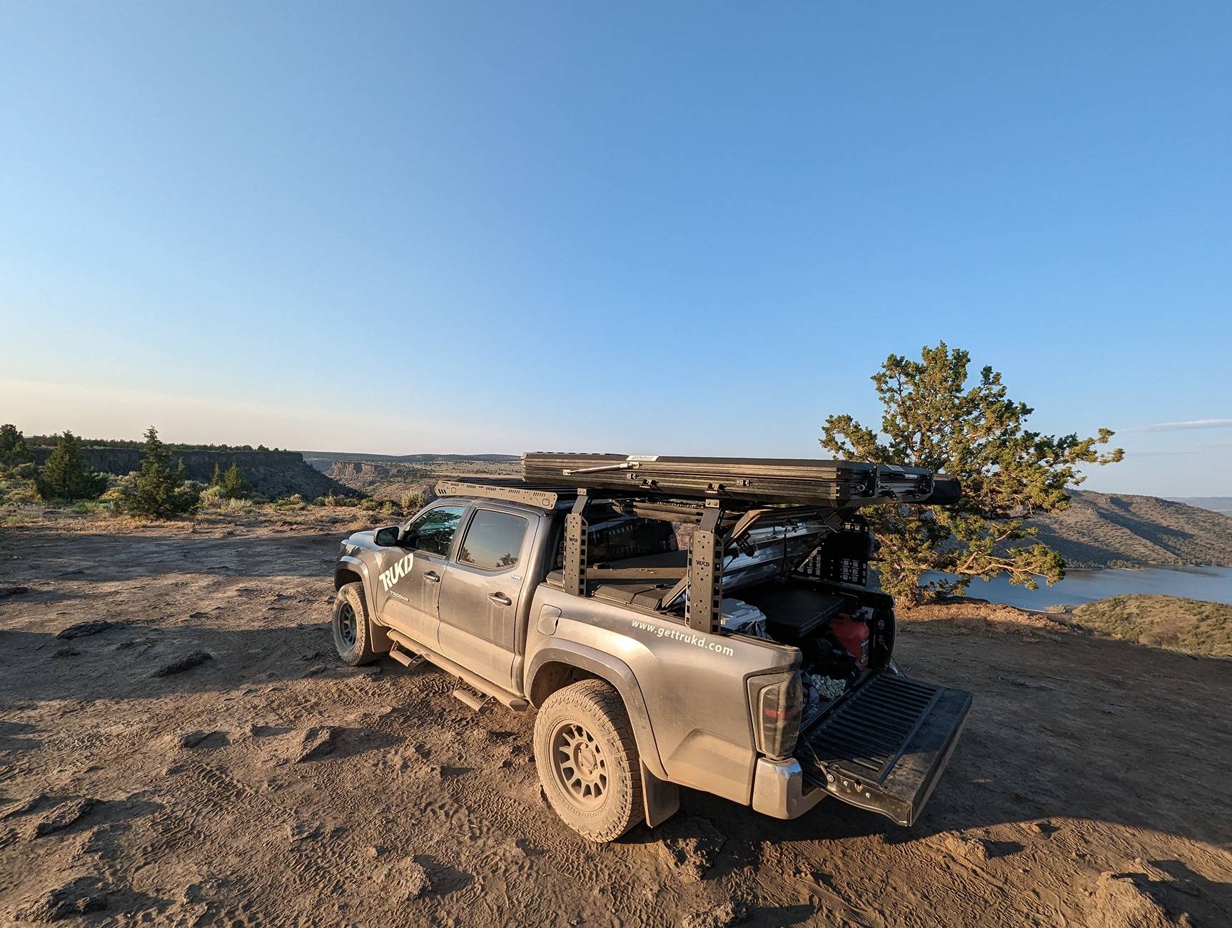

Diamondback's are gamechangers! Here is the one on our 3rd Gen. Security and weather resistance are unmatched.
2024 Tacoma Diamondback Tonneau Cover PXL_20230706_024701220

With 2 people we recommend removing the cover, loosely assembling the rack off the truck, place the rack on the truck, then reinstall the diamondback.
If you have just one person then keep the Diamondback on, build the rack one crossbar/set of uprights at a time, attach the two crossbars together with the front to back connectors, then tighten everything down. This way adds a little more time, but it is not bad at all. Just remember to keep things loose until you find the right position for everything.

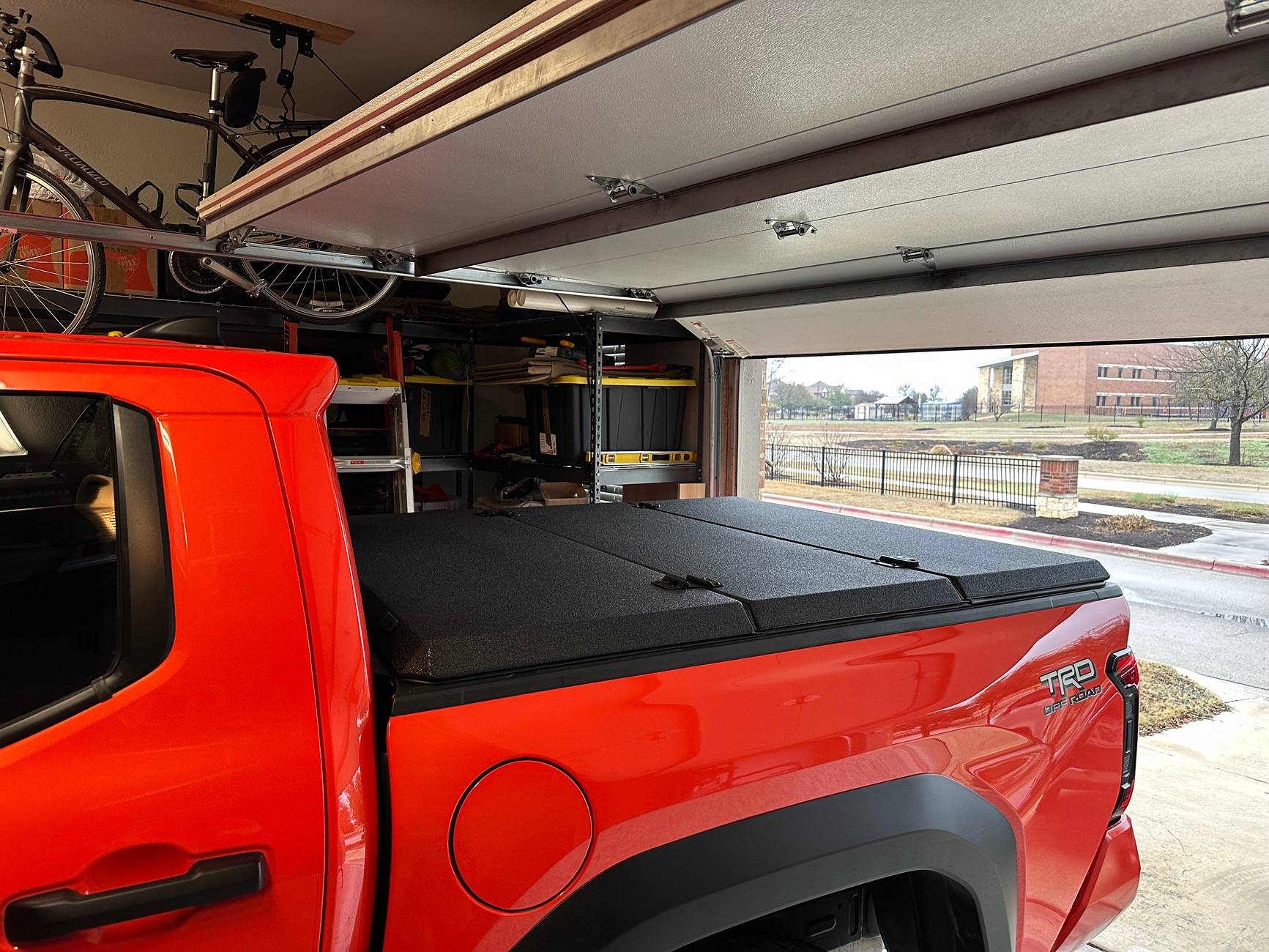

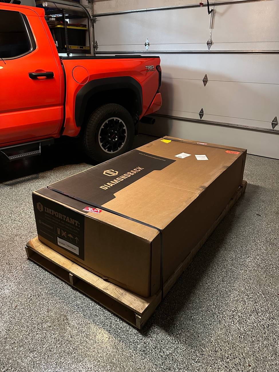

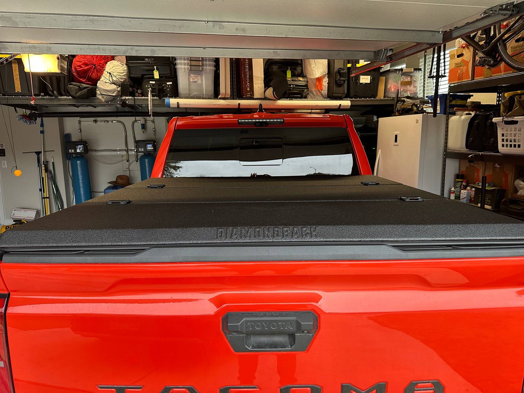

I put a Diamondback Switchback on a month ago. Smooth finish, great fit. Prepping the bed rail caps and installing the front bulkhead bar is more work than installing the actual cover. I’m super pleased.
ETA: I will say my electric tailgate needs a helping hand when the Switchback is latched down. Doesn’t bother me in the slightest, but may be a disappointment for others.

I like the floor of your garage.

Thanks. I’d like it better if the top clear coat wasn’t seperating from the epoxy, but I’ll get inspired to do something about it one day…
better than my dusty concrete floor
