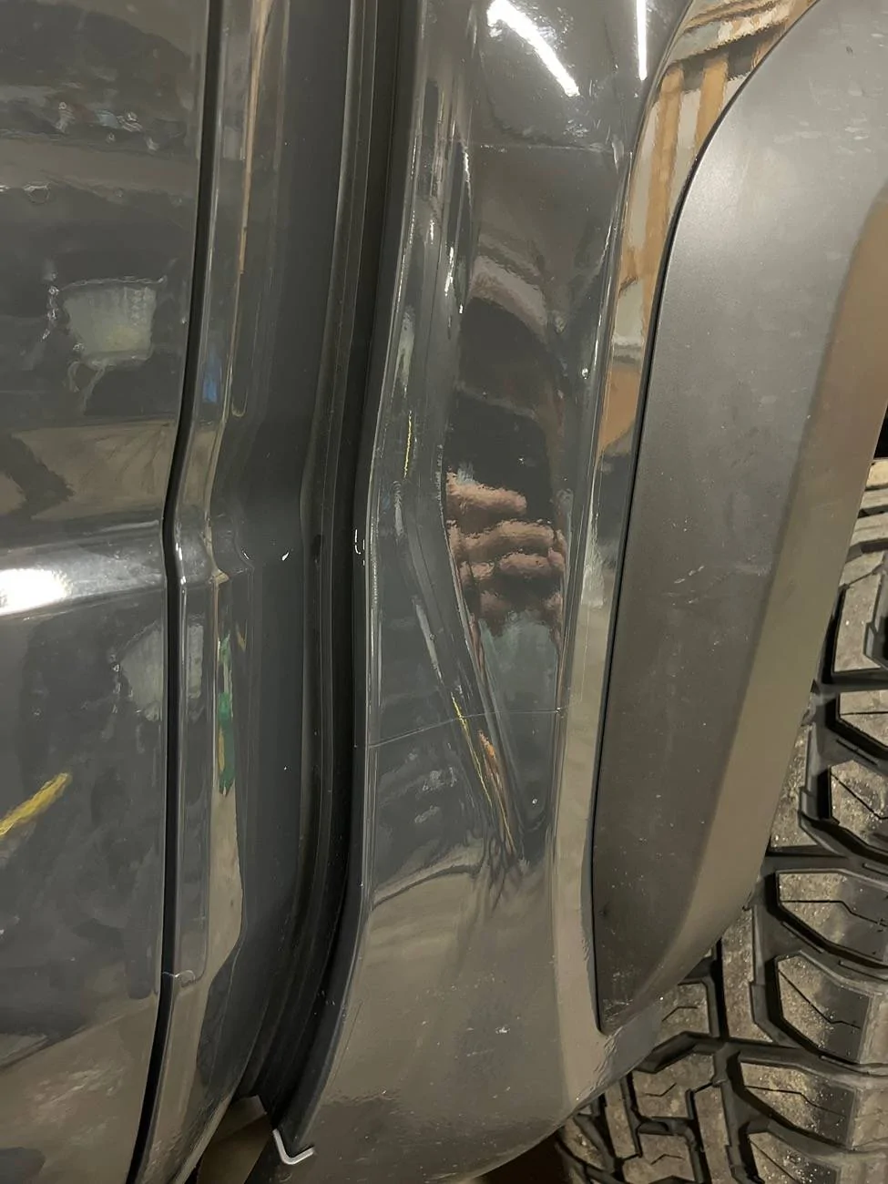

I highly recommend doing the rear fender. I did it myself and have never applied it before and it turned out great. Good enough that I bought a roll of 6ā€ stuff to do the bottom of the doors.

I did a trip where I put on 300 km of gravel roads and I got some paint chips even above the strips I did. I did the bottom of the doors with PPF and turns out itā€™s easy and my confidence is high, so I think Iā€™m going to remove the small piece I did on the fenders and get some 12ā€ wide stuff and trace out what I really want to cover.

I did 6ā€ on the bottom of the doors and everything was fine there. Itā€™s not a super high danger area anyway. Iā€™m just probably going to redo the fender area. I definitely got the worst area but still had some chips. The painted flares on the Pro are going to get beat to hell so you might want to consider that area as well.
