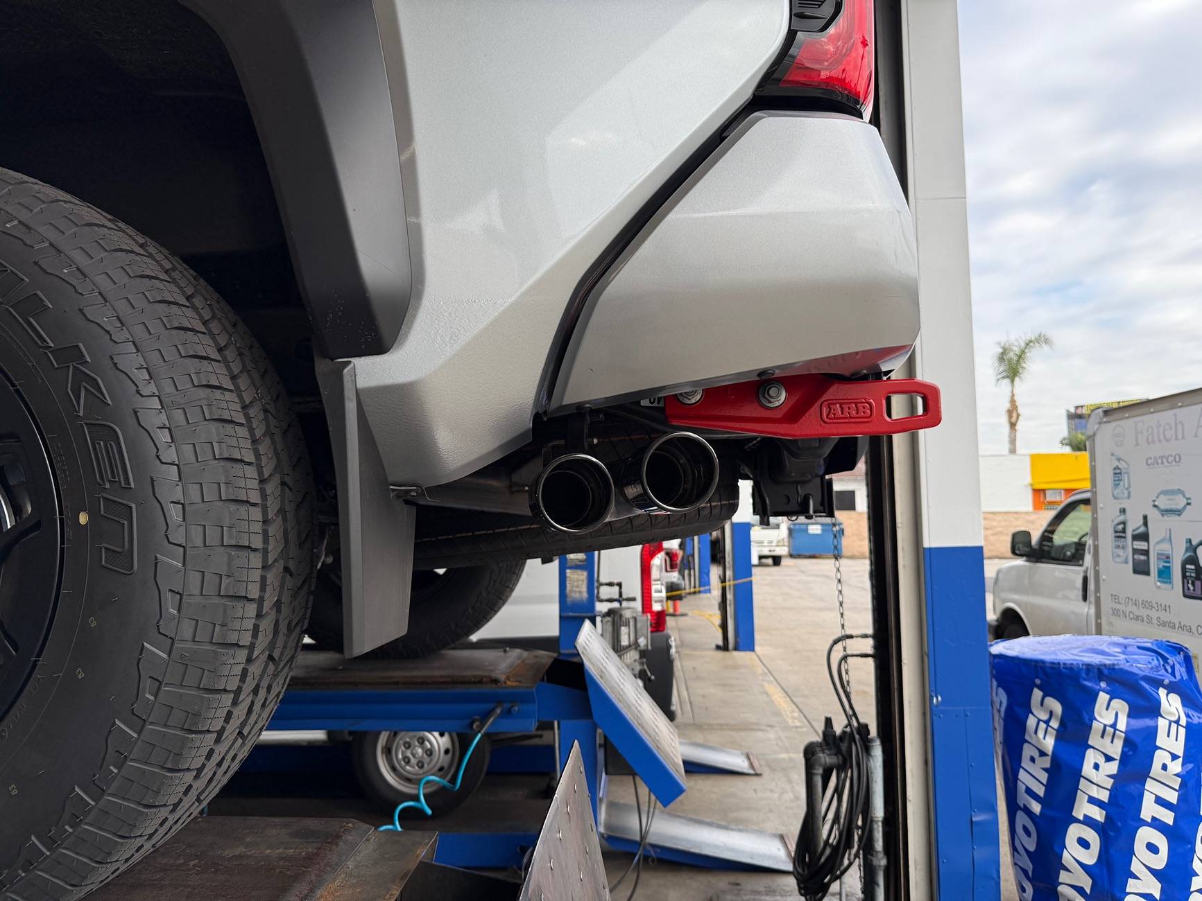

I swapped out the trailpipe with the TRD Pro one. It is quieter in the cabin. I feel the droning is gone. Most likely due to the fact the exhaust no longer dumps below the cabin. The tone is still there when you hit the gas but if you’re looking to further reduce cabin noise you can look into this.
The TRD Pro exhaust tucks up against the body and shouldn’t be in the way. Not as well as the Trail exhaust tip but it should be fine most of the time.

I like that but isn’t it like $750?
Part number?
Is it just a bolt on end piece or a whole new exhaust?

PT226-35241-02. It is just the rear section. Bolts in where the trail pipe does. It was $704 but I think there is an additional $50 off right now. Whether the cost is worth it is an individual decision and your mileage may vary.
re longevity. What you are saying may be true but Toyota does sell the TRD air filter which I believe is oiled and there have been people who have had problems with oiled filters in the long run. So yes I believe they have longevity in mind but I’m thinking beyond 250,000+ miles. I had a 2002 Tundra with 400,000 miles at work that had slightly inefficient cats and was burning slightly dirty. I would like to avoid dumping that exhaust under the bed.
For the record I don’t think the trail pipe will be an issue for 99.99% of people but since I am planning to keep the Tacoma for a while I do see some potential in my use case.
Curious, Toyota's website says it 'Produces a deep, throaty, award-winning exhaust note'. Guessing your truck is a Trailhunter? I wonder what the sound difference would be for an OR. I don't want any extra tone, I like the stock, just not crazy about how it looks.
Did you do the swap yourself? Looks like it is bolt on not welded?

I have an OR. I did the Trailpipe first but the wife didn’t like it. So I changed to the TRD upgrade exhaust. Both have extra tone but I feel it has less boominess than the Trailpipe.
I lifted the frame. It’s just two nuts and two hangers.
Cool, thanks. For clarification, you mean in order to 'boominess' it's:
Stock Exhaust < Pro Exhaust < Trailhunter dump?
