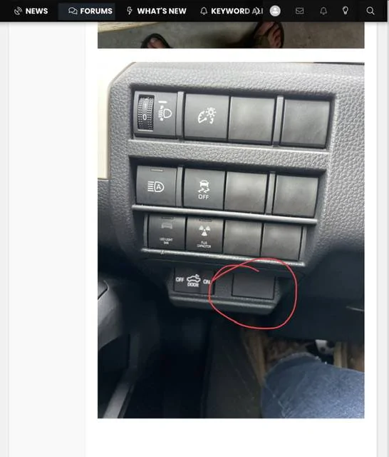

That looks great. The blank next to the bed light switch is just about the right size for the standard momentary rocker switch.

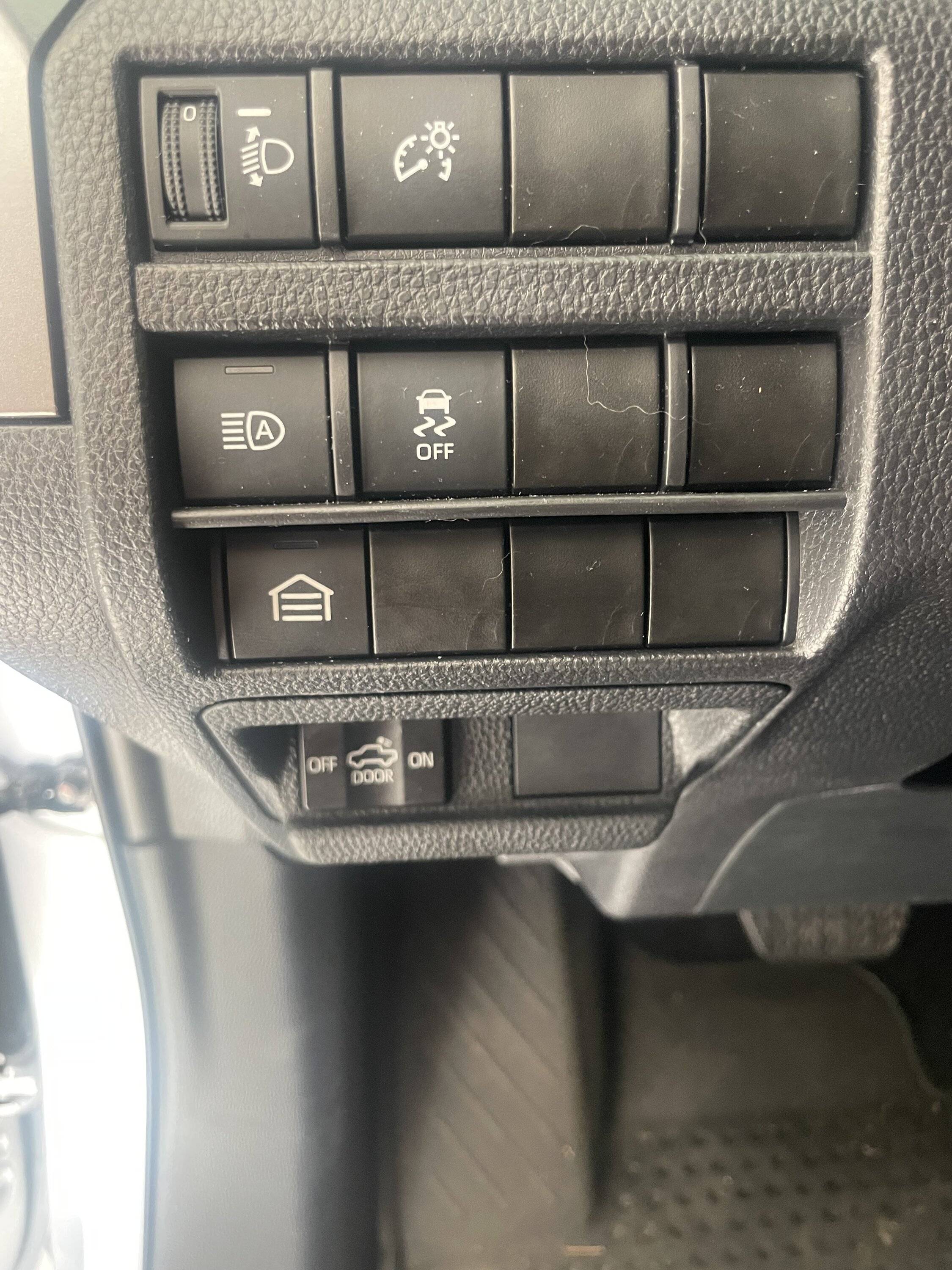

The angled panel underneath, with the bigger switches slides up towards you. You then have access to the blanks from under them.
I’m following your design but am having trouble (nervous about breaking something) removing the angled panel. Do I pry it out or is there a trick? Thanks for any help
So you kind of have to pull down on it slightly while you also pull it up towards you. It slides out and up.
Got it! Thank you. I ordered the button from aliexpress. Great idea and it looks great

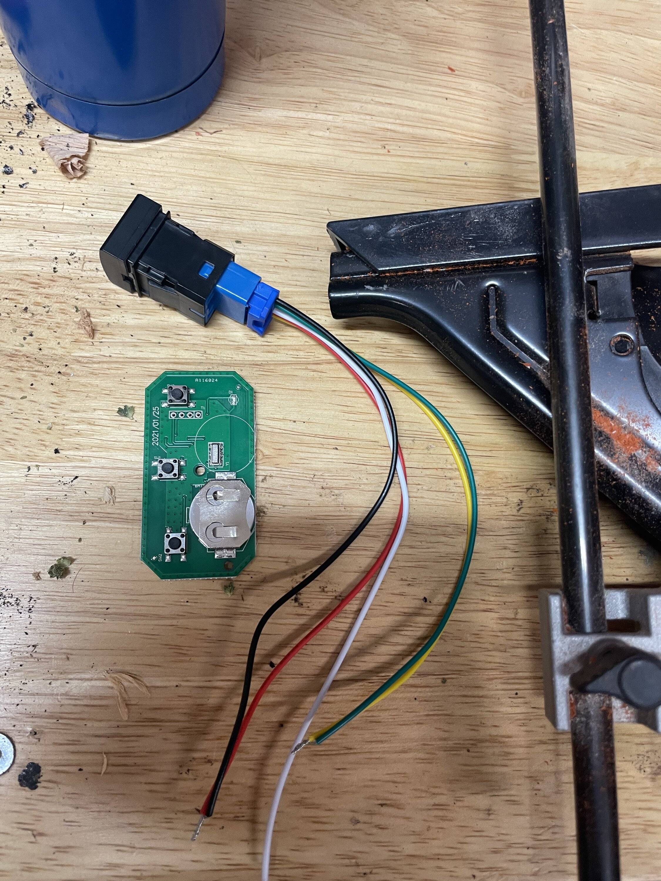

I wanted to get rid of my garage door opener on my visor and hide it with an oem looking button. Since I’ve got lots of poverty buttons, I have plenty of space.

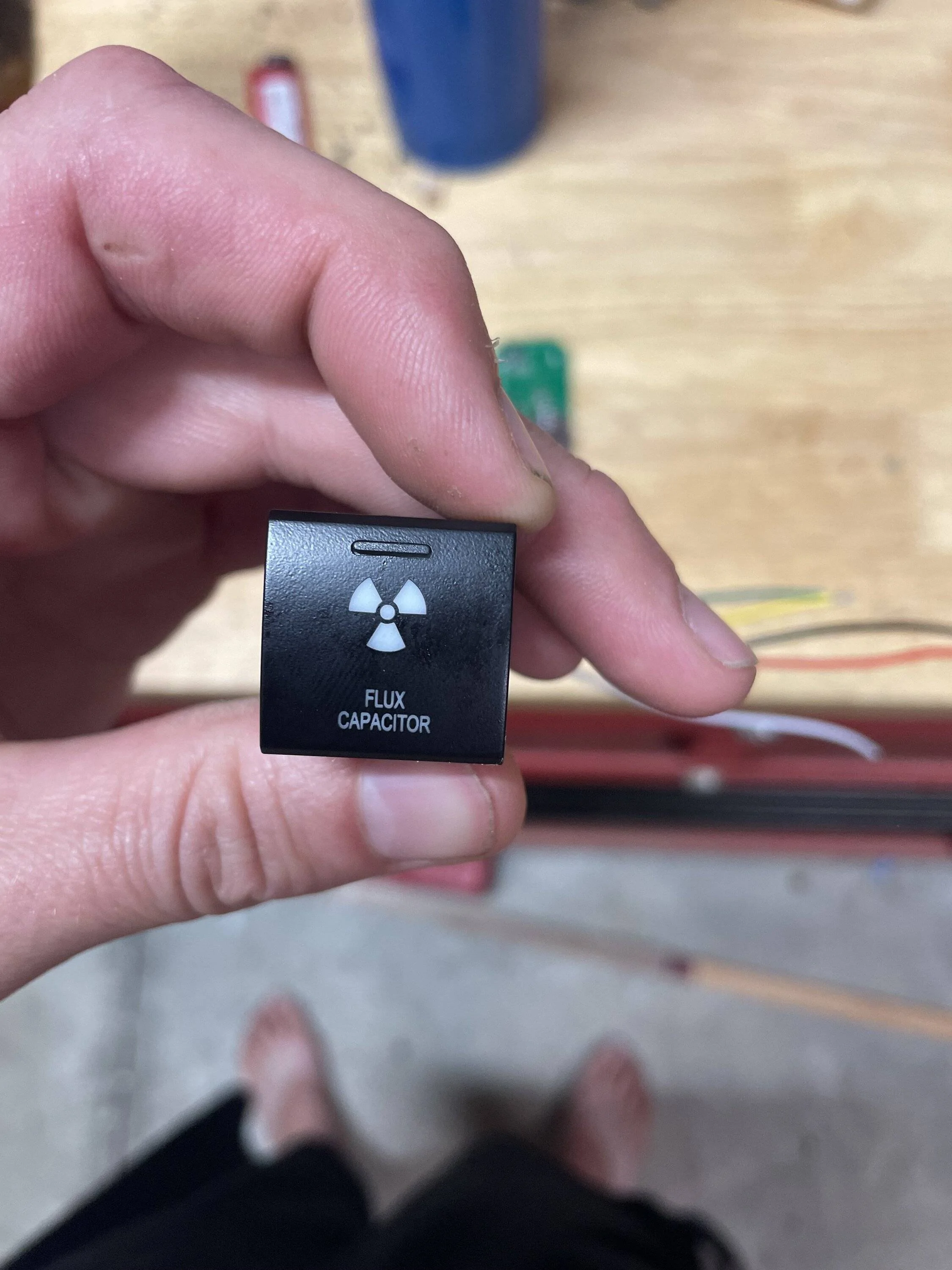

I couldn’t find a momentary “Garage Door” button. So, I order a “Flux Reactor” 20x20 butting from caliraised led. I ordered a two pack of garage door openers from Amazon and opened one up. I’m pretty terrible with electrical so just stripped the wires I needed and touched them to different legs on the switch until the led lit up.
once the rain stops later this week I plan to wire up the switch for the backlight led.
