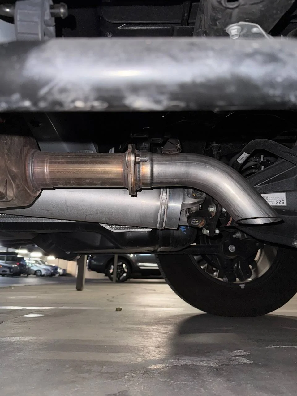

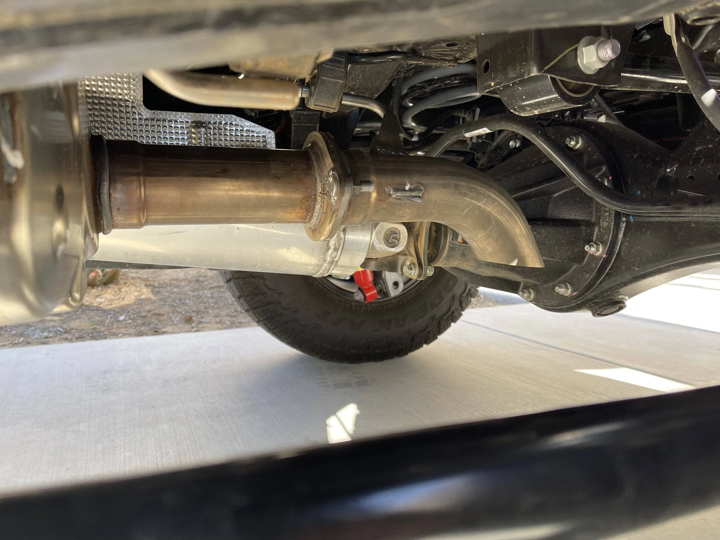

Went to a local shop. He did the cut and re-welded the hanger.
In and out 20 mins later. $40

I don’t have a video but sounds the same.

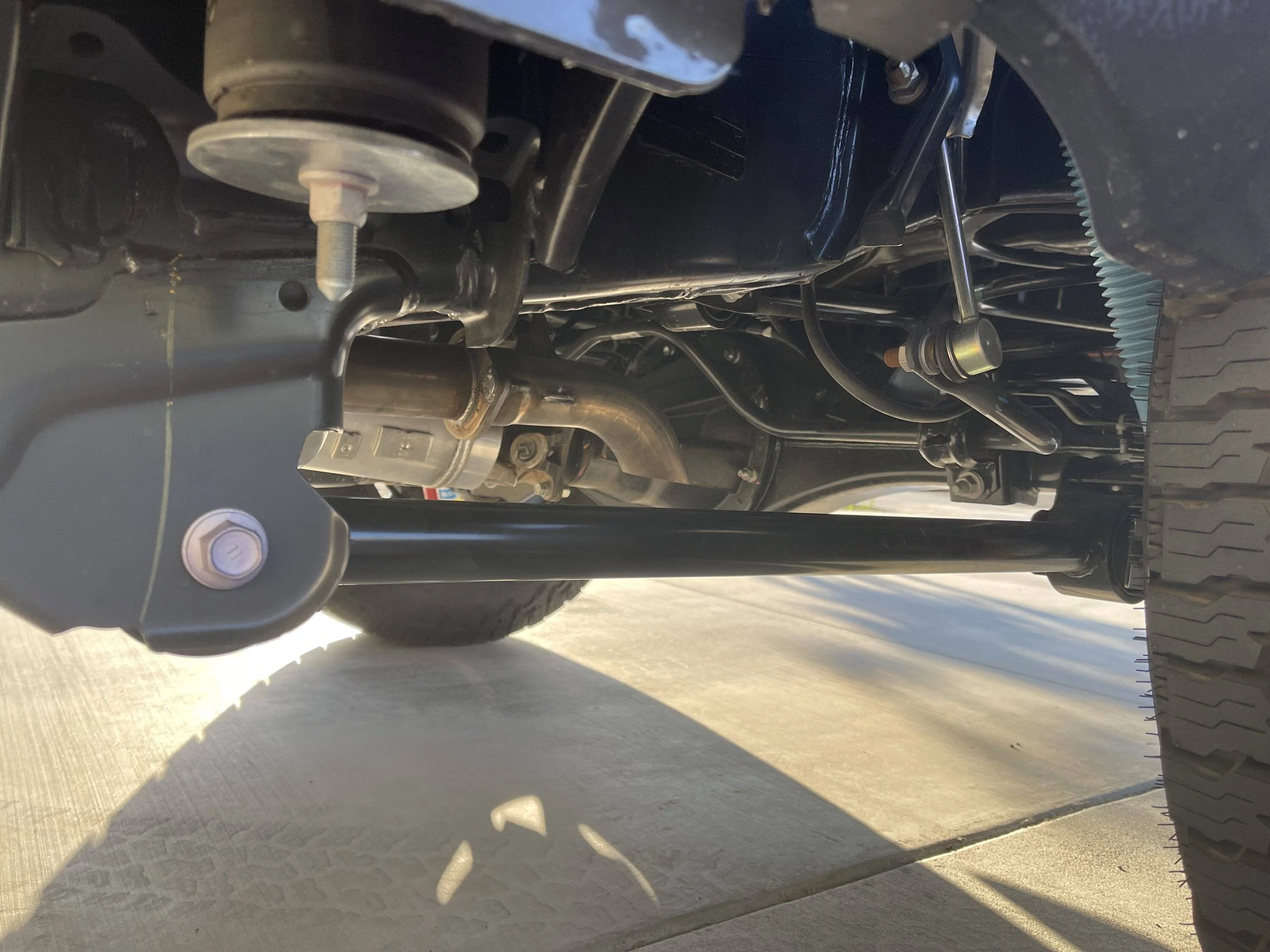

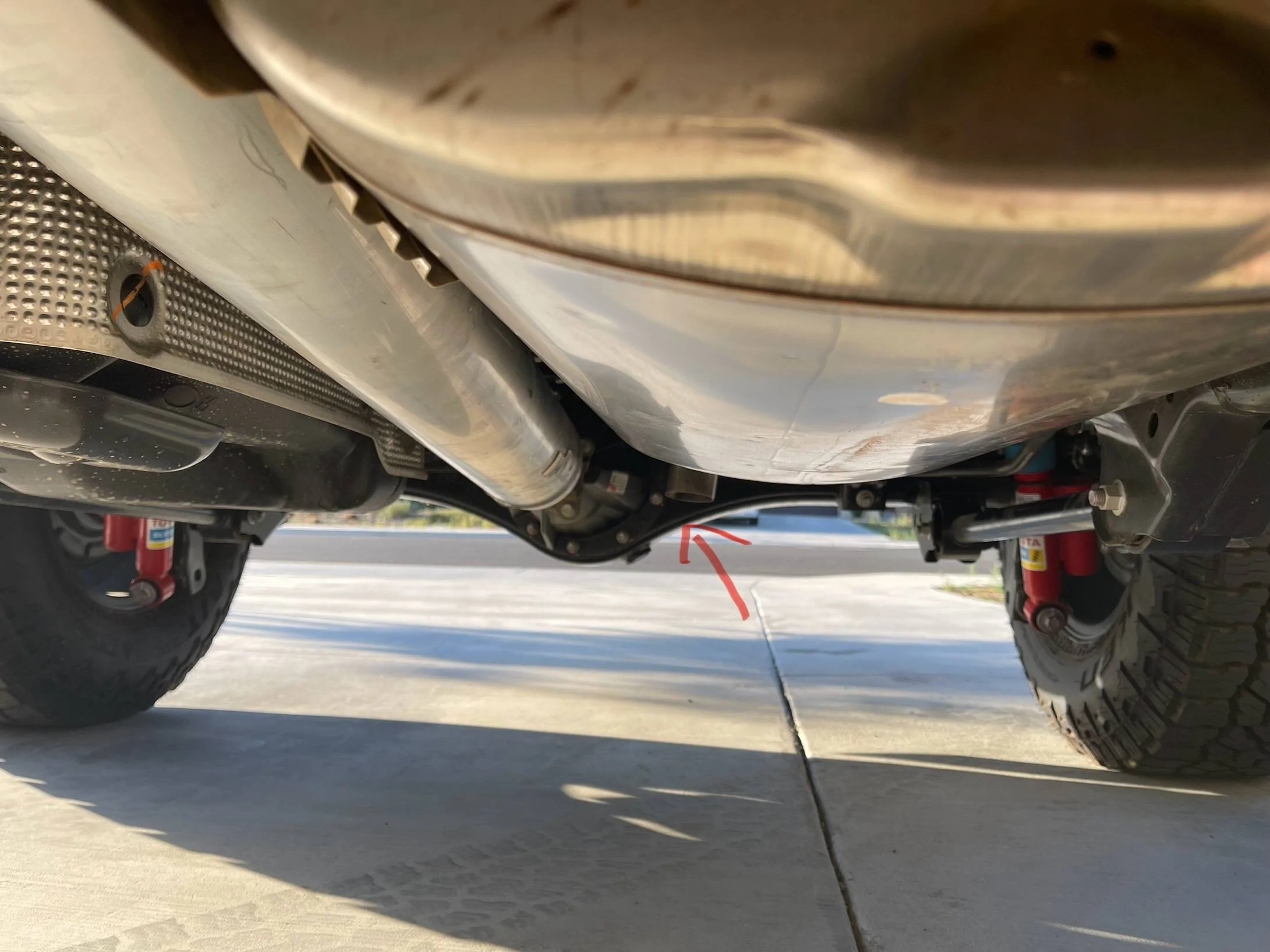

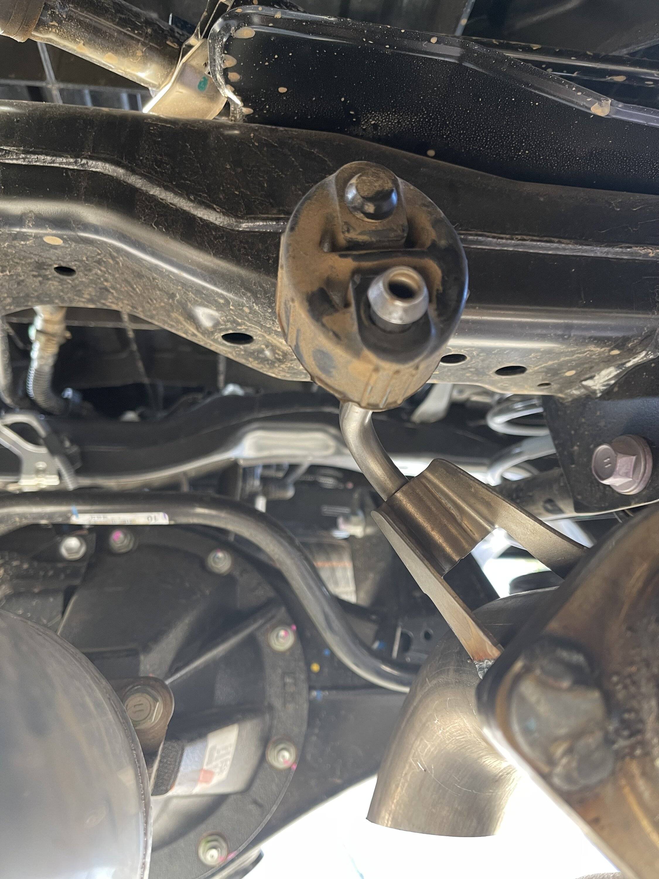

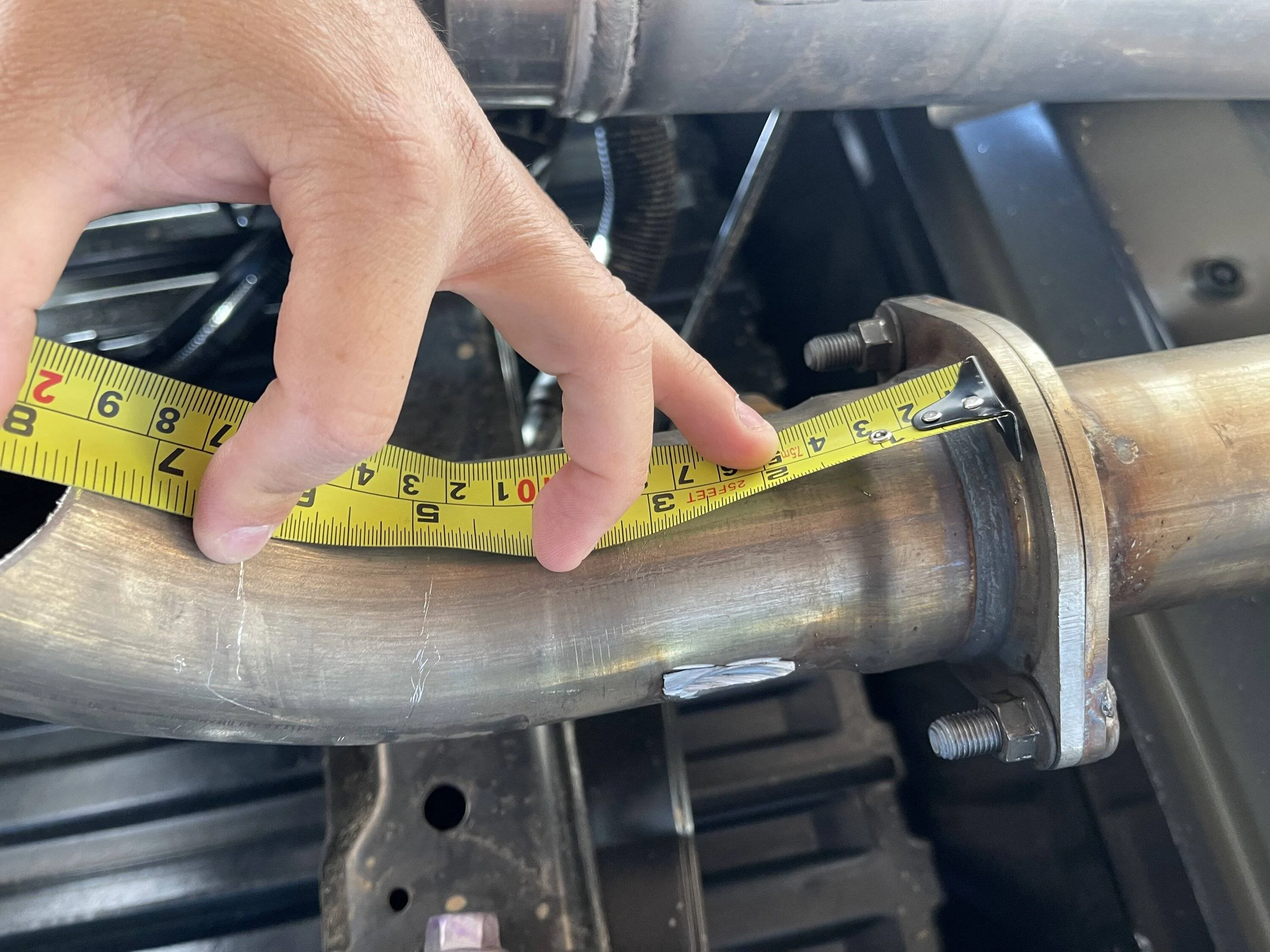

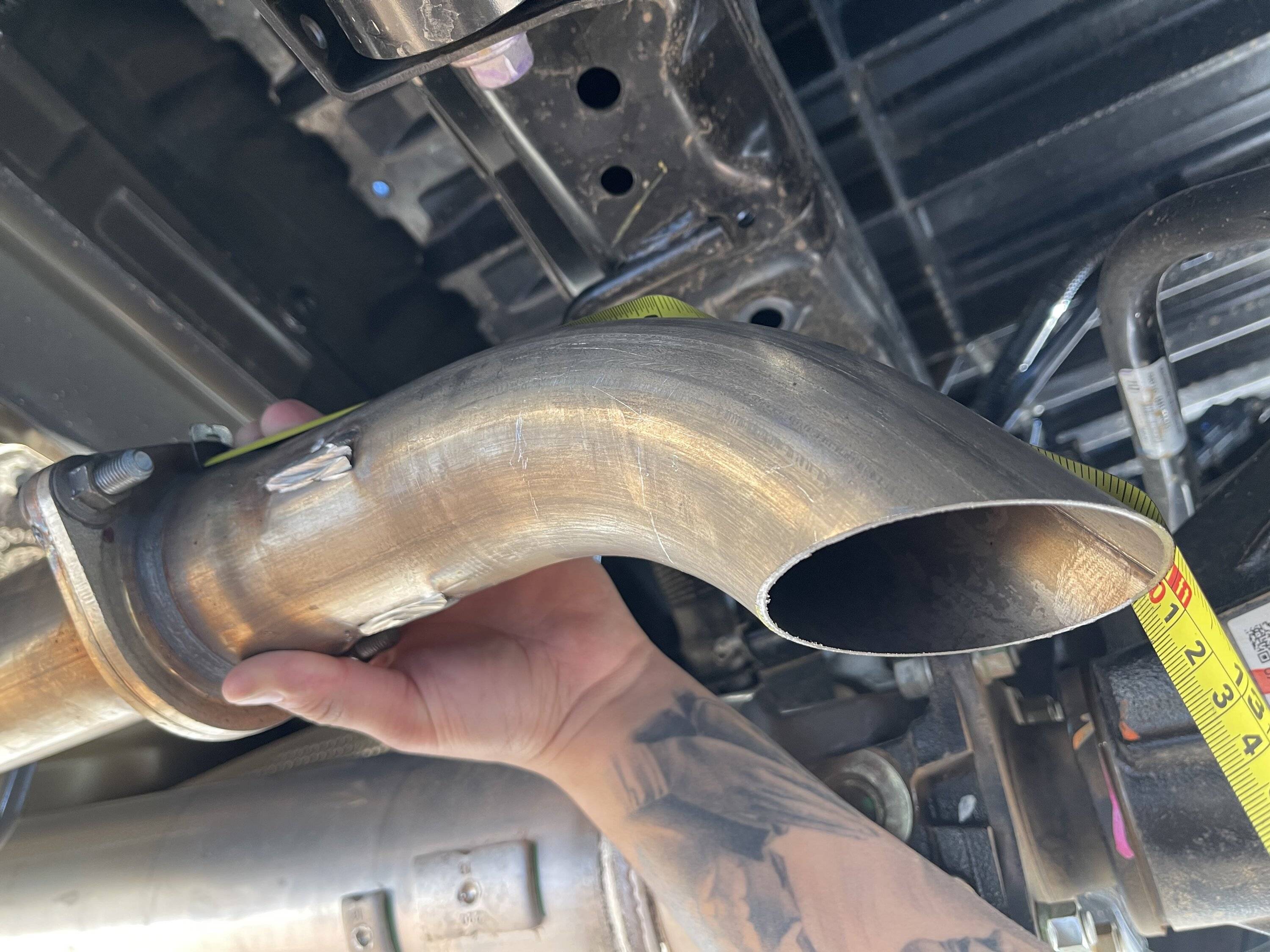

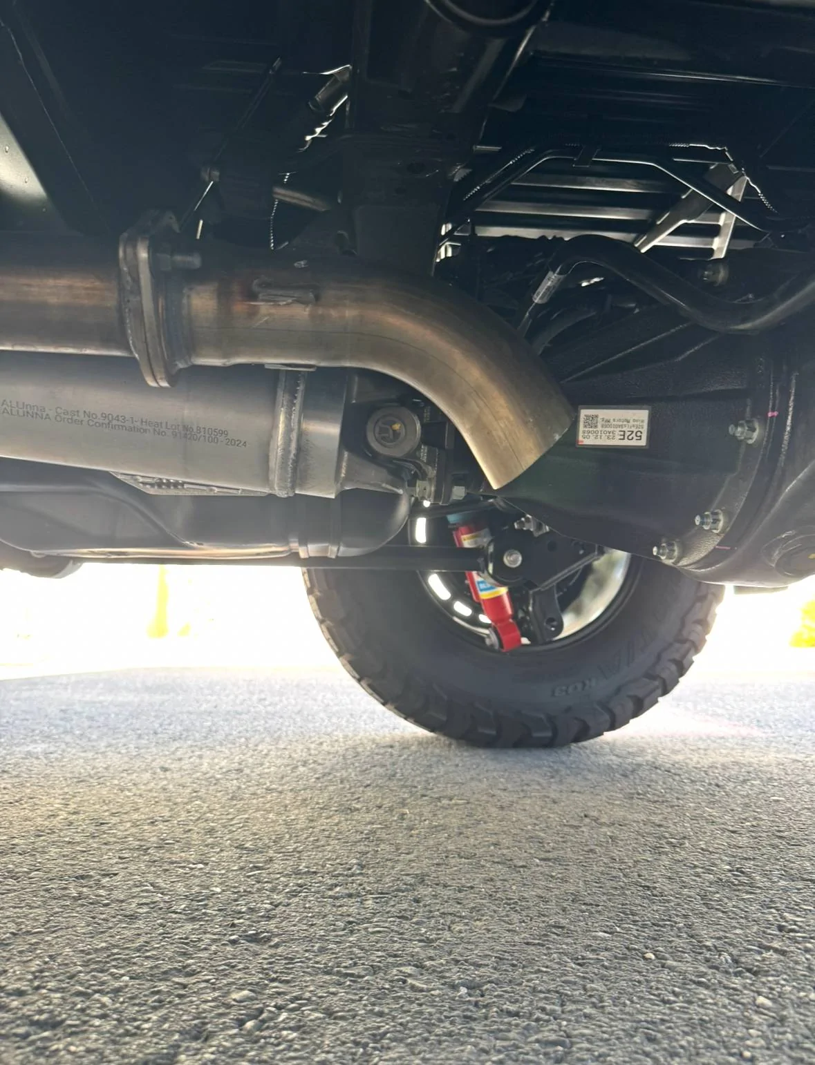

I did the same as Duce95. Went to a local muffler shop and had the original exhaust cut, flipped up side down and re-welded the hanger bracket to accommodate the original rubber hanger. I paid $50, I think it was well worth it.
Cut measurements:
From flange to inner cut is 7.5 inches.
From flange to outer cut is 12 inches.
(I pushed the tape measure against the pipe and followed the tube curve to get accurate readings, this way you’re able to mark with a sharpie and begin cutting.

None what so over. I drove highway and tested idling with windows down and nothing. The only thing I haven’t tested is with the rear sliding window open.
