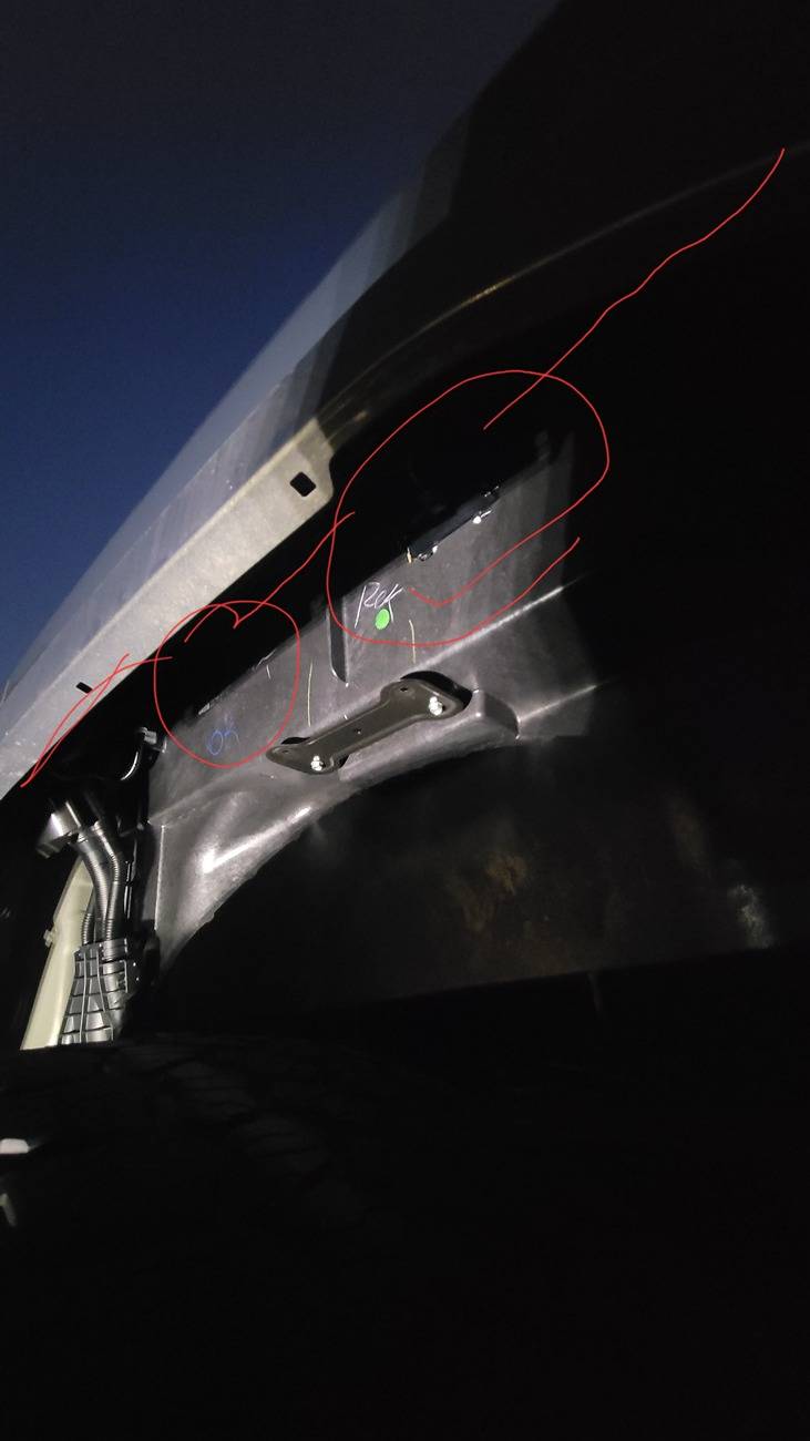

This is the only picture I have unfortunately it does not show the wiring harness ran in between the rear wheel well and the bed of the truck. I drew where I saw the factory wiring harness was ran, the circles are the bed lights you can see a small whip that connects them to the bed rail lights.

Thanks for the pic! I’m hoping to try this either this weekend or the following weekend. I’ve been trying to get my hands on an install doc/PDF from Toyota but so far nothing yet. Would you mind giving your service manager a nudge? I’d appreciate it! All good if not. I’m fairly confident I can figure this out I just want to be as careful as possible.

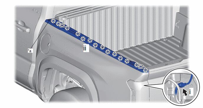

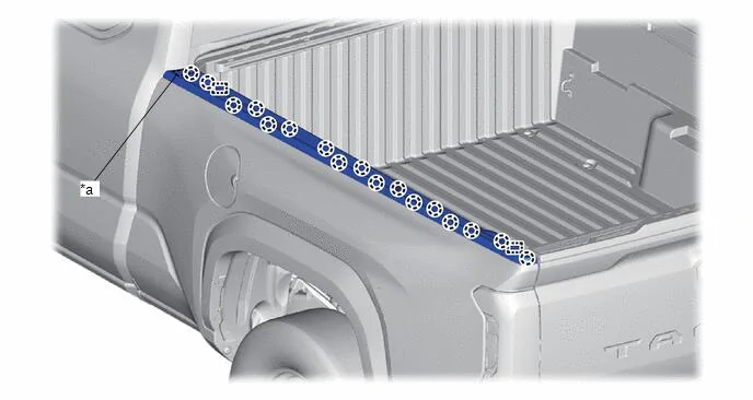

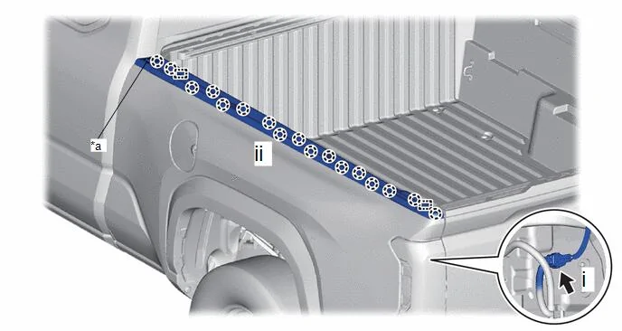

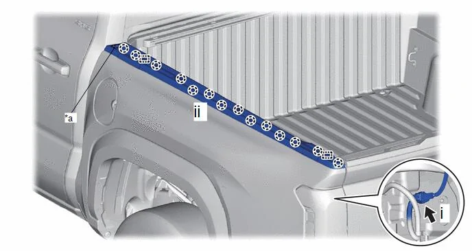

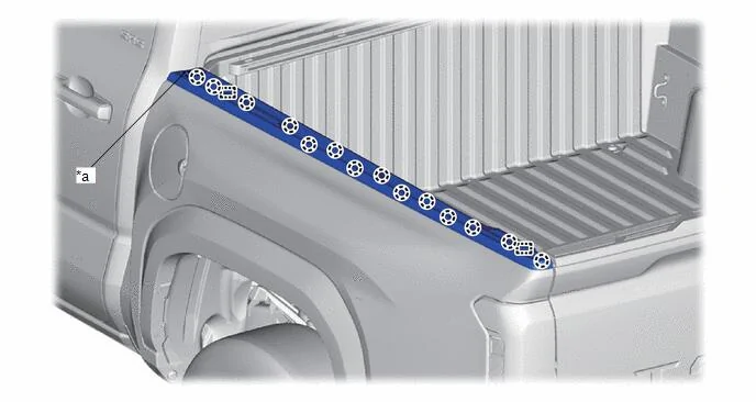

PROCEDURE
1. REMOVE REAR COMBINATION LIGHT ASSEMBLY LH (w/ Outer Bed Light)
Click here
2. REMOVE REAR BODY SIDE PANEL PROTECTOR LH
(a) for Short Deck without Outer Bed Light:
*a​
Double-sided Tape​
(b) for Long Deck without Outer Bed Light:
*a​
Double-sided Tape​
(c) for Short Deck with Outer Bed Light:
*a​
Double-sided Tape​
(1) Disconnect the connector.
(2) Detach the clips and remove the rear body side panel protector LH.
(d) for Long Deck with Outer Bed Light:
*a​
Double-sided Tape​
3. REMOVE LIGHT WIRE (w/ Outer Bed Light)
