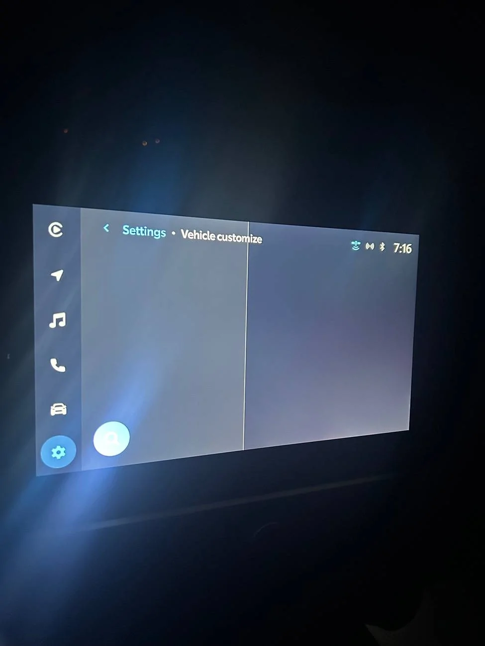

This was great information and when I first received the vehicle I do remember accessing the screen shown and changing door locks . Now this is what I see. I’m assuming it’s because I let my trial Toyota connectivity App laps.
I wonder if the dealer can access and change ACC Customization?
The first couple of weeks I owned my truck back in April.. the screen was blank as well.

Thinking more about this I went back out and started the truck and was able to see all the customization options and turn off AC Customize. Radio stays on and blue tooth available when the engine is shut off!! Thanks guys 😊
I did the same thing. The truck had to be running for me to get the options to show up.

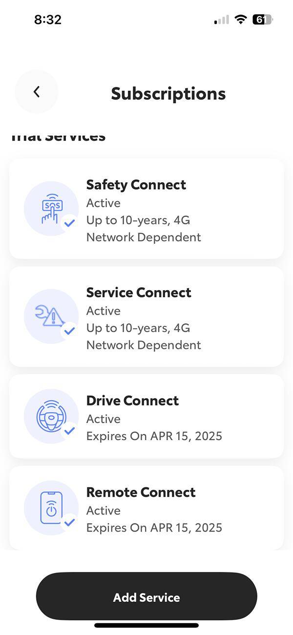

Good deal, glad it wasn’t because your app expired!
I went into the vehicle Toyota APP and looked under “manage subscriptions” and found the connectivity subscription is good for 12 months. That sent me back to try making the change with truck running.
