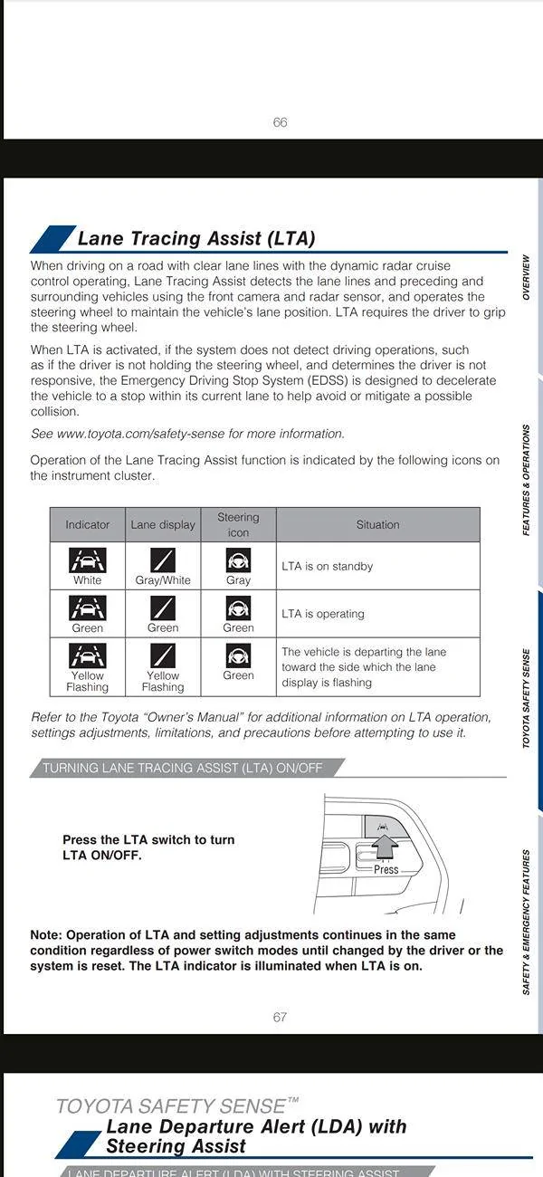

You can press the lane tracing button on the steering wheel. I think long pressing may disable it while in CC but I cannot recall.
Edit: I think I might have misunderstood. There is lane departure and also lane tracing assist. You might be turning off lane departure and not tracing. I believe tracing becomes active whenever you use CC and does not turn off when you exit CC. I think just pressing the tracing button will disable it still.

Haha, last sentence in the first paragraph "LTA requires driver to grip the steering wheel". No shit! First time the truck yanks the wheel is a shocker.
