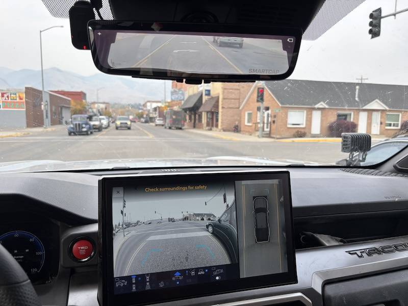

The two camera setup that is with the upper brake light on in the cab has one camera that looks at the bed and one camera that serves the digital rearview
Separate from the camera in the tailgate handle that is specifically aimed down at the hitch connection point & "backup".
360 has 5 camera locations in total with I believe 6 actual cameras:
1. Front center grille
2. Left side mirror - forward looking / rearward looking
3. Right side mirror - forward looking / rearward looking
4. Rear cab - rear view
5. Rear cab - bed view
6. Tailgate - hitch view
(MDM underside view is a ~10ft delayed display of front camera)
