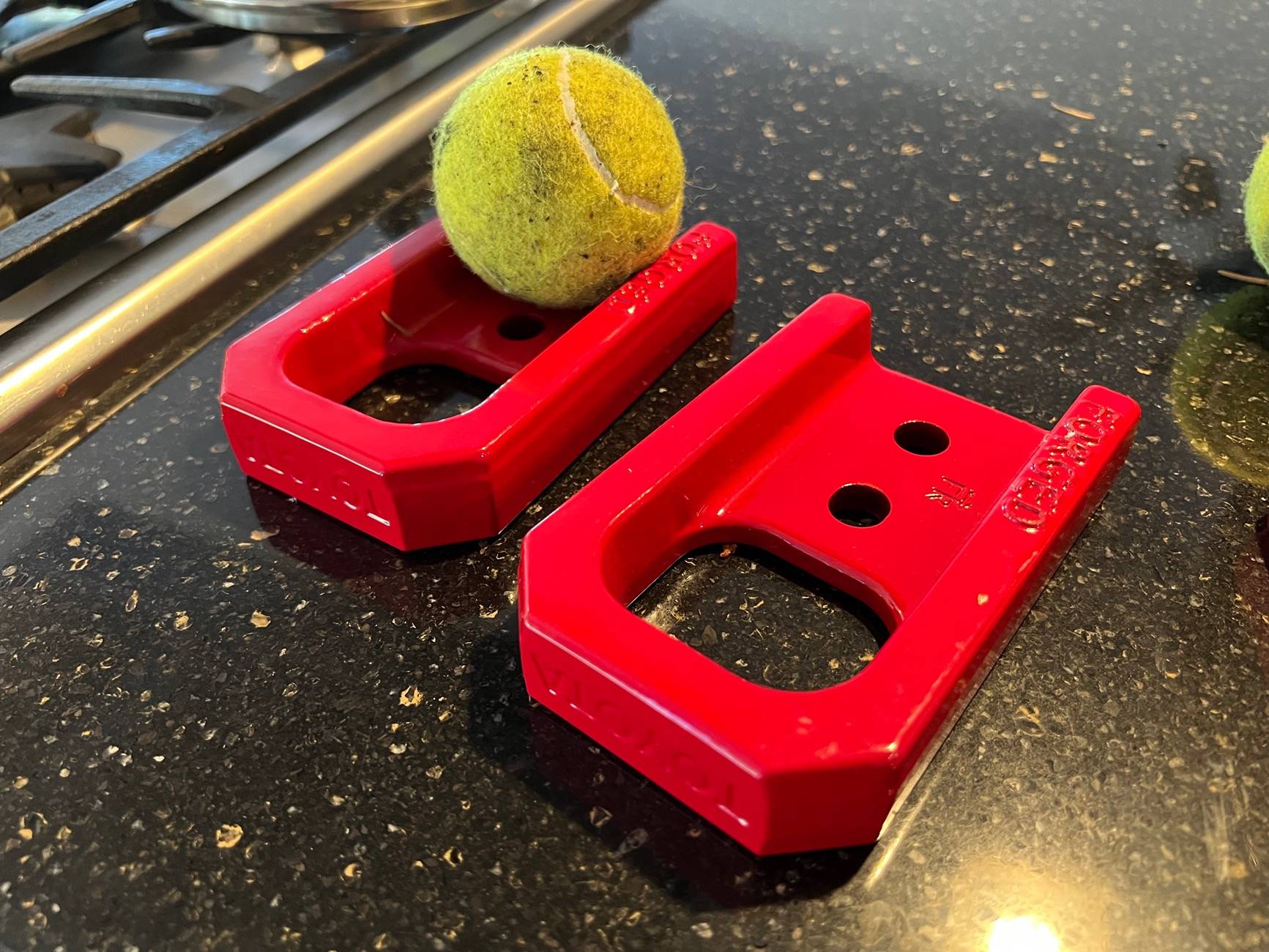

Are the genuine Toyota front tow hooks rated for higher load limits than the stock 2024 tow hooks that come on the truck? My understanding is the stock tow hooks on the Tacoma are not rated for recovery.
Below is the part description directly from the Toyota site:
PT974-35250
Front Tow Hooks are engineered to help elevate your off-road experience with vehicle recovery. • Tailored with a vehicle-specific design, ensuring seamless integration with your vehicle's frame and preserving structural integrity • Vibrant red finish adds a touch of style and enhances visibility for increased safety during recovery operations • Helps prevent vehicle damage with secure attachment points for recovery straps
Makes me think they are appropriate for recovery. Note: the price is also $160 .... LOL

The price is for a pair, reusing transport bolts for attachment. 19mm bolt heads. Pretty damn cheap, even before online discounts, for what you're expecting it to hold up to.

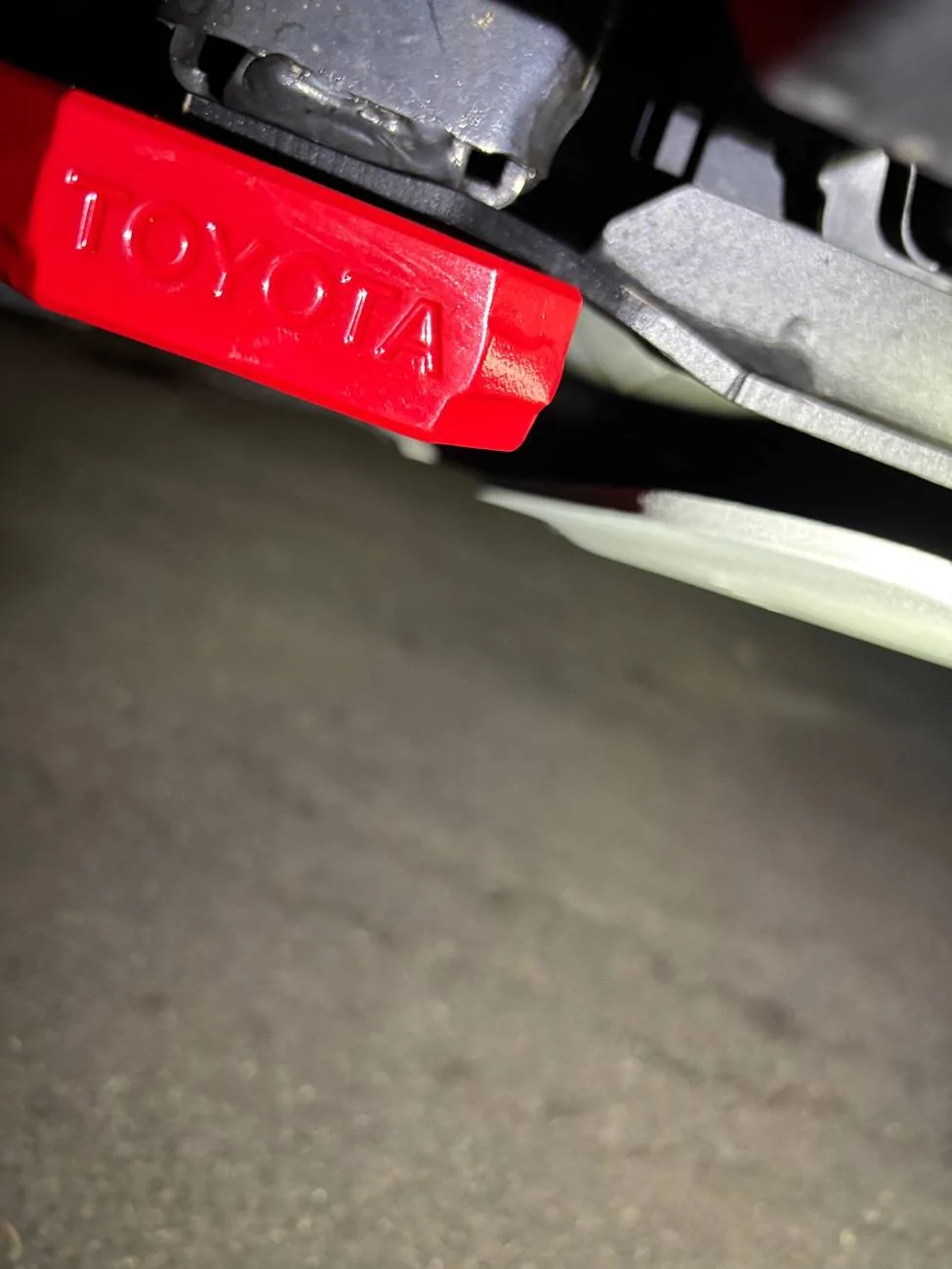

I posted a picture of them on my truck in post #29, and there are others on the second tab of this thread as well.

I have a 2024 Sport and I added a RCI crossmember so that I could add a OEM skid plate. The OEM red tow hook hits part of the crossmember and I had to crank down the bolts to get it to sit flush. I think I was at about 70ft lbs. it looks straight and flush. Has anyone encountered this issue?
