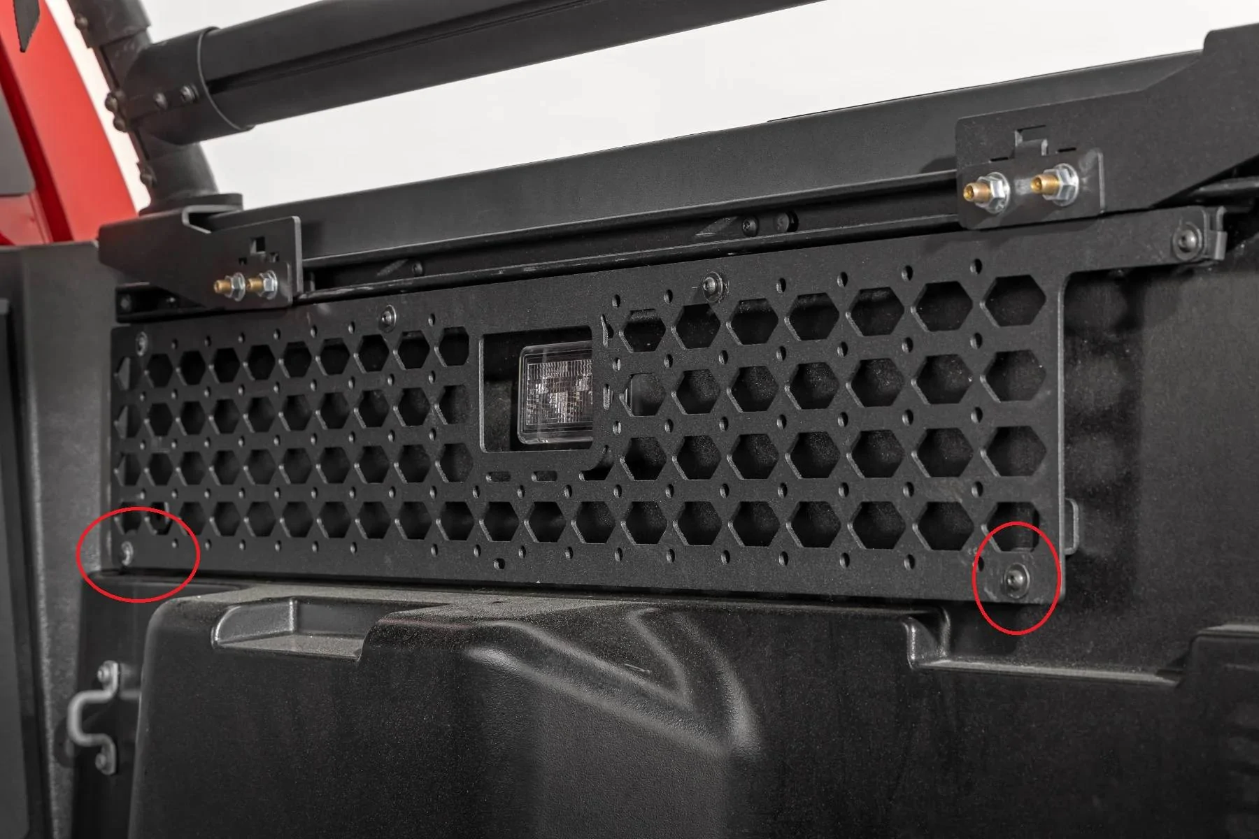

Thanks for clearing this up. I couldn't find install directions for the RC so I went with what I could see in their pictures. So, tell me, what are these two screws going to?
That's the passenger side panel and yes it requires drilling. The cab panel is at the front of the bed up near the cab of the truck.

The bolt to some "z" mounts and those bolt to holes drilled in the bed.

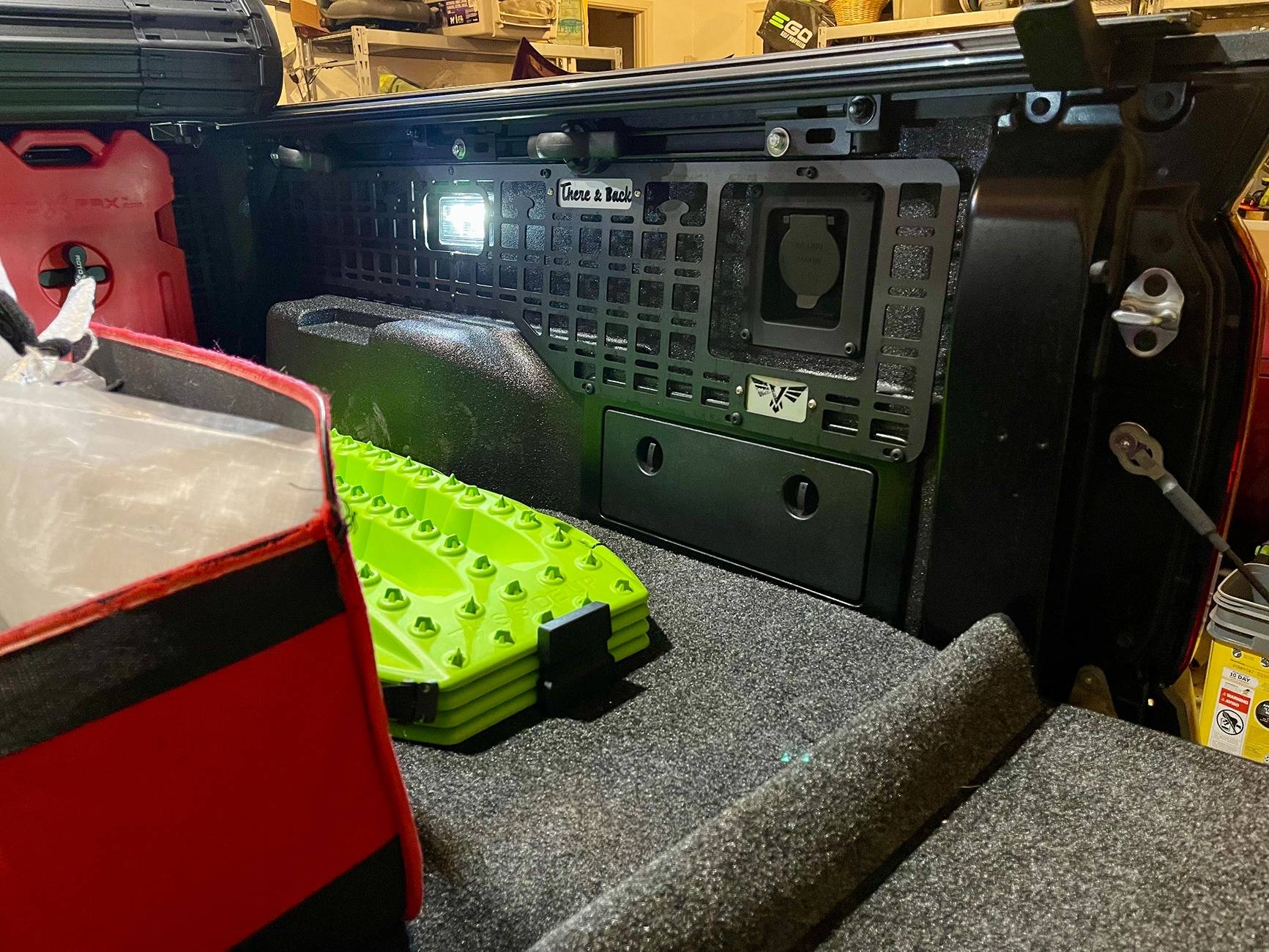

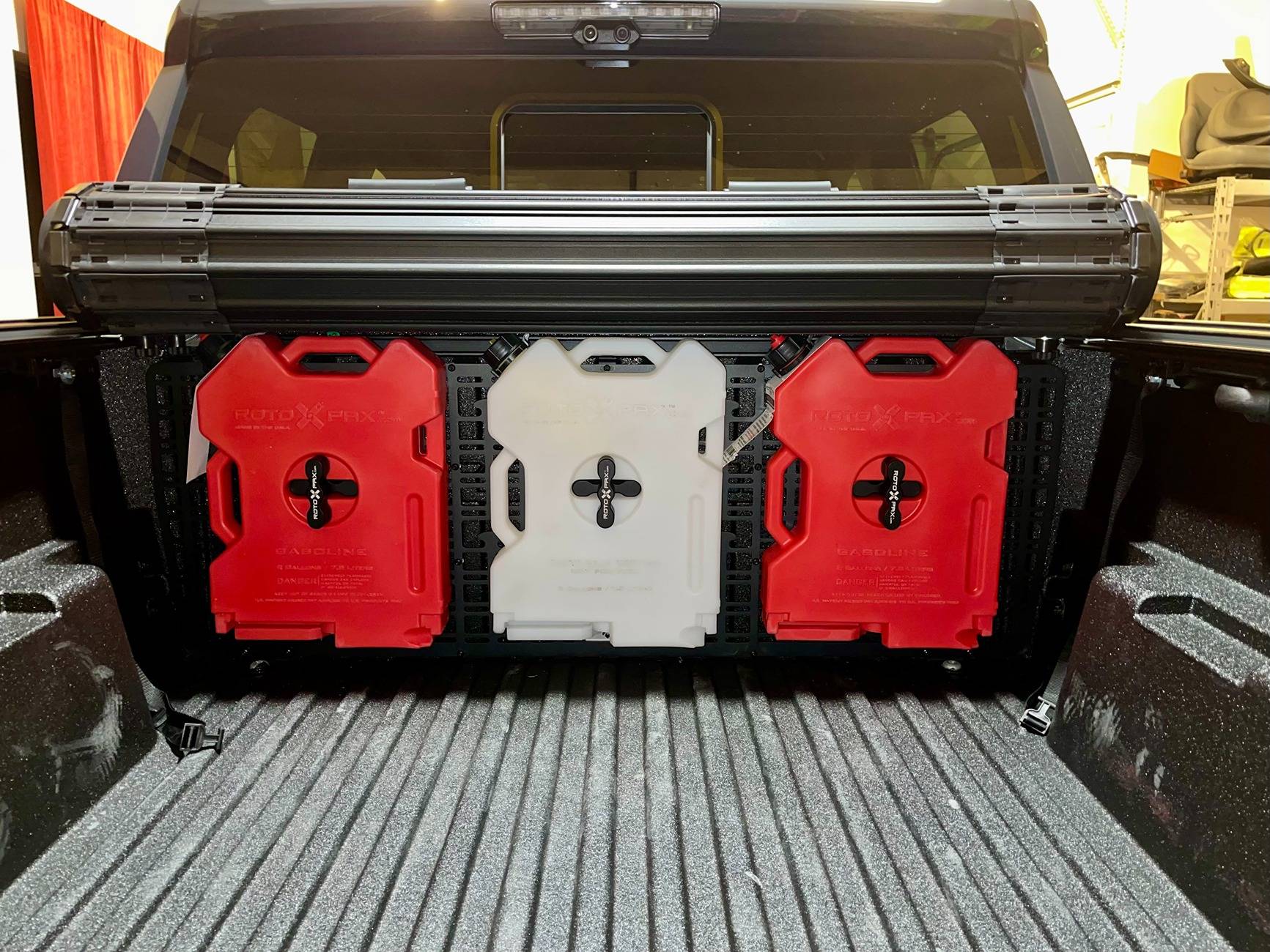

I really like my Victory 4x4 molle panels. I have the back and one side. The passenger side doesn't need drilling, so that's the one side I installed. I also have the Victory 4x4 front skid plate, and I'm eagerly waiting for their winch bumper.

Do you have to remove the bed rail to install it? I ask because mine is in there under my Diamondback already and trying to find a solution that does not require me to pull stuff back apart

You don't technically have to remove the whole rail, but you'll need to loosen the bolts and slide our MOLLE panel brackets underneath.

My cover was already installed, all I had to do was just as Victory 4x4 just said, loosen the bolts and slide the MOLLE panel brackets underneath. There was a tonneau cover bracket in the way of one bolt for me, but considering the bracket could have been installed anywhere along the rail, it was just bad juju on my part that one tonneau cover bracket was in the way. Otherwise it was a very easy install.
