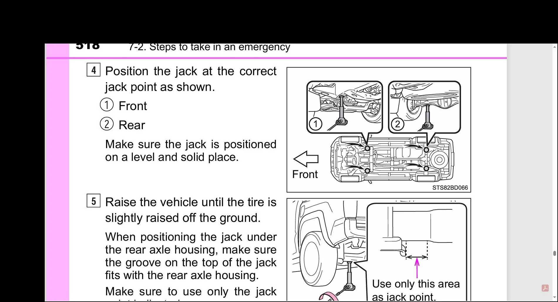

I just looked. Unfortunately, it doesn't contain information on front and rear jack points. It only points out to the jack points at the corners. I'm looking for front and rear jack points to make it easier when changing out wheel sets.
Page 590 of the OM is one of the places that shows the jacking points for doing things like changing tires.
j.

This is from the owners manual page 518.
2024 Tacoma Jack points Tacoma jack pointss
