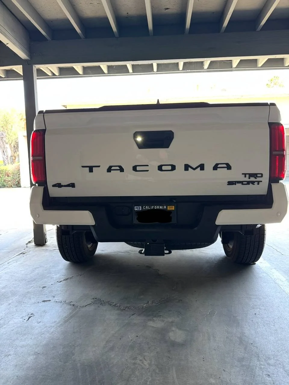

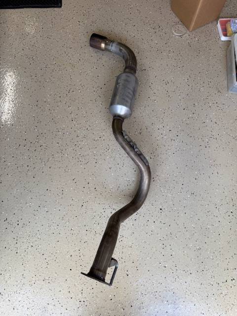

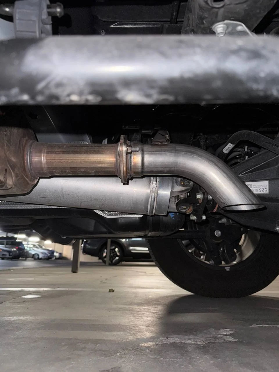

Picked this up from the dealer. Simple enough to take off the existing axle back exhaust (see pictures). If you plan on getting this here is what I recommend:
Unbolt it first. Take it off from the rubber exhaust pipe support. It’s held up in two areas. One from the exhaust tip and the other near where it’s bolted onto the center exhaust.
You’ll then wanna jack the truck up to create room from the body of the truck and rear differential in order to twist the pipe up and out.

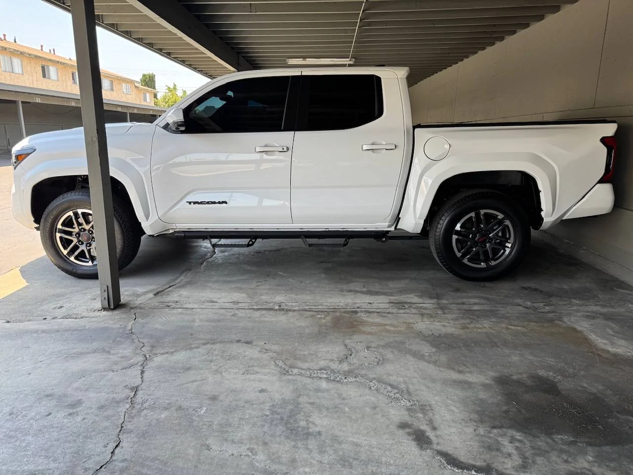

Edit: Adding photos of what the truck looks like without the tail pipe. I’m loving it.
Update: I know some were asking about fumes and leakage but so far I haven’t had an issue with either. Also, someone asked me on another group about CEL coming on and no it doesn’t.
