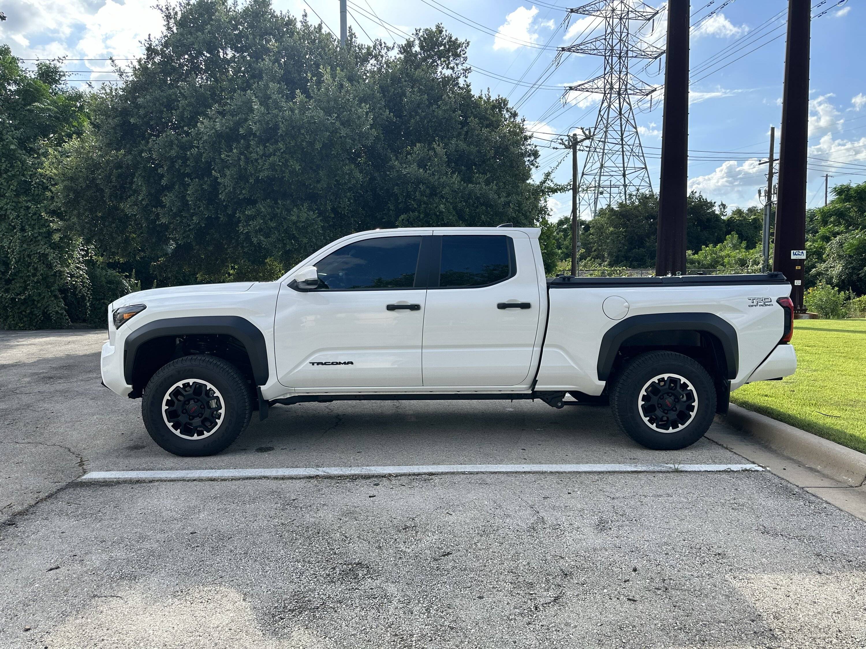

Pretty happy with the 2 piece collar lift/level so far. Shop that did the install had no concerns with the threads. Alignment is normal without any issue. Provides a good lift in the front to level out the rake (especially evident on long beds) and drives like stock.
Any rear lift here? Or is that just the 2.25” front lift?
Is this perfectly level measurement wise? I am looking at this kit but am concerned the 2.25” would make the truck look squatted with a short bed. Thanks!
I haven't measured it, I can try when I get the chance, but it appears pretty level. There are alot of guys running this on the regular short bed and nobody has complaint.
Our kit has .25" of rake in the back still. If we go any higher, the shocks seem to be out of their functional operating zone

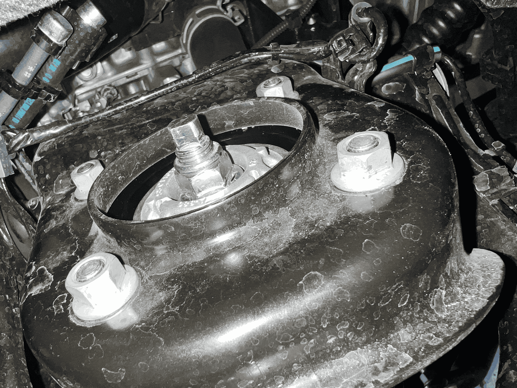

Also, we have been getting a lot of emails from concerned citizens over the thread engagement, and we have more updates.
We decided that the factory nuts were still the best option because they are fully threaded. As you can see in the photo, the nuts are fully seated, fully threaded, torqued to spec and have minor stud intrusion still.
For some reason there's a belief that you have to have the stud sticking out past the nuts and that's simply not true.
2024 Tacoma Peak Suspension 2 Piece Trail Lift Kit installed on 2024 Tacoma Build (Supersonic Red) TacomaTopNuts
