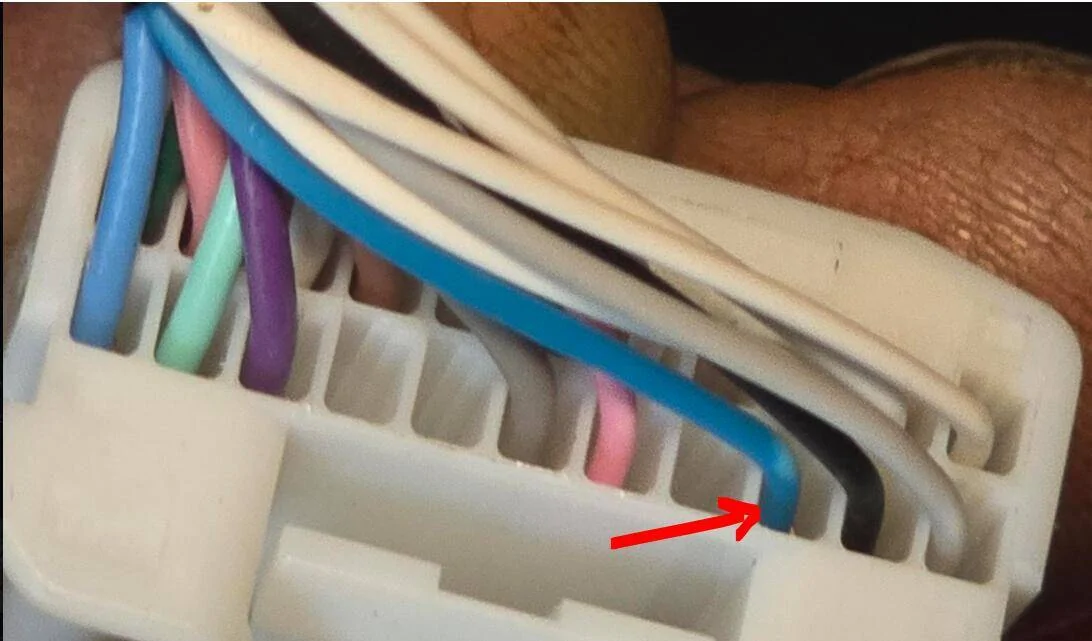

Here is a picture of the plug that needs to be tapped. One can see that there are several white wires. I was trying not to have to tap each wire separately to see if that was the correct one.

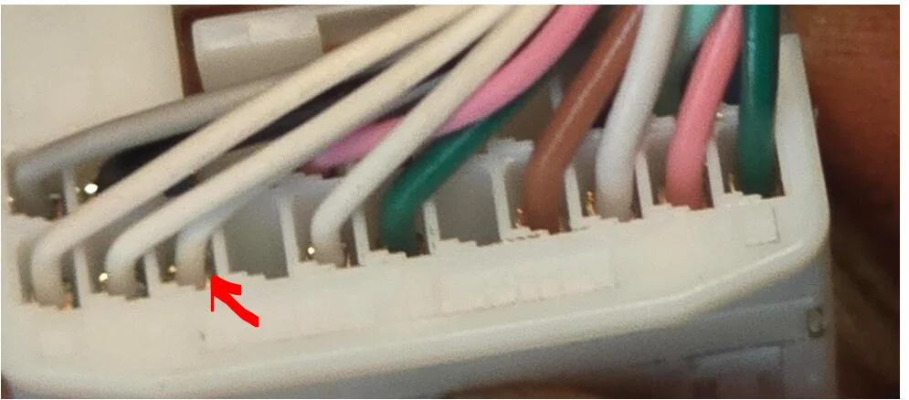

So, I was able to work out the wiring issue.

For anyone else doing the install I have attached a picture of the correct wiring. Also, be aware that the motors will run backward out of the box and you will need to reverse the two wires going into the plug to get the correct orientation. Hard to say if they will correct this issue.
I hope this helps others taking on this project.
