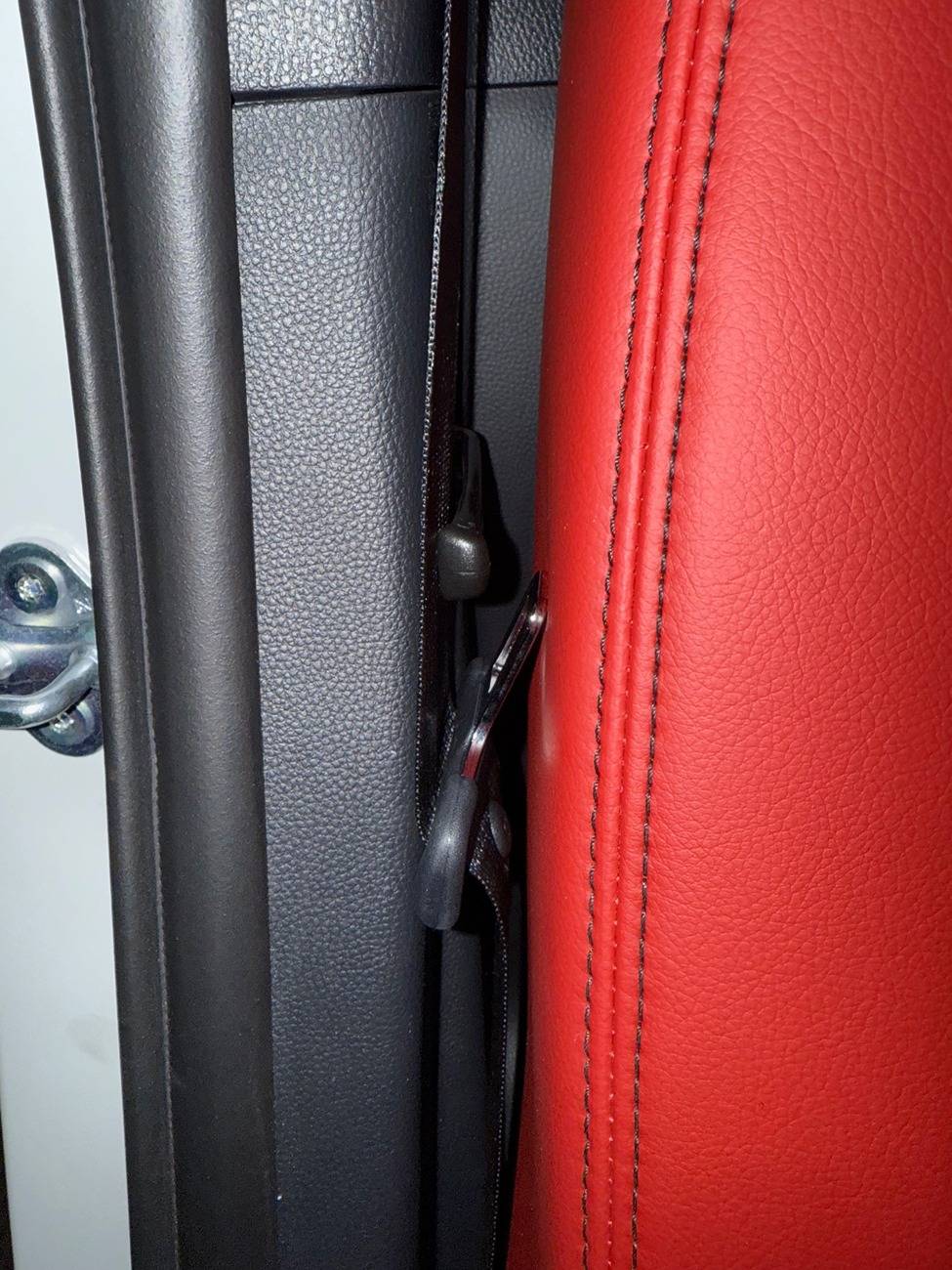

- EDIT: I didn't read the whole thread and I'm finding out this isn't the fix for your particular issue, but I'm sure would help others. -
This rattle bothered me a lot. I fixed it by tucking the seatbelts on either side into seatbelt clip mounted to the b-pillar and then angling the metal buckle upward. No more annoying rattle. See pic:
