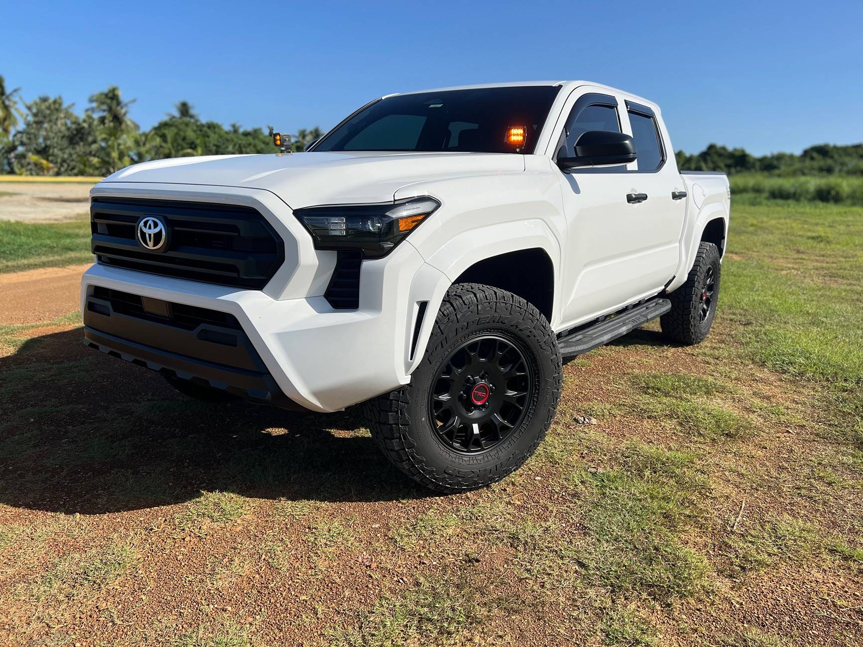

Hi there.
New to the group and to tacoma but not
New to toyota have Corollas and 4Runner.
I bought my 1st Tacoma an SR Trim. Trying to get a front skid plate but without any luck.
Have seen the TRD but when I ask if it will fit my SR they ask me for the VIN and comes out as it will not fit and Toyota doesn’t make one for the SR.
Did theres an aftermarket one that will fit the SR?
