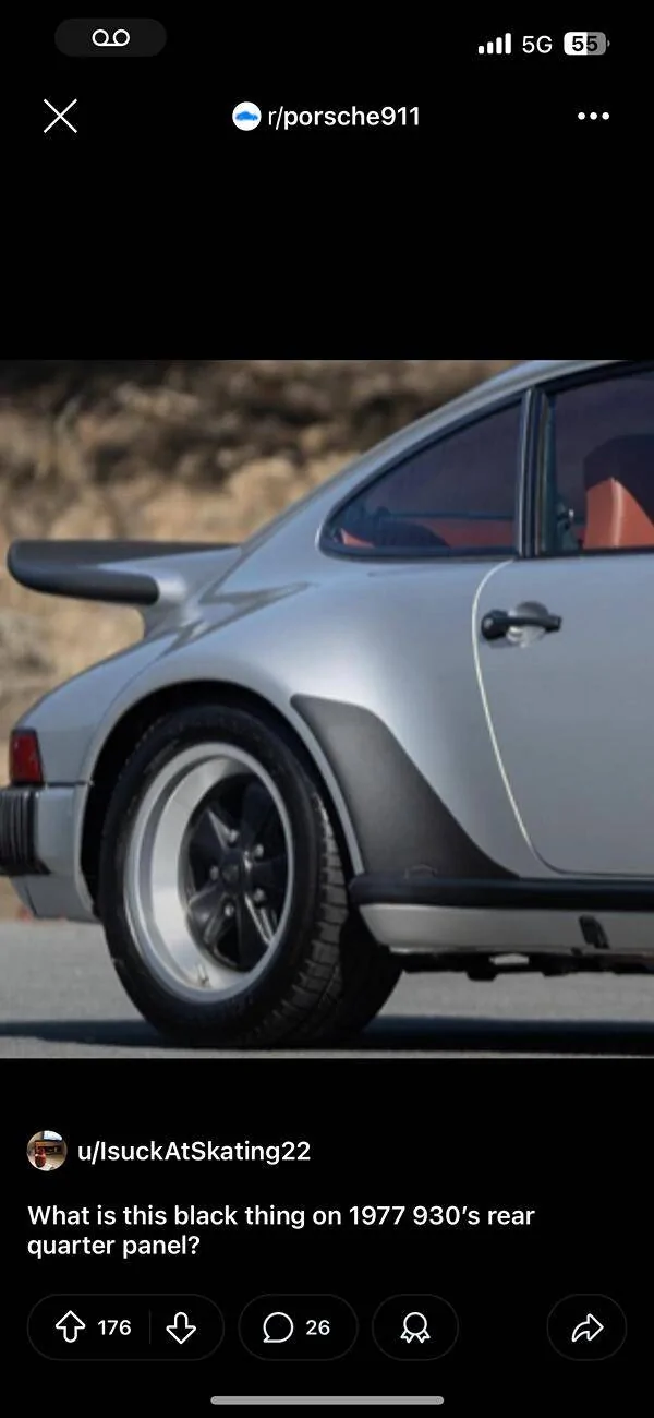

This ain’t just a Tacoma problem …
Yep. I have a 2019 991.2 GTS. It has factory ppf, but I added some magnetic black carbon fiber looking protection over the top of that. Too bad some of the taco area taking the beating is plastic because a similar magnetic solution would have been cool.

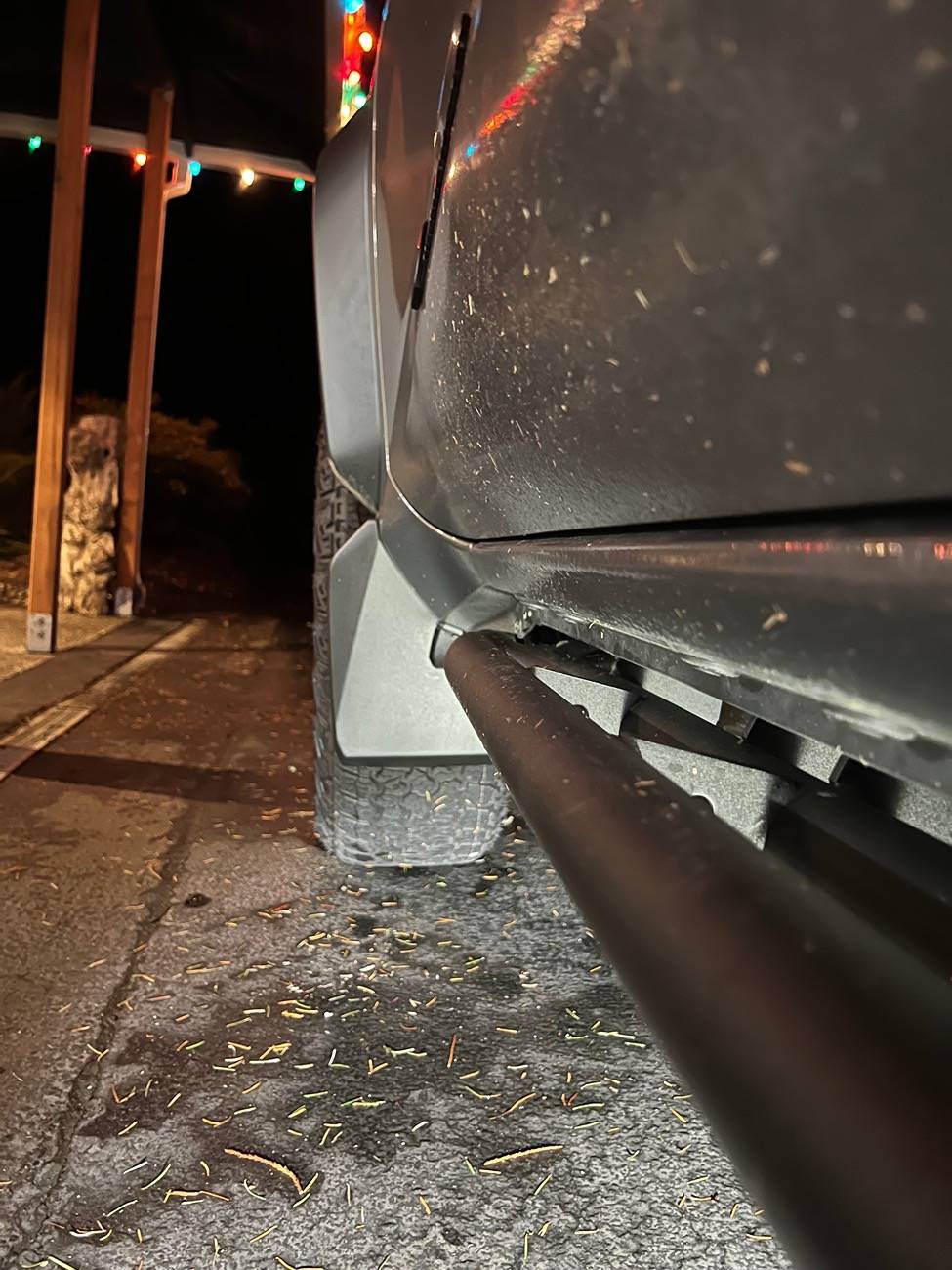

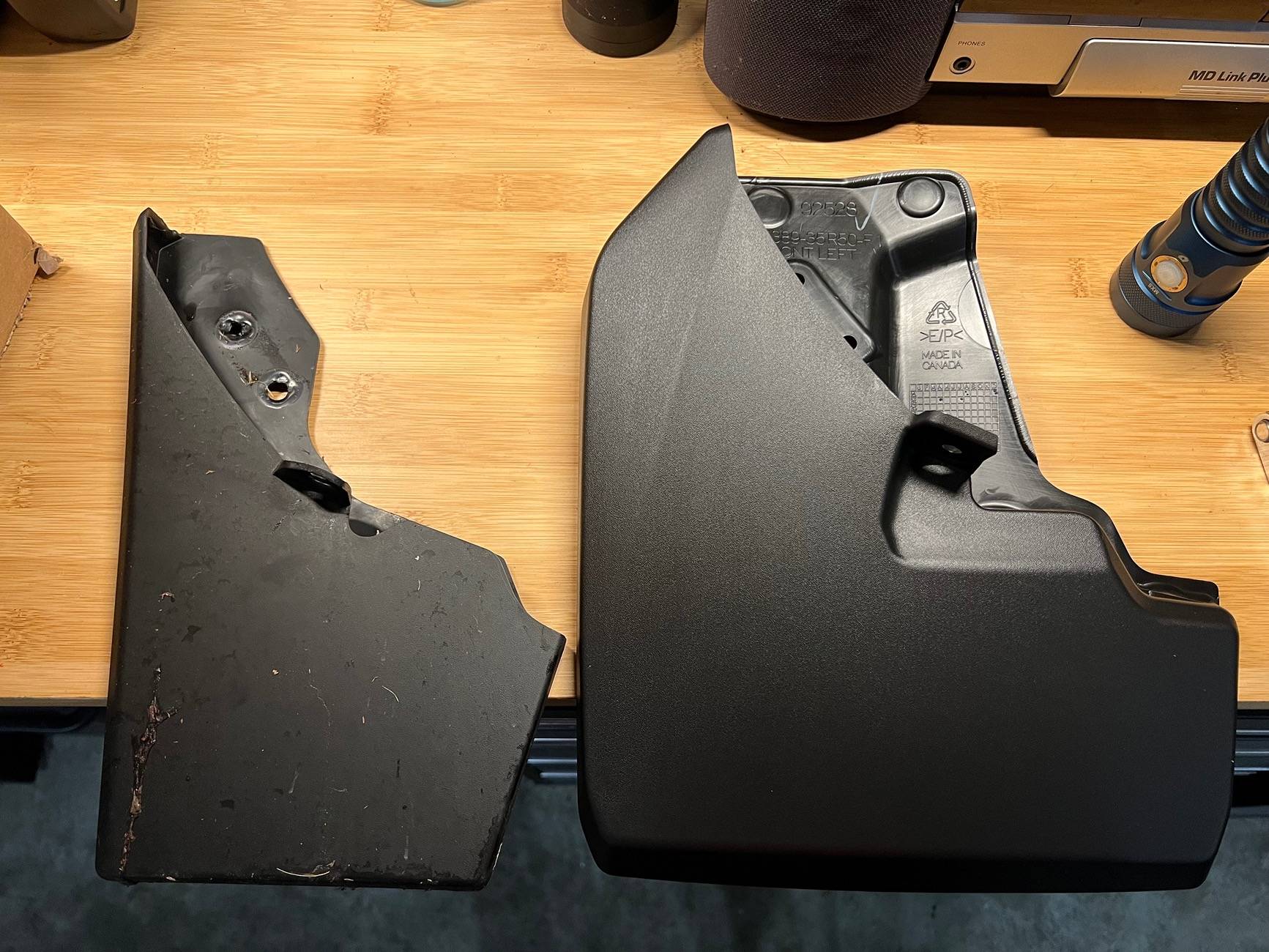

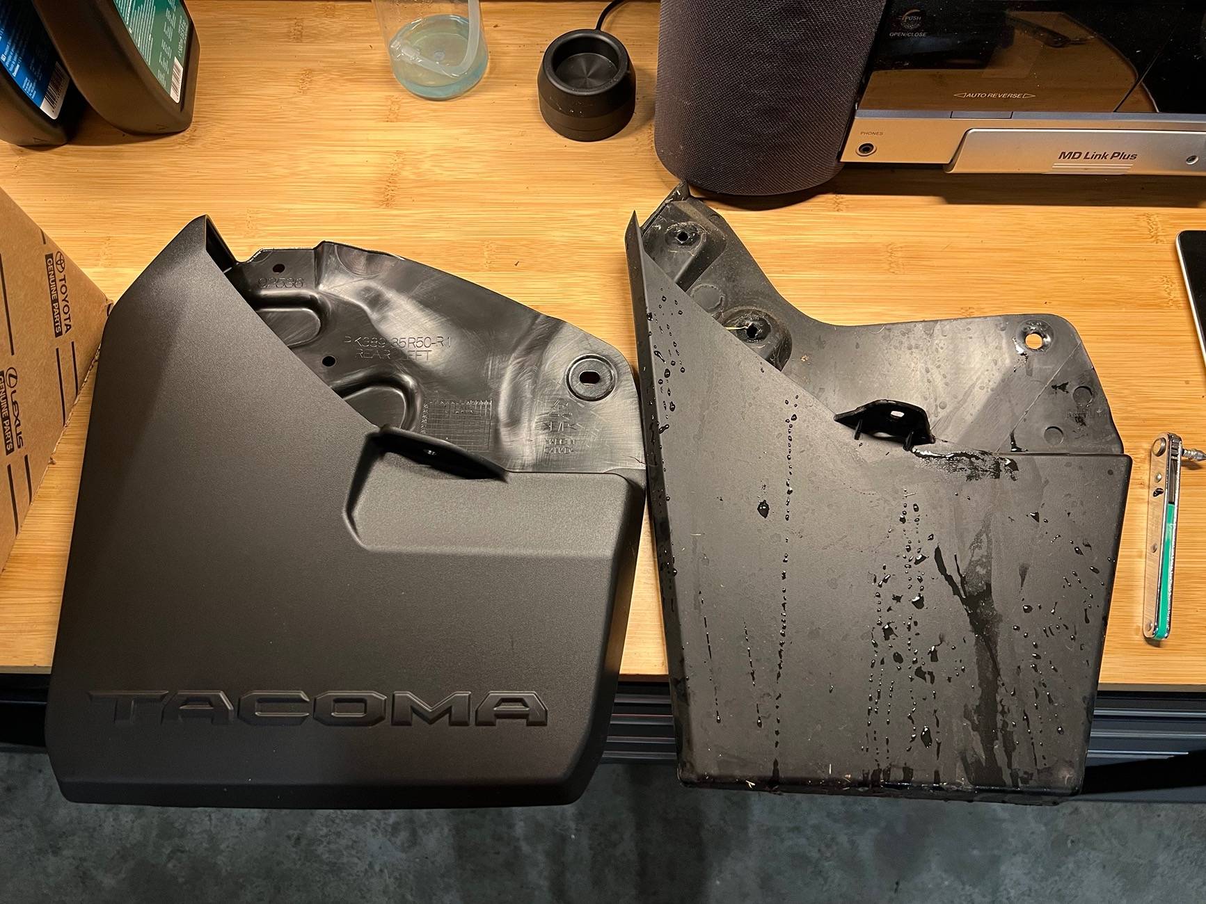

New mudflaps on without incident. Much better than stock lol. Came with screws I didn’t need, just reused the hardware from the original mudflaps.

Yup. Looks exactly like mine. Notice how the flap edge comes out parallel to the outside edge of the flare? That’s the way it ought to be.
These are the flaps with the part number that ends in R50. They are wider than the set that has the PN that ends in R00.
I hope they help you out man.

Thanks @Franko Manini for pulling and getting part numbers! PK389-35R50-P1 fit my TH well, extending out as far as the fender flares.
