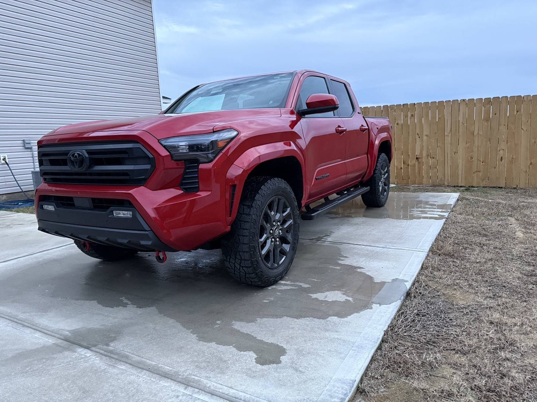

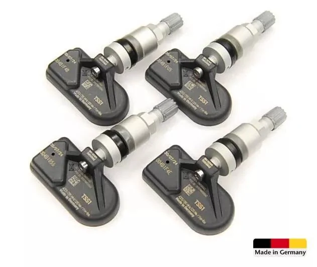

I put 20" Tundra Wheels on mine, I bought 4 new TPMS from eBay(tpmsdeals) $89 set already programed. stopped at a Walmart parking lot and read the manual and before I got home they were reading properly
