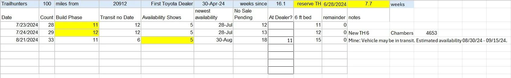

I updated my little survey of the inventory:
2024 Tacoma Trailhunter QC Holds — multiple regions Trailhunters 8-21-2024
